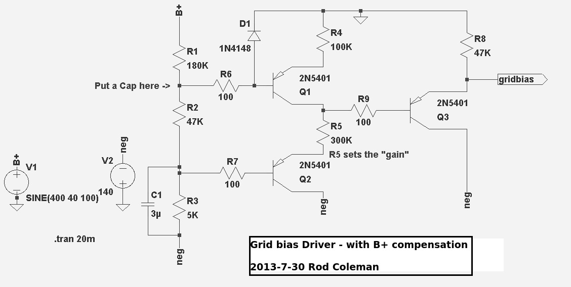

I did a quick simulation of varying the mains on the fixed bias raw input by +/- 10%. You get the same -/+ 10% output variation. Given that is an inverted supply it actually works fine as when the HT goes up +10% you get counter effect as the bias supply goes down. Problem is in practice that both raw supplies wont vary in the same way so you need one referenced to the other as Rod suggested...
If B+ is regulated and drivertube is it coupled to the powertube..
Suggestions for a regulated bias supply ? (70-85v )
Please excuse me if offtopic, maybe biassupplies deserve their own tread ?
The discussion about bias supplies is very interesting - let's keep it going! It would be nice to have some working schematics.
O, alright then!
Here is an example to show the B+ compensated grid bias driver.
I have omitted the filtering so that you can see the grid bias (magnitude) increase as the B+ increases (if you use the LTSPICE file).
How work?
B+ is 400V dc (in the SPICE file, it has a 40V sine imposed on it).
The voltage source "neg" is a loosely regulated -130 to -150V, derived from gas tubes, zener strings etc.
the voltage between R1 and R2 is set by the resistors to be -10 to -20V. In practice, this will be heavily filtered (eg MOSFET cap multiplier).
Q1 is a dc amplifier that multiplies the -10V up to (eg) -70V for your 300B. The useful thing about this is that R5 can be changed to vary the "gain" - ie how much the grid bias changes when the B+ drops by 10%.
Q2 filters the supply for the Q1 stage, and helps keep noise from the Neg supply out of the bias.
Q3 is a follower to present low dynamic impedance to the grid (strongly rejects the influence of any grid leakage currents, and gives a stable bias).
D1 protects Q1 against back bias of the base.
Simple & robust (use cheap 300V MPSA92 transistors - they only see < 150V).
