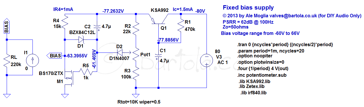

Here is an idea I was playing with for the 6C4C. Can be used for 4P1L but needs voltage tweaking given bias voltage levels:http://www.bartola.co.uk/valves/2013/05/18/fixed-bias-supply/
Ale
Ale

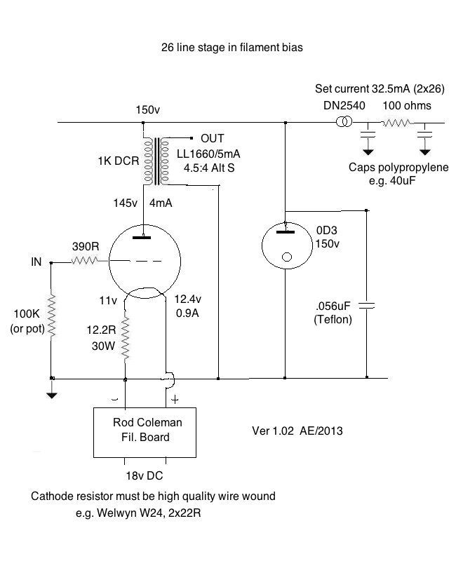

I agree that 26 and 4P1L are the best tubes for filament bias, but also include 10Y and 01A if you wish. But they are superb tubes, so that's not a handicap and PSE 4P1L can be used in the output. But 300b and 2a3 are not practical. As for the resistor - yes it has to be a quality wirewound, but there are plenty of those. And bias is exact and stable. So I really don't see these as issues, apart from the obvious limitations of tube choice. And don't forget the advantages - no bypass or ultrapath caps or input caps on the first stage.
The sound of DC with Rod Coleman's filaments isn't hard or cold - but you need a REALLY good DC supply. If you try it with even a LM1084 it won't sound as good. And you can add chokes in the filament supply if you want to go uber-clean. Rod uses the 300b and he designed his regs to be superior to AC.
So my actual experiences don't agree with your opinion of filament bias. Have you tried PSE 4P1L outputs in filament bias with Rod's regs and a top wirewound resistor (like vitreous enamel)? I don't think you can know how good this sounds until you actually make it and listen to it. If you do make it you will be surprised. It's unlike any other output stage I've tried for transparency. Maybe this can also be done with a top quality fixed bias circuit - Ale's looks the kind of thing we need. But until then I've actually found a solution and I'm very happy with it. If you look at the "26 pre amp" thread you will see that more and more builders are now using filament bias - it's becoming more accepted as a solution of choice for tubes like the 26. And in terms of "driver options for the 300b" 4P1L in filament bias is a strong contender if a mu of around 10 is enough for your purposes. And as an output, a higher mu tube like the 4P1L gives very welcome gain, and that can give you better input tube options.

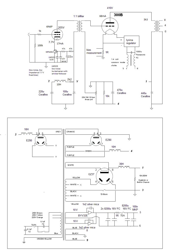

I’ve attached a schematic of one channel of my power amp, for reference
Paul N
Paul N

hi Andy,
as Paul notes: any grid bias voltage should aim to have the same dependency on the Mains supply Voltage as the Anode supply (B+), or else the Anode current will vary too much as the public supply fluctuates.
for instance, a 300B set up for the WE operating point of 350V 60mA (-74V) burns 21W idle. If the mains supply increases by 10% (which is allowed in the UK, and probably elsewhere, too) the anode current will increase to about 90mA, and increase anode dissipation to 31.5W. If the 350V/60mA point were less conservative, we risk overheating the 300B.
But there are ways around this problem:
- connect a negative supply, RC or LC filtered, and add a cap-multiplier at the end. This way, you can avoid electrolytics.
- or, you can make a regulator for the grid bias. But instead of using chips with bandgap references, or even gas tubes, which are needlessly noisy, you can use the B+ supply, tapped through a RC filter and cap-multiplier to generate a negative reference voltage. this reference follows the variations in B+, but has the noise cleaned out of it. Apply the reference to a PNP follower connected to bias supply V- ...... and you have a grid bias voltage, compensated for B+., and of low dynamic impedance (so you don't need an electrolytic). I'll draw it when I get a minute.

Hi Rod,
Great idea, didn't think about referencing to +B. My current circuit doesn't regulate bias voltage at all. It has a capacitor multiplier and a follower. I thought this way it should follow the mains variation as well. Haven't simulated the response to raw supply variation as I'm not at home now, but will do it later. Hopefully should be good, alternatively should add a reference to +B as you suggested?
Cheers
Ale
hi Ale,
The advantage of referencing from B+ is that the operating point is preserved, whatever the cause of the change in B+. So maybe you have a valve rectifier that varies its drop with age, or because you plugged in a different rectifier: the grid bias will be compensated.
And if you have more than one power tube running on the same B+, an open-circuit failure of one tube might cause B+ to rise; again the compensating action of the B+ reference prevents overstress of the good tube.
Naturally, it is not much harder to actually sense the anode current of the power tube, and servo the grid bias accordingly. Such a circuit can also start with a very negative voltage, to prevent applied B+ damage to the DHT when the filament is cold.
in this case, a lot of care is needed to keep the music signal completely out of the grid bias.
