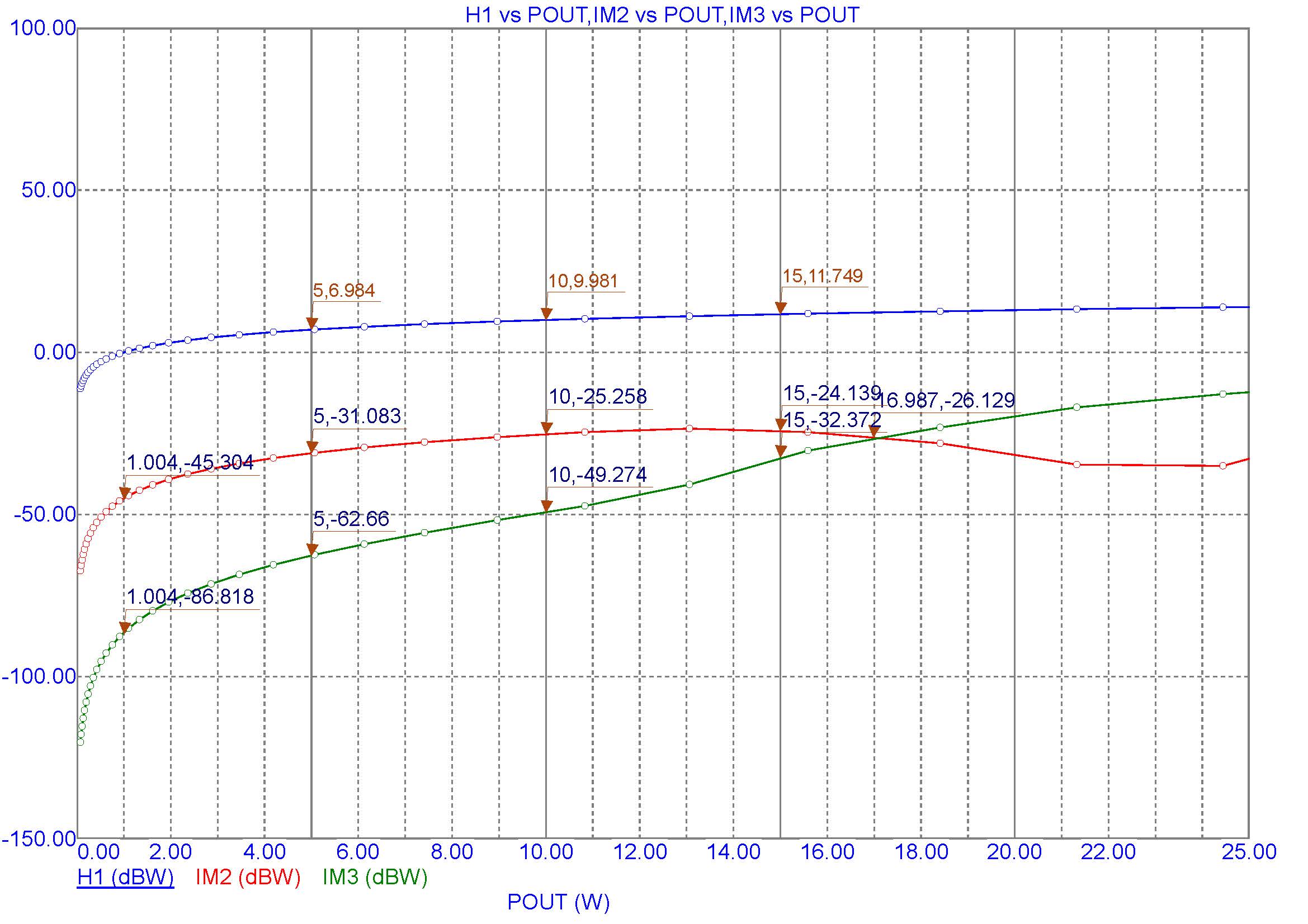

I started my amp build as an Flesh and Blood clone despite several people warning me about the limitations (Pieter, Thomas, Jeff). After a long time tweaking it sounds better than my Audio Note quest but as was to be expected I am running into the 6SN7 cascade driver limitations. THD measurements are really good but IM distortion is to high which I think explains why orchestral work could sound better.

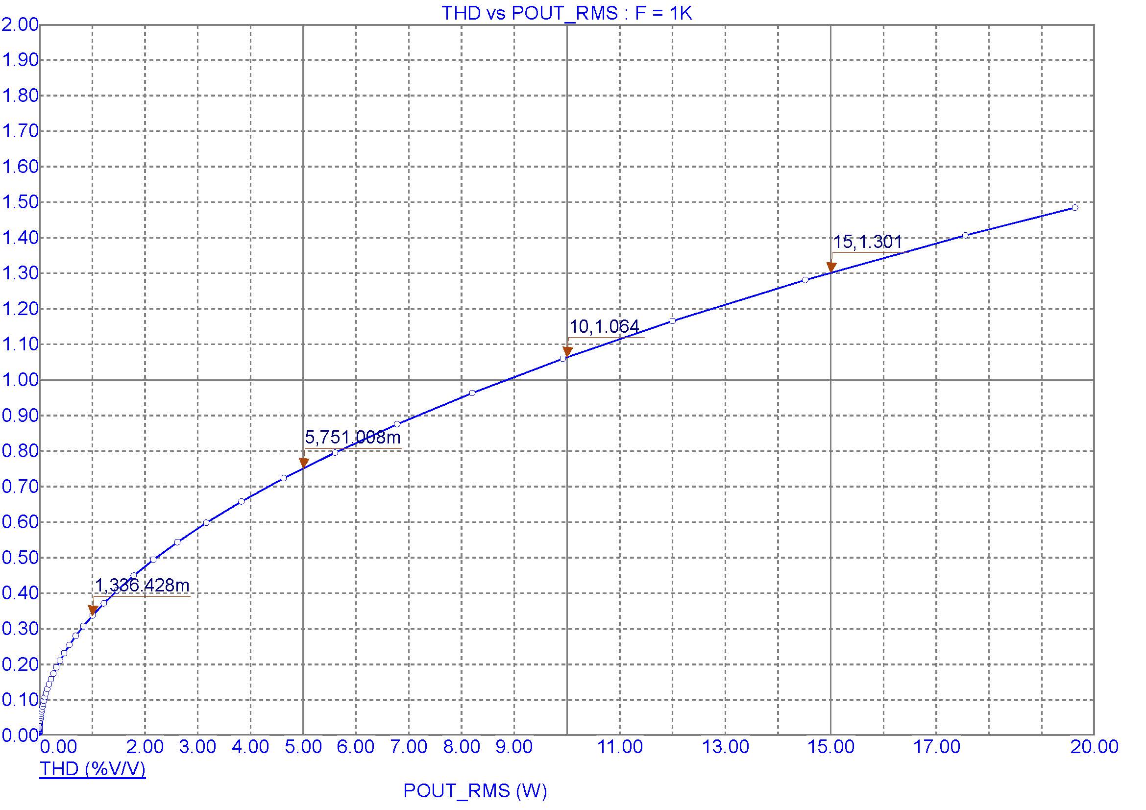

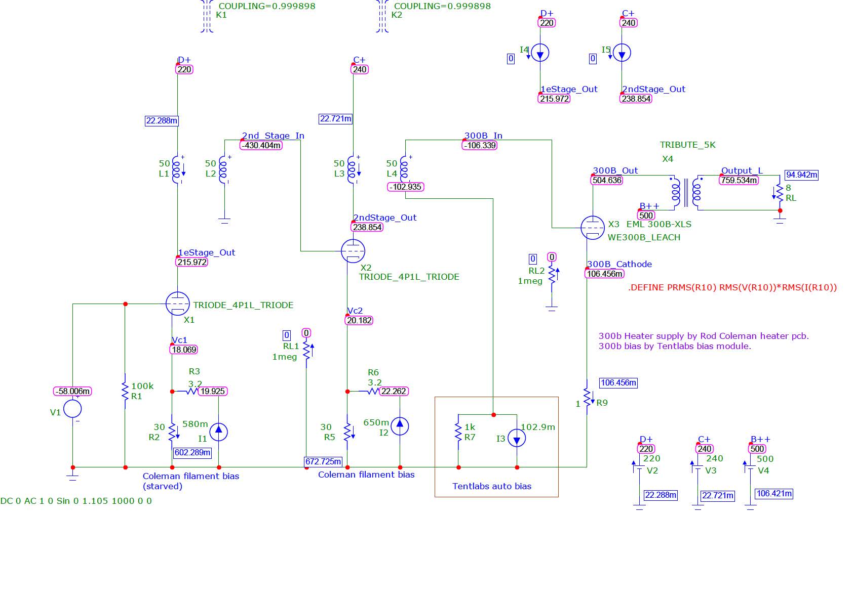

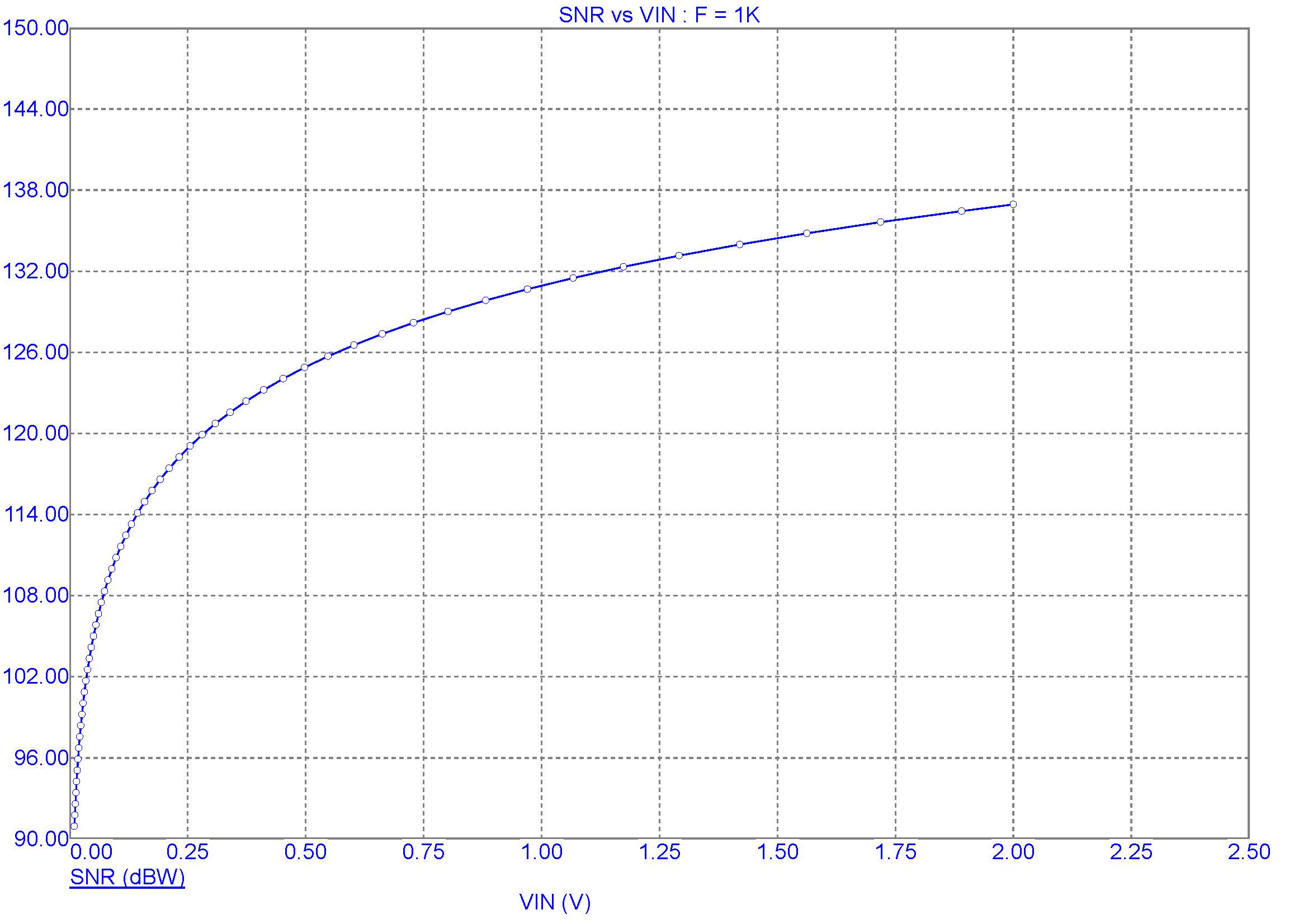

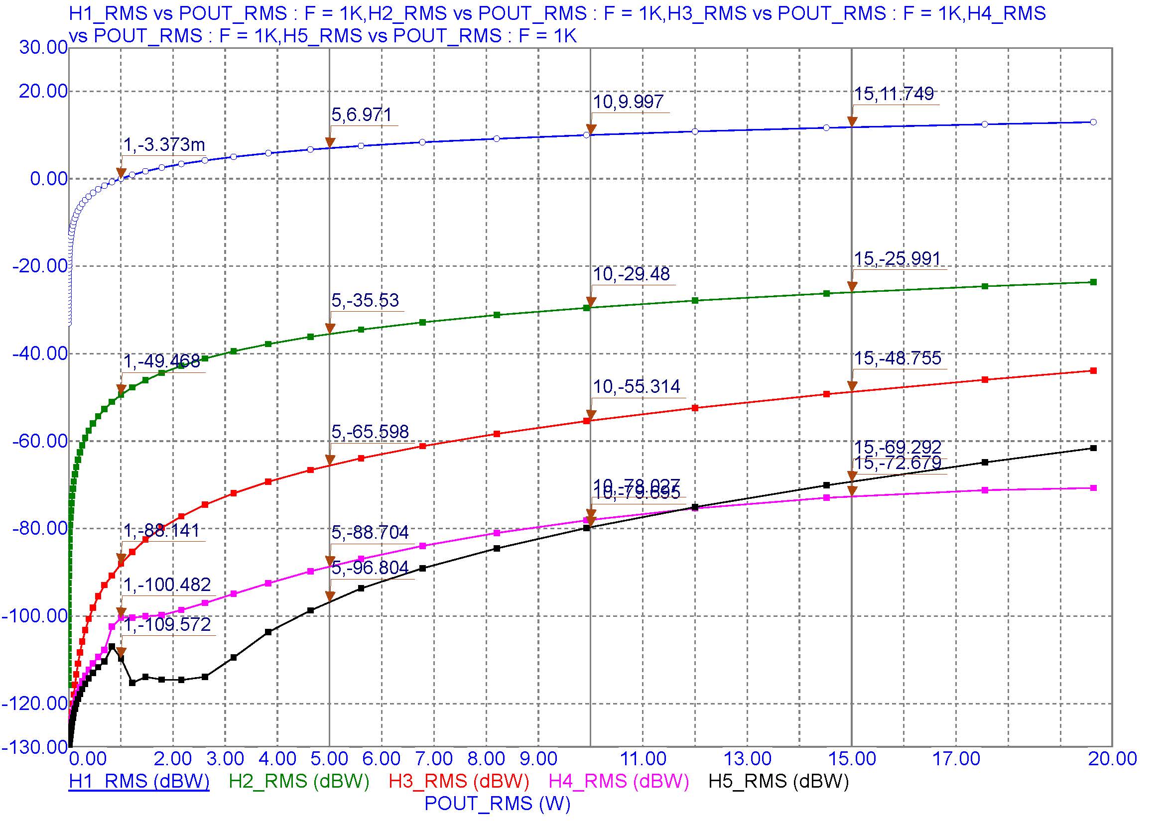

I became quite charmed of the 4P1L and am reading a lot of positive reports on them so I am leaning towards a 4P1L-interstage-4P1L-interstage driver setup for the EML 300B-XLS. Simulations look good, you can find them attached to this post.
6J5 is less suitable for interstage coupling I think but choke or CCS loaded 6J5 to 4P1L would be another option but would require a coupling cap. and amplification factor is a bit high.
I am not ruling out the pentodes just yet.
By the way, I am using a inductive volume control and speakers are 104dB Avantgarde Uno horns.

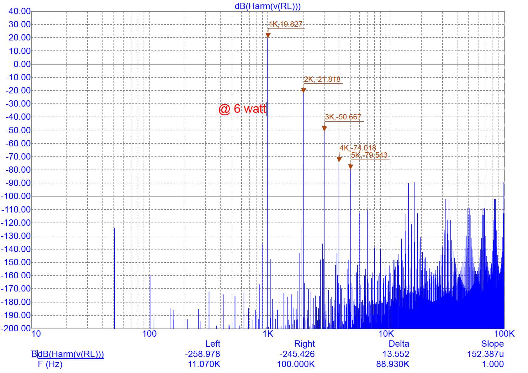

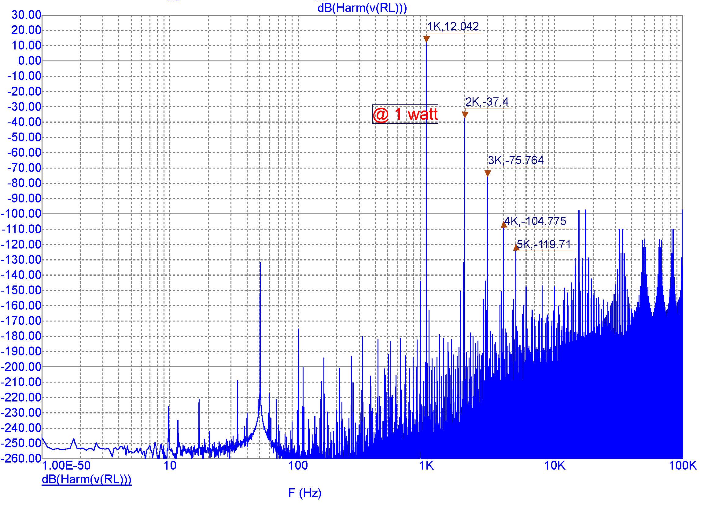

The work points of attached circuit are chosen for their low IM distortion and low odd harmonics.
THD could be better with 40mA on the second 4P1L, lower H2 but higher H3 and IM which I think is not desirable.
It are only simulations which are no substitute for listening tests but it is the only thing I can do at the moment.
I probably also need to build a separate PS for the driver as the 500VDC for the 300B-XLS is a bit unpractical for a 4P1L IS driver. Was thinking about AZ1 CLCLC with two SSHV2’s a good opportunity to use those AZ1 tubes I have been hoarding.

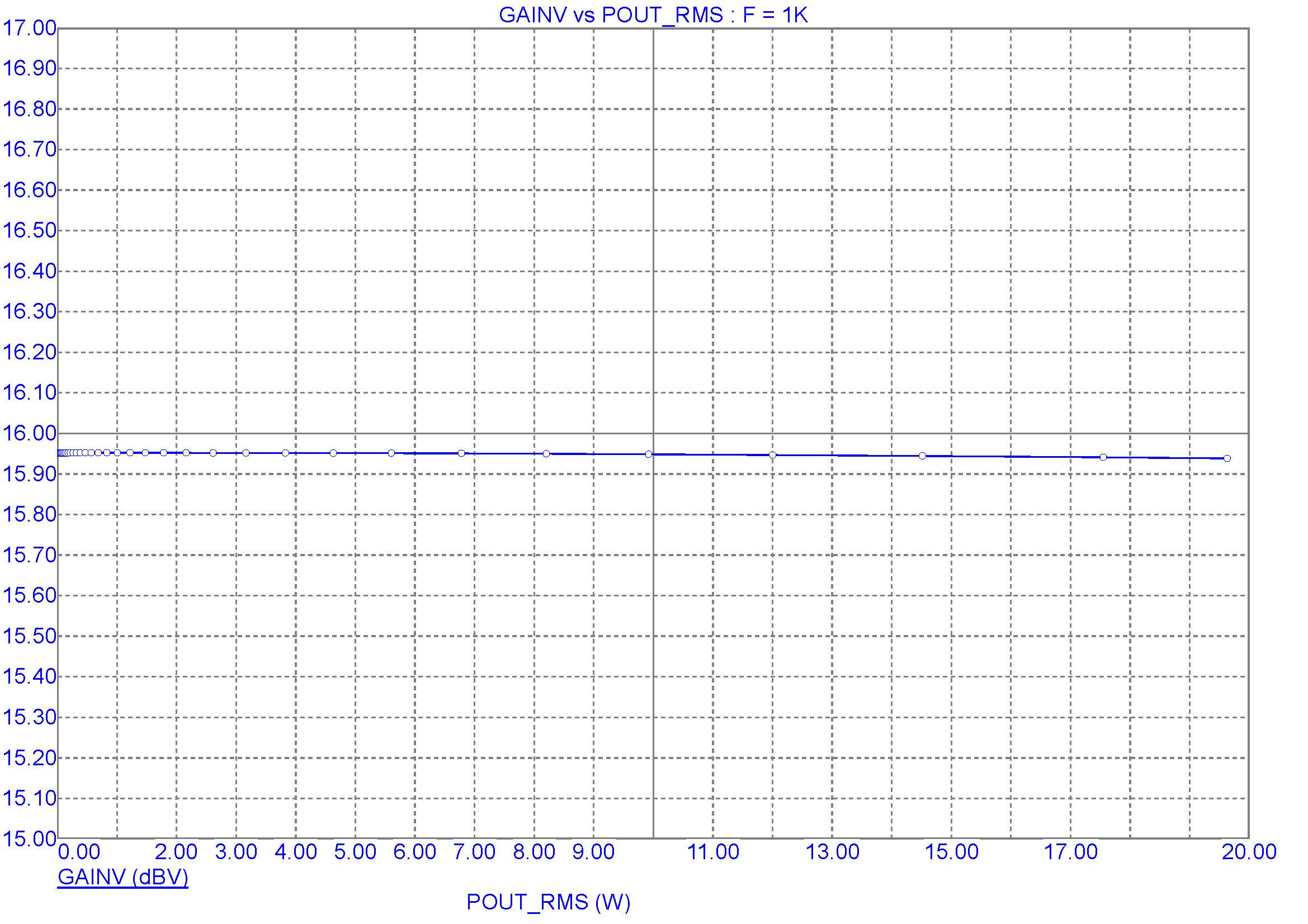

Simulation shows almost similar distortion patterns for 4P1L and 6J5 interstage coupled.
The 300B-XLS with a 5k OPT can deliver about 17-18 watt which would require 250Vpp at the grid.
With the 4P1L-IS-4P1L-IS 18W would require 3.85Vpp at the input, driver clipping starts at 5.6Vpp (1.98Vrms)
With the 6J5-LL1660-4P1L-IS 18W would require 1.64Vpp at the input, driver clipping starts at 2.2Vpp (778mVrms)
Seems to me that 4P1L as first tube would be a better idea, less gain and a interstage with less inductance can be used due to lower Rp of 2400 ohm.
Peter

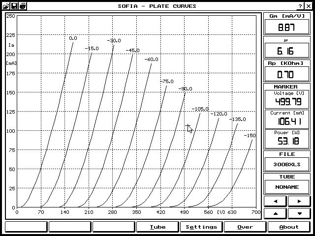

I don't think that 500V@106mA is to high for the EML 300B-XLS. Works well for me with a 5K OPT which is a custom made Tribute, low frequency saturation start was below 20Hz if I remember correctly.
I attached screenshots of the Sofia plots for the XLS at 400V and 500V.
Did a quick test with the C3g in triode but I like the 4P1L better as driver for the 300B but nothing decided yet.
You can try both operation points and get one you like 🙂 . my taste is 400V 80-90mA.
Some notes on C3g in triode: g2 & 3 connet to anode, coupling by Interstage tranny, bias at 180V 18-20mA. I receive many compliments to my power amp with C3g-IT-300B from friends in our tube DIY club.
