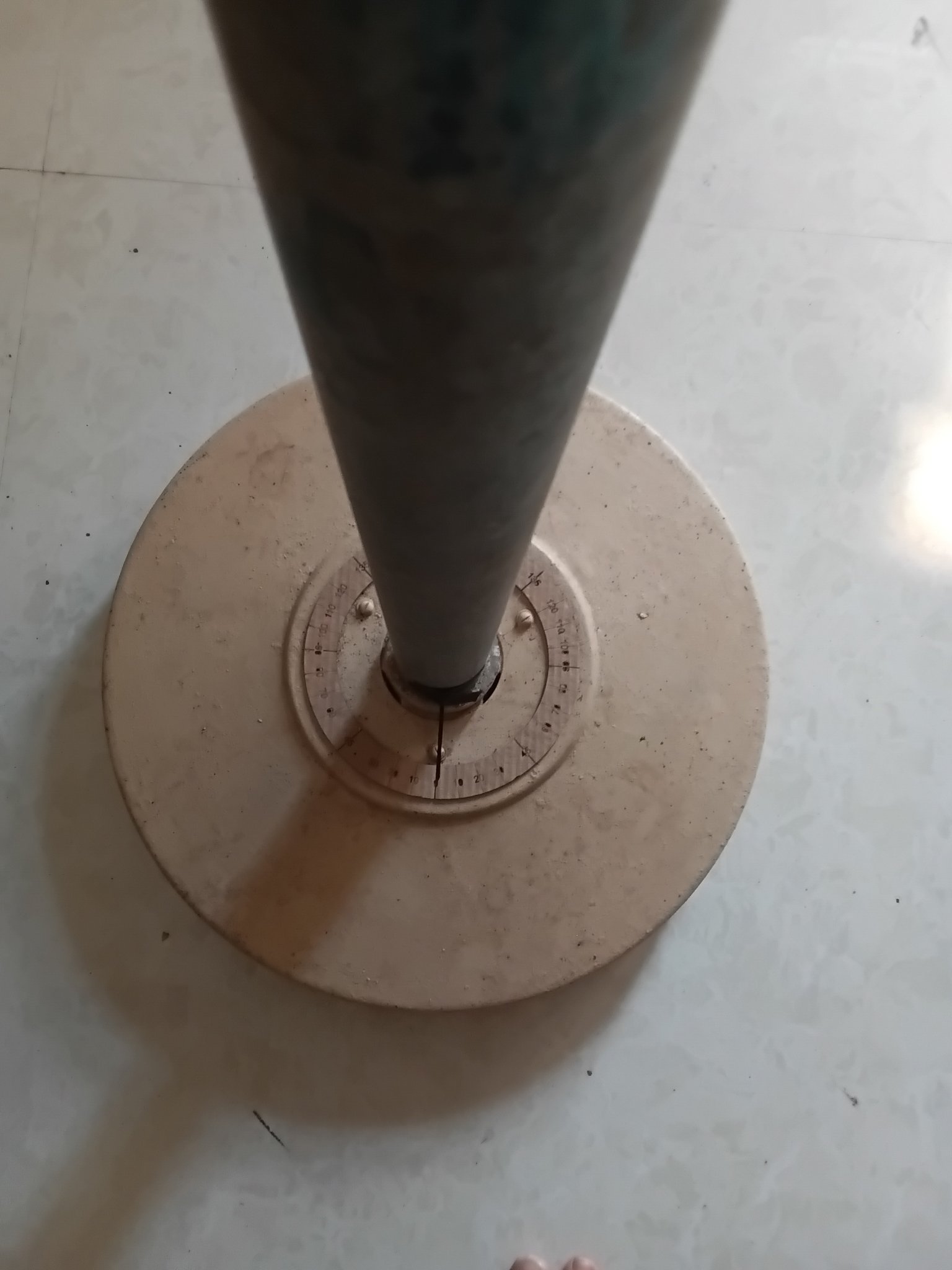

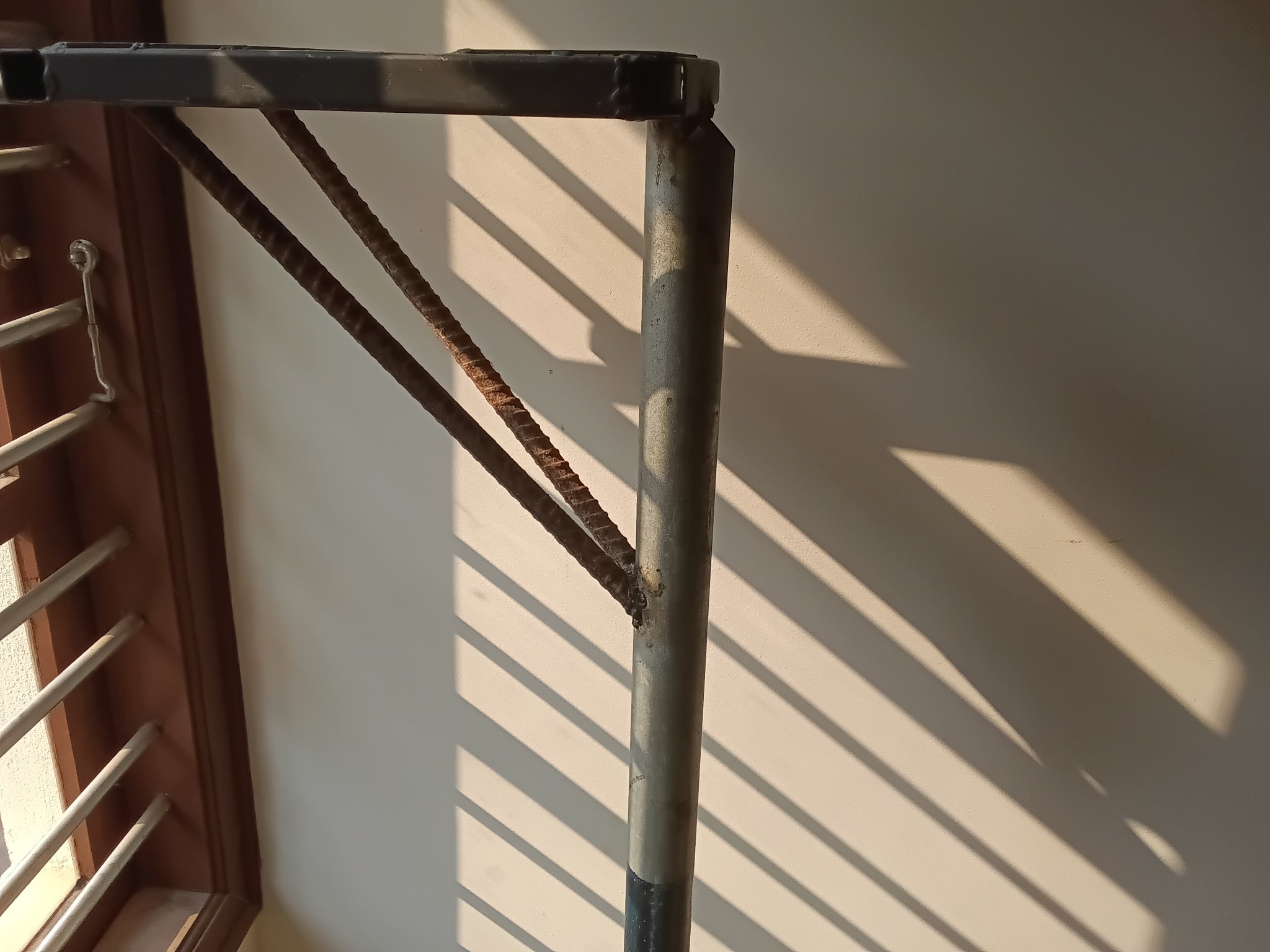

I made this first cut crude build to aid this painful procedure. Has a angle indicator too. Speaker plane will be centred along centre vertical axial pole so can have same distance more or less while I rotate. Next step is to improve this and add PC control and automation.Impedance and frequency response in the ACTUAL CABINET at different degrees.
The hard thing is to keep the distance perfectly the same over wide angles, otherwise phase gives errors ...
