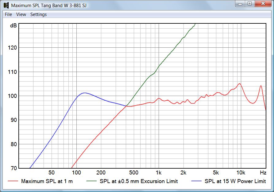

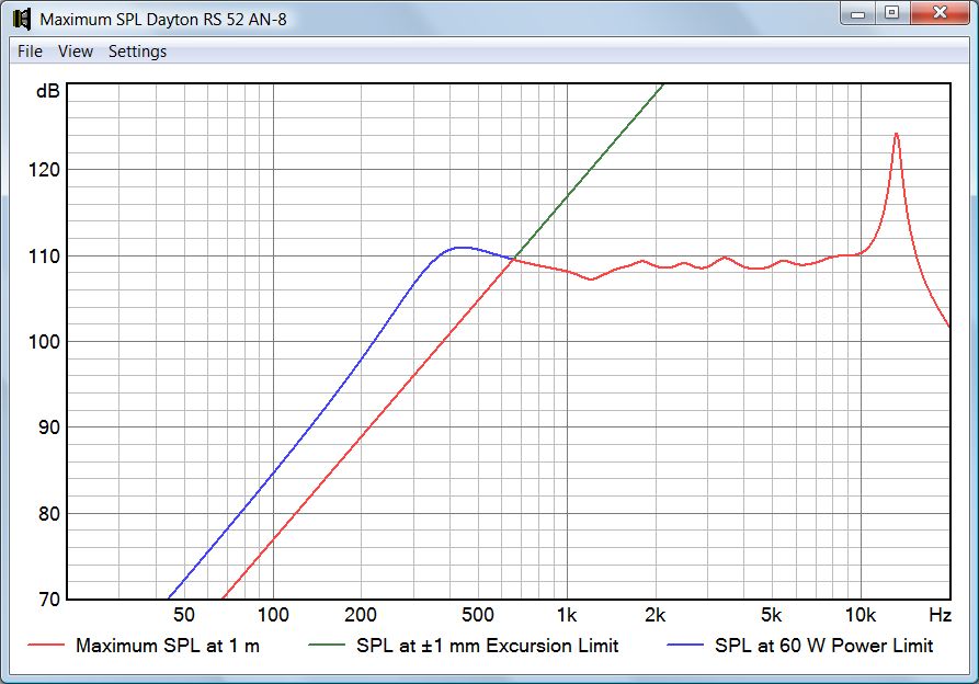

Those 3" cone drivers with tiny voice coils simply are not capable to produce the SPL required in home audio (>100 dB). A 2" midrange dome easily does and is perfectly suited. 🙂
