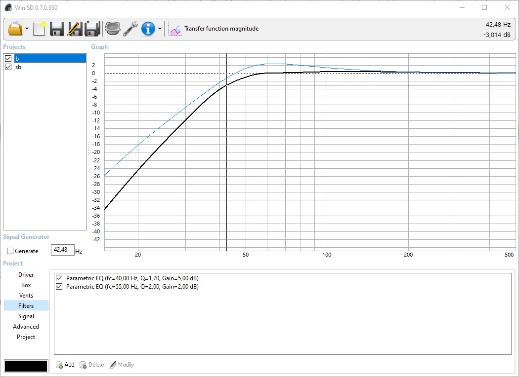

So, how about adding a woofer to the back then?
Thing is the volume needed. The speakers currently run ported on 30 liters, the above enclosure is for 36 liters.
I would probably switch to a closed, or better two internally seperate enclosures, and Linkwitz-transform them. For the PHL 3411, 18 liters work when the midwoofer only plays to 50 Hertz. The idea is a "low-cadioid" pattern, where below 50 Hertz. the woofers radiate omni and a lot of energy is saved. This is what Bruno Putzey did with the Kii speakers and I think what Dutch&Dutch do. In the Sound & Recording review of the GGNTKT M1 by Anselm Goertz he wrote there was not a significant difference after room correction compared to full cardioid.
So what I am looking for is an efficient 10 inch subwoofer (probably could fit a 12 inch too) that could play to 200 Hz in ... 18 liters?
Can I make this work with some Class D power, and can I have some suggestions on the hardware?
Do the subs and midwoofer of the D&D 8c share the same enclosure internal space?
