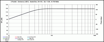

I'm in the planning stage for a pair of subs to go with my upcoming DIYSG Vortex-15s. Due to the size of the Vortex I'm constrained to a pair of 14.5" wide cabinets and 12" drivers. Power will be a Crown XLS2500 already on hand, with MiniDSP 2x4 for processing and room correction. Based on this I was looking at doing dual sealed 12s, in 60-90 litres and applying Linkwitz Transform. The ability to dial in any f3 and Q appeals to me since I'm not sure what is going to work best in-room. Usage will be both music and HT, but the subs are mostly to cover the 20-40Hz range for movies.

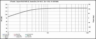

The question I have is around drivers. I think I've narrowed it down to either the Lab-12 or the new RSS315HE-22. A parallel pair of either provides a load 2 ohms or greater across the sub range. The Labs hit xmax at about 700W input in 60L, so the amp would need to be backed off a bit. The RSS pair can take all of the power but wanted a larger box, with 90L being about as big as I can go, and they still have excursion to spare. Surprising to me, the RSS only model a couple dB higher. The main advantage of the Labs is that the box is small enough that I can go dual opposed. With the RSS both drivers would need to be front-firing, and I'm worried that even a well braced box is going to shake from the driver movement.

2xLab-12 pros:
- smaller box allows dual-opposed
- more sensitive ~103 dB at 20 Hz on 700W
- about $150 CAD lower cost for 4 and available locally
Lab 12 cons:
- xmax and thermally limited, not using full output of amp
- older design (although highly regarded)
2xRSS315HE pros:
- slightly more output ~105dB at 20 Hz on 1200W
- amp limited, excursion and thermal ratings exceed amplifier capability
- double spiders & lower distortion motor?
RSS315HE cons:
- larger box to get more out of the drivers precludes going dual opposed
- only 2 dB more output for nearly double power
- higher cost
Right now I'm leaning towards the Lab-12, based on lower cost, smaller box, and very similar output using less power. Are there other drivers I should be considering that might be better suited to this application?

Thanks for this, I had not looked at the SDX12. The simulated response does look nice, however the cost is nearly double the others for only a couple db more (amp limited in my case).

I did/have modeled the LT in WBCD. It gets a bit funny with how it normalizes to the amplifier power, since the gain gets excessive at very low frequencies and would also need a HPF. I omitted the boost from my graphs just to get an idea of the maximum theoretical output. The reason I want to go sealed is to minimize cabinet size and also to ease integration of different subs. This pair of dual 12's will join a pair of sealed single 15's (4-ohm Lab 15) that I already have. So there will be a total of 4 subs in the room. 120 dB in room at 20 Hz is very impressive though. My room is completely open on one side so I may not fare as well.
