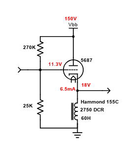

Here's my attempt to design a cathode follower that meets my needs:

For the bias voltage I assume that the effective Vp is 150-18 = 132V. From the 5687 graphs I can see that I need -6.7V bias to get 6.5mA plate current at 132Vp. Given the cathode is at 18V I assume I need 18 - 6.7 = 11.3V on the grid. I used a potential divider to set that voltage (this is what Morgan Jones shows).
I'm attaching a schematic for this stage. Please let me know if I'm on the right track.

Yes, you're on the right track. I would encourage you, however, to figure out what peak 810 grid current is. It happens on the left side of your load line. It will be a LOT of current.
Some tubes have a maximum cathode current or peak current rating. The 5687 probably isn't up for the job. You may be looking at something more like an EL34, 6080, etc.

Your load line shows you will hit +70V on the grid at the line where grid and plate voltage meet (so the plate is also at about 70V). If you go back to your grid current graph, that spot is at about 125mA or so. The 5687 does not show a peak cathode current rating that I can see, nor does it show any operating points that run nearly that much current. Based on that, I would disqualify it.
Note that the plate dissipation does not come into play here, it's more about whether the cathode is beefy enough to tolerate this.

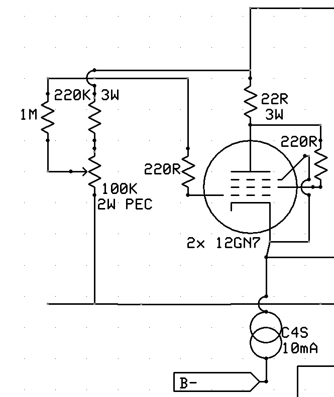

The grid current from the 810 is a given quantity, as is the P-K voltage of your cathode follower. The variable will be how much current flows through that choke. Of course if insufficient current flows through that choke, then the 810 won't be biased up properly. This is why I use the biasing arrangement that I posted to provide some adjustment. I have never been able to build an amp like this without having adjustable bias to keep things dialed in.

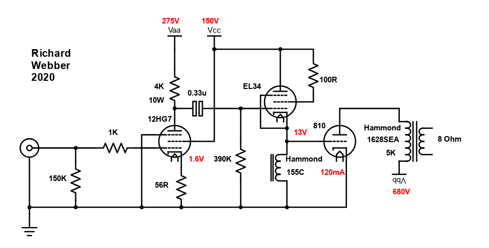

I've made some progress. I replaced the IST with an EL34 choke-loaded cathode follower. See attached schematic. It's definitely not optimal - I cut corners to get started. The operating points have been chosen more for convenience than anything else.
For my initial results I'm getting 1% THD at 0.1W, 2.6% at 1W, 5.3% at 10W and 9.0% at 20W. By adding -13dB GNFB these improve to 0.5% THD at 0.1W, 1.6% at 1W, 2.3% at 10W, 3.5% at 20W and 8.5% at 30W.
I need to figure out the source of the distortion - I think that at lower power much of it may be coming from the driver. At higher power I may well be suffering power supply sag for my 150V supply from the high grid current.
I still have work to do but have something to work from. Thanks for all the help so far. More suggestions are very welcome.
