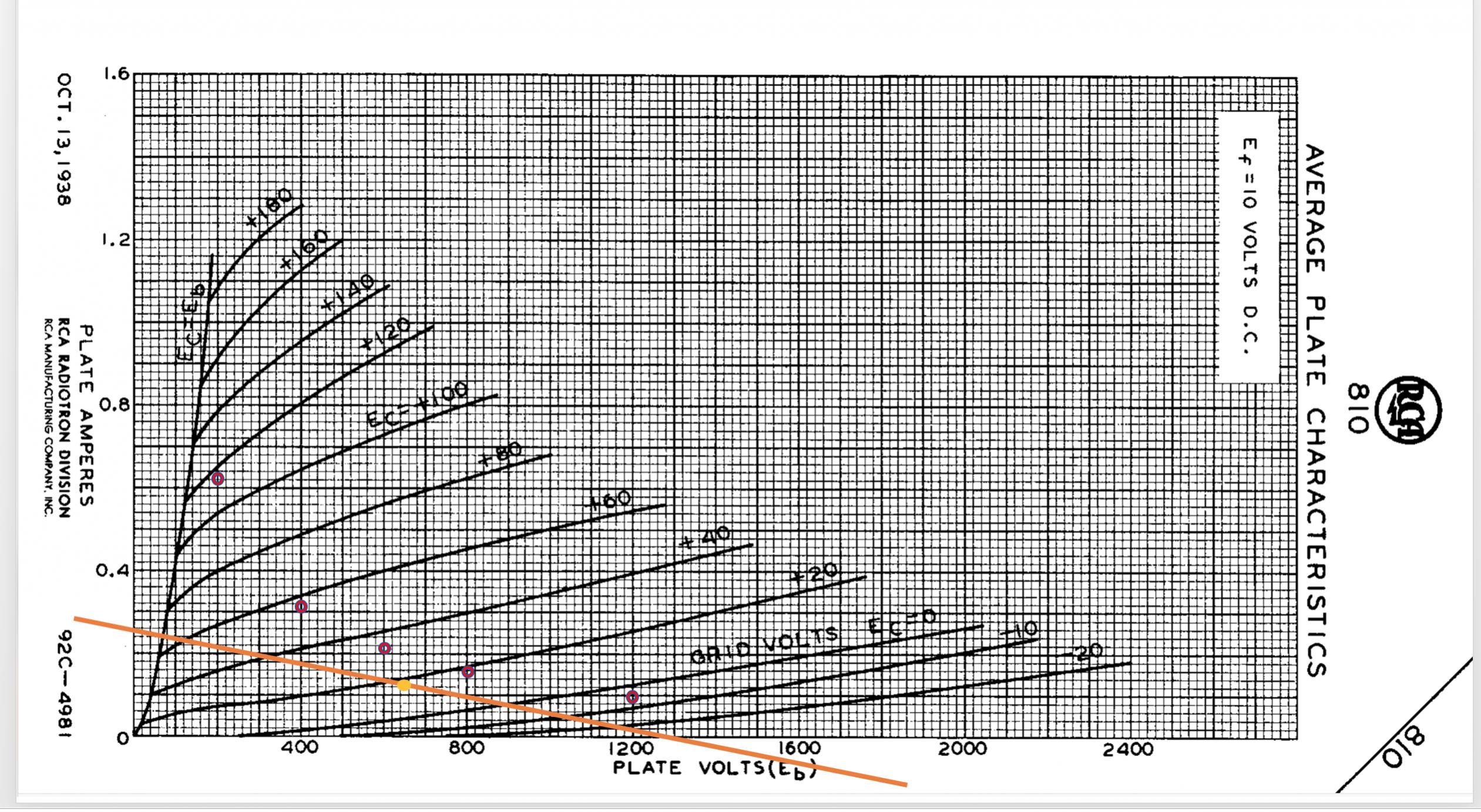

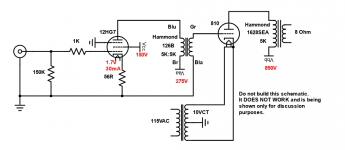

I decided it would be fun to try some single ended experiments with transmitter triodes. I already had an 811A and 812A from when I was trying some RF stuff. I decided to get an 810 to round out the trio of triodes. I want to use these experiments to learn more about driver stages. So far I've built a few capacitor coupled, no-grid-current amps, so this is new territory for me.
I decided to start with the 810, partly because it's a magnificent looking tube and also because it looks like I could get decent results with zero bias. I can always add some positive bias to increase the power later. I'm attaching the loadline for a 5K OPT (Hammond 1628SEA).
I have a Hammond 126B interstage transformer that I thought I'd try, since from what I'd read it seemed the simplest way to drive grid current. I had already worked with a 12HG7 - with 30mA of plate current it can easily swing 100Vp. I thought that if I coupled it to the 810 with the 126B (5K:5K - max 30mA) I might be successful.
It was not successful (as many of you probably could predict!) and I'm interested to understand what I need to do differently. I'm attaching the schematic.
If I connect a 5K resistor across the IST in place of the 810 I see a nice sine wave. With the 810 in place I get significant distortion. I will post the waveform later when I'm home. As I recall it looks like one half of the wave is distorted. I'm guessing it's the half when grid current is being drawn and my driver is not capable of delivering it. Could it be that the output impedance of the driver is too high?
I'd appreciate any guidance. At some point I will want to look at other drivers including FETs, but for now would like to learn how to use the IST.

If you use a pentode driver, the plate resistance, rp, is very high.
Now, you use that pentode to drive a very non-linear impedance load.
The pentode driver and interstage transformer will drive the output tube both positive and negative.
1. When the output tube grid goes positive, it conducts, it might be around 1k Ohm.
Your pentode driver high impedance plate is trying to drive that (not good).
2. When the output tube grid goes negative, it is a very high impedance.
Your pentode driver high impedance plate drives the high impedance output tube grid, it likes that grid impedance.
But there is a secondary effect, the pentode is also trying to drive the interstage transformer.
At low frequencies, the inductive reactance of the interstage has a low impedance.
And and high frequencies, the distributed capacitive reactance of the interstage has a medium to low impedance. At mid frequencies, the interstage load is better for the pentode.

Thanks - this is very helpful. I was concerned about the output impedance of the driver being too high. According to the graph on the gird (attached) at +60V the grid current is around 20mA. Does that give a load of 60/0.02 = 3KOhm? Not sure if I got that calculation right.
On the frequency impact on the interstage - is that a general problem with ISTs or is it pentode-specific?
I can see that a cathode follower can be used to lower output impedance - do I need a buffer stage?

The 810 is a bit of a pain to build with, but it's doable. I have 810 amps sitting in my house that make 50W, but it took a lot of work.
The first recommendation I would have is to look at your 5K load line and move your operating point to the midway point between where it hits the X axis and where it hits the VG=VP. That will be more like 675V. If your OT can't handle the idle current there, then adjust the operating point so that you are about in the middle of the load line at your quiescent operating point, otherwise you're throwing away power.
My second recommendation would be to consider that the Rp of the 810 will be somewhere around 10K, and your output transformer is a 5K unit. You have to use feedback to reconcile these issues. I used local Schade feedback to account for that. Your load line it totally reasonable though, don't sweat that.
Lastly, yes, the grid is going to draw current. No, the 5K:5K interstage transformer is not adequate for what's going on. Pretend the grid of the 810 is a 600 ohm resistor in terms of AC analysis and work from there. A 12HG7 would be a fine tube choice to wire up as a cathode follower to directly couple to the 810 grid, though you'd probably want two to deal with the peak current required.
This will leave you needing a third stage. I used a pentode up front because it was the most sensible choice for Schade feedback. There are other ways to skin that cat, and that might not be what you're after, but you'll still want to have a 3 stage amp.

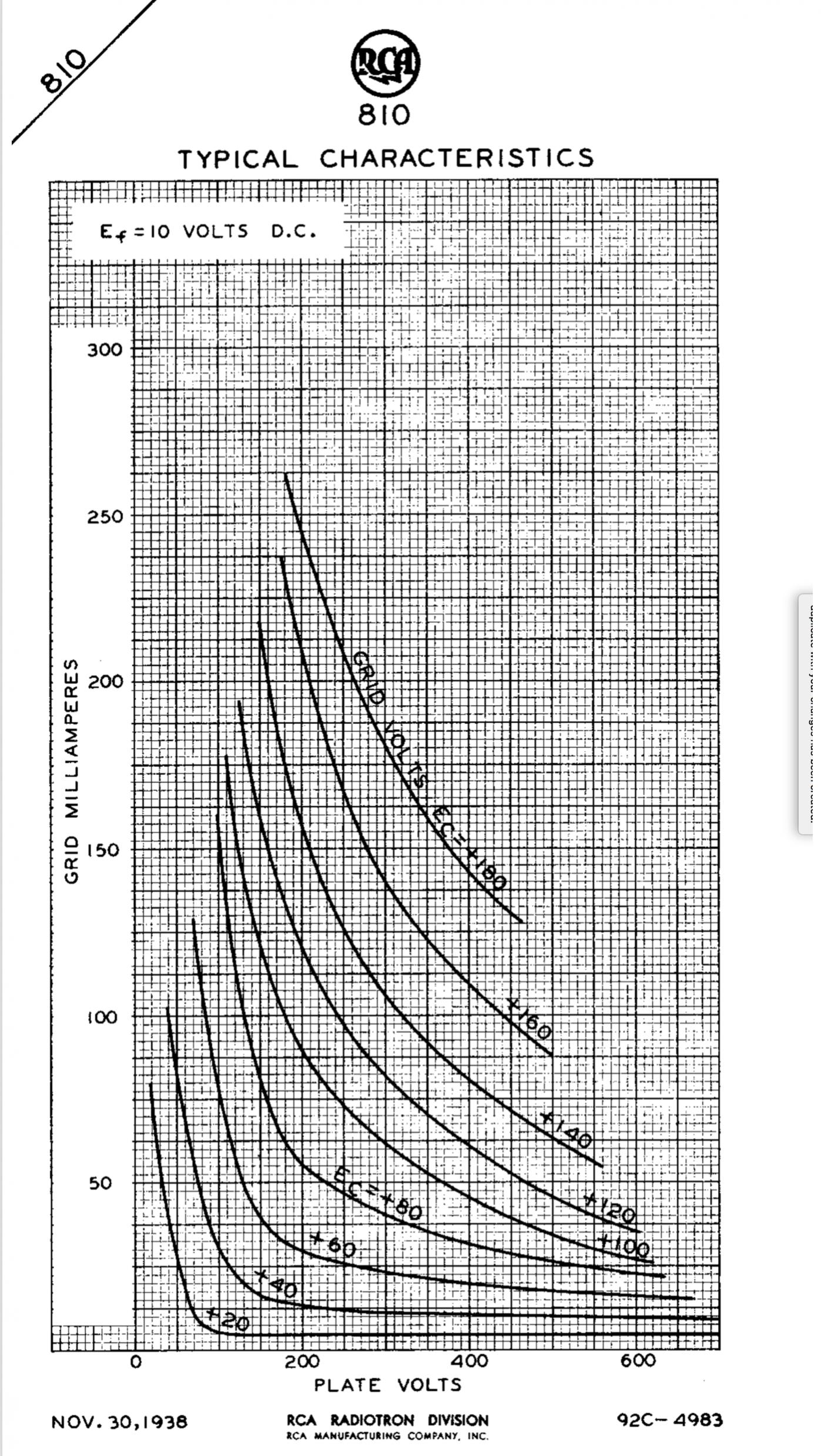

The grid current curves you provided will help you.
Take the slope of a curve, say the +40V grid curve.
With the plate at 200V, the slope of the grid current is almost flat.
With the plate at 100V, the slope of the grid current near that point is about:
100V +/- 10 V (20V change), the current changes about +/- 5 mA (10 mA change).
20V / 0.01A = 2000 Ohms.
The grid impedance with the grid at +40V, and the plate at 100V (impedance at audio, not RF) is about 2000 Ohms.
Yes, you need a lower impedance driver, and perhaps some negative feedback for the driver.
A properly designed cathode follower can have low impedance, and lots of current, and is a form of negative feedback (degeneration).
But there are lots of factors to design a cathode follower to properly drive such a non-linear load impedance.
Some power triodes can drive fairly low load impedance.
But you probably will need negative feedback here too.
But notice the large changes of output tube grid current when the grid voltage is 20V, 40V, and 60V, even when the plate voltage swings to 400V with signal applied (half of your 800V B+).

This is great. Thanks.
I'm attaching a revised OP. I assume that's because it offers maximum voltage swing for maximum power output? The reason I picked the OP I did was that it was zero bias and saved me the step of building a bias supply. I figured I could add that in later and move the OP once I got it working at lower power. The new OP requires just under +20V bias and would result in a plate current of 120mA - the max the 1628SEA can handle. It does look like a good place to end up. It could deliver 30W there.
I looked at a 10K loadline too - the 1628SEA has a 16Ohm tap - if I connected an 8Ohm load to that I assume the 810 would see a 10K load? Would that compromise the sound quality too much?

You don't need a bias supply. Use a choke loaded cathode follower. The Hammond 155C and 156C are good for this purpose. You'll notice that the 8mA DC rating of the 156C and it's 3.7K DCR make a voltage drop of 30V while the 155C is 22V. Your desired quiescent grid bias voltage is about 18V DC, so either choke won't have a problem with that. I will design the cathode follower so that a little positive bias should be applied to its grid in order for it to draw sufficient current to bias the output tube to the desired current. Just keep in mind that both the choke and the 810 grid are DC current paths.
You do not want to adjust the ratios of a series feed output transformer, especially not a Hammond! Even if you do, the damping problem is still there.
Yes, the IST is not well suited for this project IMO.
What you use up front is up to you. That is the toughest part of designing an amp like this. You can just use something with tons of gain up front and put feedback around the whole amp, as the bandwidth of the output transformer isn't sufficient to avoid oscillation issues.
If you have the cathode follower driver grid at a positive voltage versus its cathode, again, you have to deal with that low impedance grid too, not just the low impedance grid of the output tube.
Another non-linear loading grid to deal with.
If we say, for example, that the cathode follower with 0V DC on the grid directly coupled to the 810 grid with a Hammond 165C as an additional load will only draw enough current to bring the bias voltage to +15V, we can apply a little positive bias voltage to the grid of the cathode follower to entice it to draw a bit more current to increase the bias voltage available to the 810.
This does not change the input impedance of the cathode follower provided the positive grid bias doesn't get too close to the cathode voltage of the cathode follower.
I will typically use a 25K/2W pot with one end attached to ground, the wiper connected to the grid leak at the cathode follower, then the other end connects to B+ through a high value resistor to set a reasonable range of bias.
That makes sense, it's a slope and not a horizontal line.
