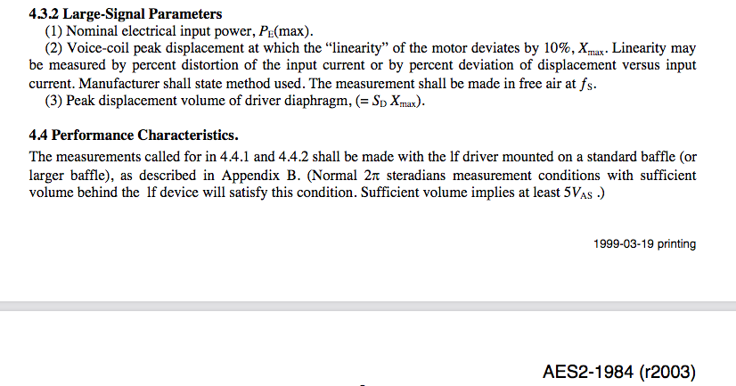

AES2-1984 (r2003) subsection 4.3.2 defines Xmax.Not confusing x-max with maximum excursion As published, it is sometimes confusing as some list one way, some list X-max as p-p. I do not know where your 10% came from as I have not seen that in a specification.
Xlim (or Xmech) is sometimes reported as peak to peak excursion, though often goes unlisted.
Xmax is one-way linear excursion measured in free air at Fs.
Xmax is also derived by measurement of voice coil length vs magnetic gap height. The harmonic distortion by that derivation won't be known, though empirical THD measurement of well made drivers results in similar distortion vs. the AES2-1984 (r2003) definition.
A driver in a small sealed cabinet would require a higher voltage to reach Xmax than it would measured in free air. A driver can easily exceed Xmax at a fraction of it's power limit (Pe), or also exceed it's Pe without exceeding Xmax.

Welter, your definition of X-max is what I was taught, not the AES spec you reference. Thanks. Guess I am not the only one who has not read it as some manufactures list one way, and others peak to peak, and others do not say. X-Lim is usually listed as the mechanical limit and is larger than x-max. As in when the former hits the pole piece.
