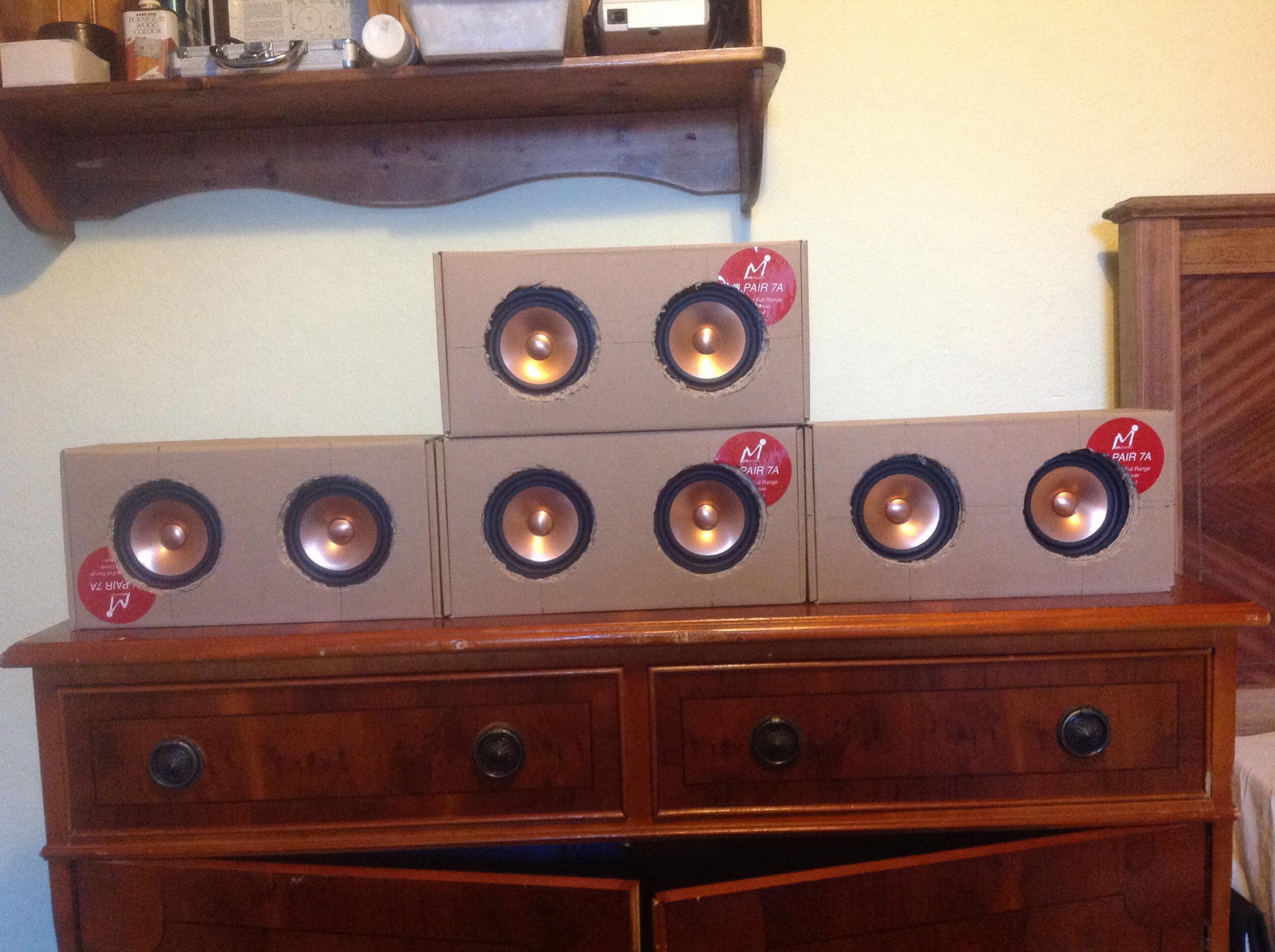

That's the next project, after the twin driver studio monitors (4x7.3)

Revised monitor by Scott (thanks again) I will be posting some build pics and impressions. Idea is for a near/mid field audiophile level monitor. Stage 2 build, give it one 7.3 and some serious muscle underneath. But one step at a time.

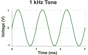

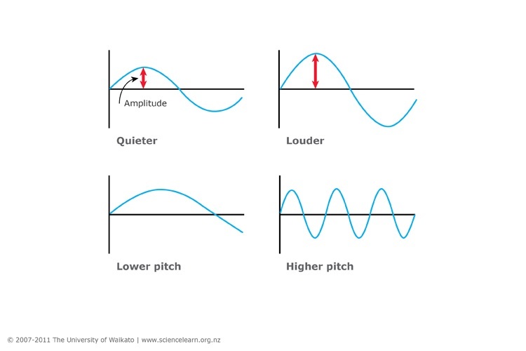

Hi Guys,
Member Rick seeks clarification (I think) on what happens to a driver when its subjected to a constant artificially generated signal, such as test tone and/or a single amplitude signal (see 1-kHz pic). Much depends on the type of driver being tested or run-in but for light-mass Full-Rangers, there's a risk of creating a "memory" affect within its moving parts, especially its cone when using signals of these types.
Perhaps the best way to imagine this effect is by looking at the 1-kHz pic and visualising that when a low-mass cone is subjected to such a constant signal, this single patten begins to burn its way onto the top layers of its surface. The effect can be further exaggerated if a light-mass driver is subjected to heavier constant signal loads early in its life (see sound-waves pic). Also, depending on the design of the drivers suspensions, their compliance may become more limited to the specific cycle generated by the particular fixed signal.
Hence the recommendation is to use general/popular/easy listening music to run-in most any Full-Range driver, these loads are variable and mostly non-linear.
Hope this helps.
Mark.
(pics courtesy of:The University of Waikato - copyright acknowledged)

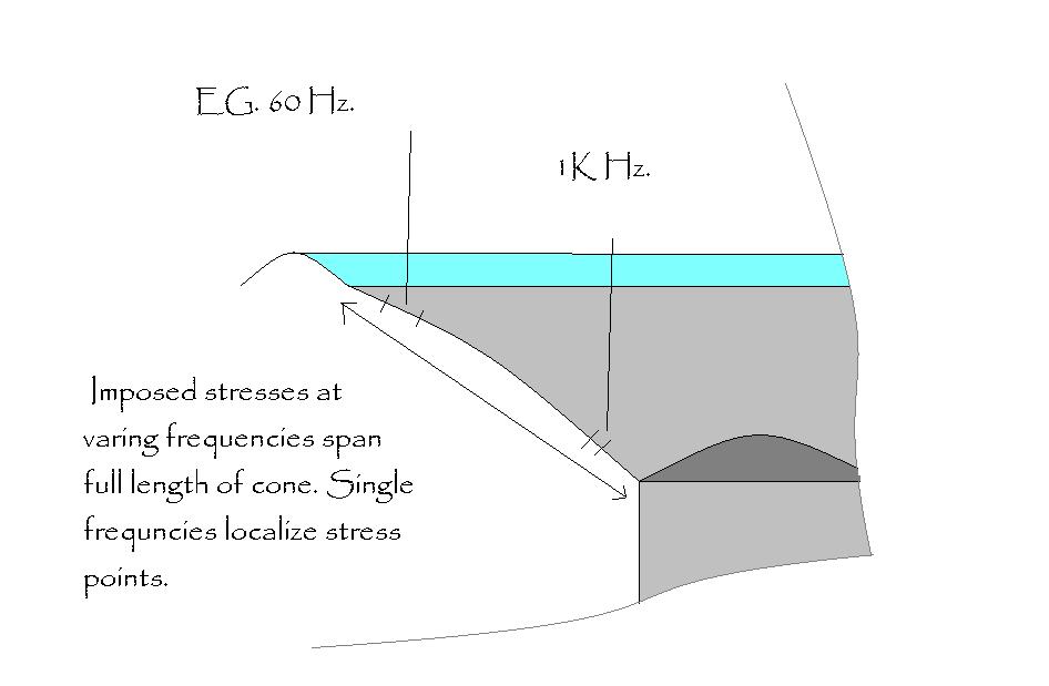

This is my take on the cone stress issue, am I on the right track here?

Hi Rick,
I welcome debate provided its done with respect, without resorting to negatively personalising anyone's integrity, including mine.
Many members report audible changes in drivers during the earlier hours of operation. Its more likely to relate to low-mass light load Full-Range drivers due to their particular design and function characteristics. The micro-resonant function of low mass cones is complex and challenging to measure. I'm one of a few with the necessary lab equipment capable of analysis of these properties. I know that such cones are capable of audible state change, a factor often noted by many members who's hearing is of sufficient sensitivity to notice these events. For heavier mass, higher load drivers, it may be less of an issue but I can't speak for every driver maker, they may have their own operational requirements.
Your drawing is very interesting but not accurate. To produce the effect you describe, the indicated likely amplitude on your drawing given its relative proportion would be < 10 to 20 Hz. At 1-kHz, there's no prospect of producing the effect you describe in your drawing from typical service loads.
But I appreciate what you're trying to imagine. For me personally, I'm always wrestling with competing design factors, especially those where I'm asked by members to increase the operational performance of drivers, but at the same time, produce a reliable product. I have some sympathy with your thinking that there are "limits" to can can be achieved and what should be expected from a Full-Range driver. Stress loadings on Full-Range drivers are more critical. In the latest models, I've introduced the Arrestor to help eliminate the worst of excess loading, short of "suicidal" operation, there's little danger of breaking a cone.
