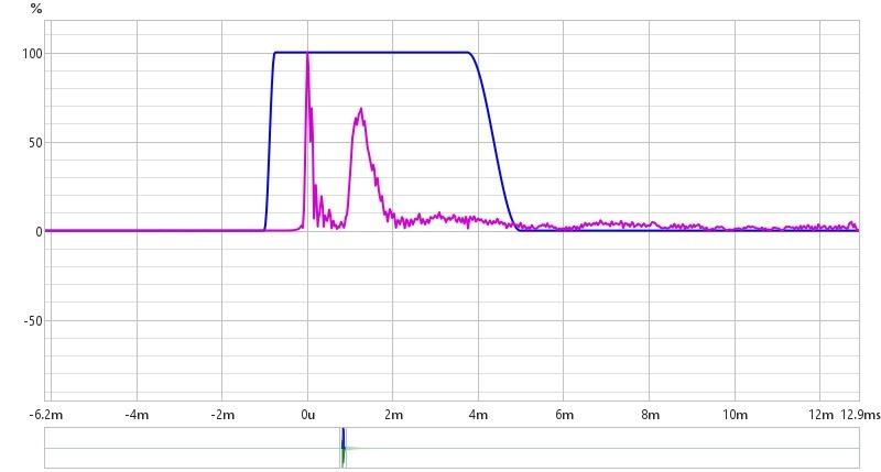

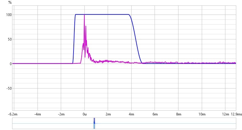

You can check driver time alignment using REW Impulse response envelope (ETC). If they are misaligned you will see separate events (see attached pics). At some point the alignment is within the XO duration and then you can't tell.
