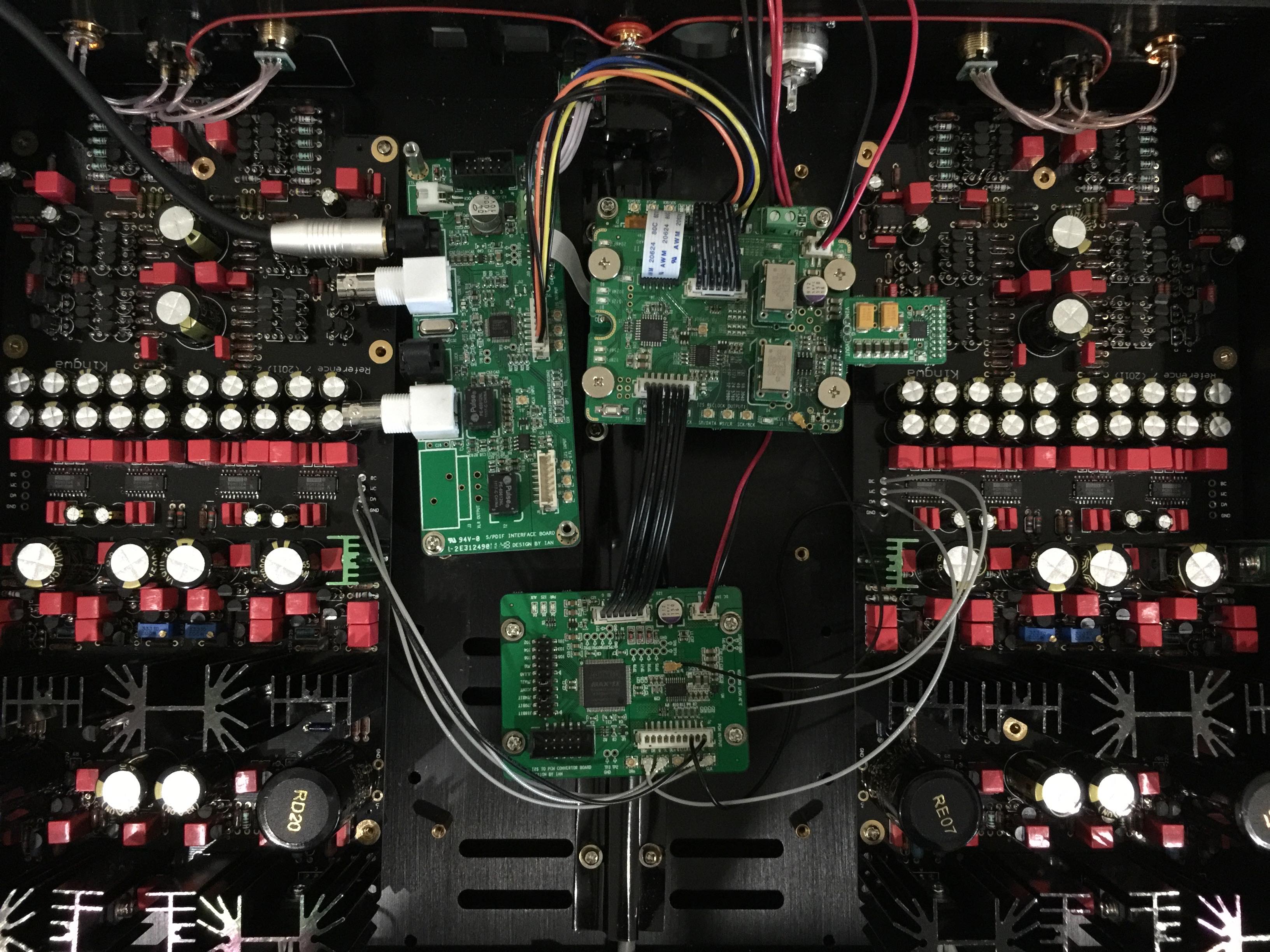

I thought I'd share my Audio-GD Master 7 (PCM1704UK DACs) modification of replacing the internal DSP1 board with Ian's SPDIF > FIFO > ISOLATOR > DUAL XO > I2StoPCM chain.
I had previously found and measured a number of issues (distortion, phase shifts between channels) with the Audio-GD USB and DSP implementations in the M7. As a result, I've since replaced all of these sub-standard components with Ian's gear. I agree with Regal above that the DAC/output sections seem very robust.
Fortunately, Audio-GD's M7 DAC is modular and I was able to connect Ian's I2StoPCM board straight into the DAC and I/V output boards.
Most troublesome bit was soldering/terminating the U.FL coax's into the through-hole solder pads of the DAC boards. I am thinking of replacing this one day with a pin header and connectors. Or maybe etching my own U.FL sockets to pin header PCBs.
Overall, I believe it has improved the sound quality significantly. I'm hearing more detail and changes in tones/keys that I wasn't hearing before with my standard reference tracks.
Operationally, I'm upsampling tracks to 192 KHz in software (OS X, Audio Midi Setup application).
There is a downside - after the modification, when I measure the output analogue waveforms (test sine waves) on my DSO, I can see distortion at sample points which I suspect are R2R glitch impulses - FYI, the glitch impulses are ~200 mVpk-pk at 192 KHz sample rate. Oddly, I never noticed these in measurements before the modification. The original DAC DSP used to do 8x upsampling = ~352 KHz with 44.1 material. I'm thinking, maybe if I run the PCM1704 chips at a higher Fs the distortion may reduce - that's my hypothesis, not sure what else may be causing it if it wasn't happening before. I will try to provide some waveform screenshots later.
Next step, I'm going to get a DIYINHK USB board, so I can upsample to 384 KHz and output into Ian's chain and into the DAC chips.
Finally, just want to thank Ian for everything he's contributed to the community - the FIFO and accessories are seriously professionally designed and implemented. I trust his equipment over most 'audio products' available on the retail market.

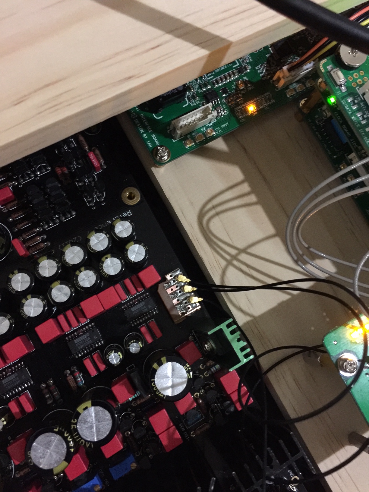

Hey Ian, do you have any spare Amanero384 isolator boards available (for easy interfacing with FIFO)?
Just an update - seemed to have fixed my CLK signal noise interference on DAC output by properly terminating PCM signals at DAC board. Yeh, don't just solder signal coax conductor into end point termination... lesson learnt.
Made a u.fl connector board with a pin header out of veroboard. Then soldered pin header straight into through hole pads on DAC board.
