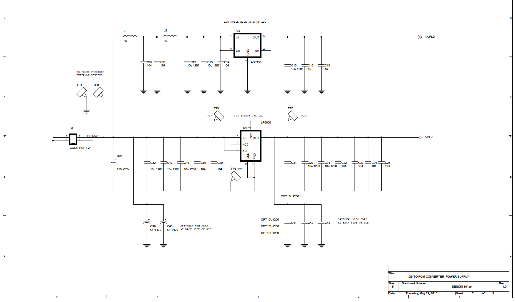

Schematic of Power supply section of PCM board
Here is the schematic of power supply section of I2S to PCM board.
Somebody wants to upgrade power supply by removing the on board LDO and replacing it with better external power supply. That's the reason I post the schematic here.
With fully understanding on the schematic, you will figure out how to hook up things together.
Basically there are two LDOs on board, one(U3) for CPLD and the other one(U4) for re-clocking. Both of them are 3.3V output. The second one can affect the sound quality, so is more important than the first one.
If you just want to remove U4, you have to keep 5V power connected to J6 to power CPLD (via U3), and hoop up external 3.3V power from TP5(3.3V VOUT) and TP6(GND) for re-clocking. For other options so on.....
Just hope there are some helps,
Ian

Hi Ian,
Thank you for sharing these informations !
What sort of supply could be better instead U4 according to you ?
What can be improved ? Noise floor ? Anything else ?
Talking about u4, are there any embeded regs on the chain of the devices before which can be a limitation as well like reclocker : clockboard , Fifo (same regs as U4)???
Why just changing U4 could be enough in relation to the others regs of the devices before ?
PS : maybe a stupid question but what about the quality of the PS of the isolator chips (your board or any isolator chip) ? Just a simple stable voltage reg is enough for such a chip?

Hi Eldam,
I always use batteries if I want to improve low noise power supply. Once system get improved, you can feel from focusing, 3D effect and the depth of the stage, mostly.
PCM board is based on synchronized logic design, so only MCLK and re-clocking section affects the finial signal quality, that's why U4 is more important.
There are many low noise power supply solutions,could be slightly different on result. You need give some try to find out your favorite. Shunt has better dynamic preference because of the Class A. But local bypassing also plays important part in high speed design.
Looking forward to your good news,
Ian
Thanks Ian,
Do you have a FR wide band and low enough impedance with your battery ? TSA7x reg are putted after with around 50 uF X7R ceramic smd caps ?
Or Avantage to the shunt because for a wide band FR range and low impedance against a less stable voltage output and noise in relation to the battery you use and very stable TSA7 regs ?
Is the stability of voltage about the pre reg a premium importance as far as it doesn't drop below the minimum needed for the low drop embeded smd regulators (and bove the maximum required voltage of course)?
To rephrase it : do a shunt stabiliser with 0.2 V drift could be good enough if the low drop smd regs are keeped as far as the noise floor is low enough ?
