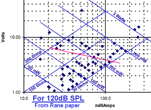

Some years back, as part of my job, I needed an amp to get LOUD for any reasonable headphone which fell into my gig-bag. I needed to know that any clipping was in the system being monitored, not the headphone amp.
RANE had data. I plotted them on I-V-Z-P scales.
120dB SPL is VERY FRIKKIN LOUD. I would approach that for seconds, not minutes. (Even so I have lost much hearing, though more from other factors.)
Electric power for 120dB SPL can be <30mW or >3,000mW. This is not very different than speakers which can be 30% or 0.3% efficient.
Combined with a 10:1 range of impedance, you may want 1V 25mA or 15V 250mA.
There is NO "universal answer". Except that at headphone powers, gross overkill is affordable. Like if Toyota sold a 3,000 horsepower blown nitro hemi for an extra $30.
A "good fit answer" for 120dB SPL seems to be 7Vrms behind 29 Ohms. Pink Line. It will put 6V 120mW in 300 Ohms, 3.6V 420mW in 32 Ohms. As the 300r cans derive from good studio practice, and the 32r market is not so high strung, the higher power in the lower Z gives more-equal output in different impedances.
I repeat: 120dB SPL is VERY FRIKKIN LOUD. I was getting paid well, and very conscious that deafness was bad for my career. I do not think anybody should risk 120dB SPL "for fun". I assure you that deaf is NOT fun.
For non-paid non-professional work, I would aim 10dB lower. 2.2Vrms behind 29 Ohms.
If you "need" more than that, PLEASE get tested. In the US you can find an audiologist to give a free screening exam. It may be more routine in places with respectful healthcare.

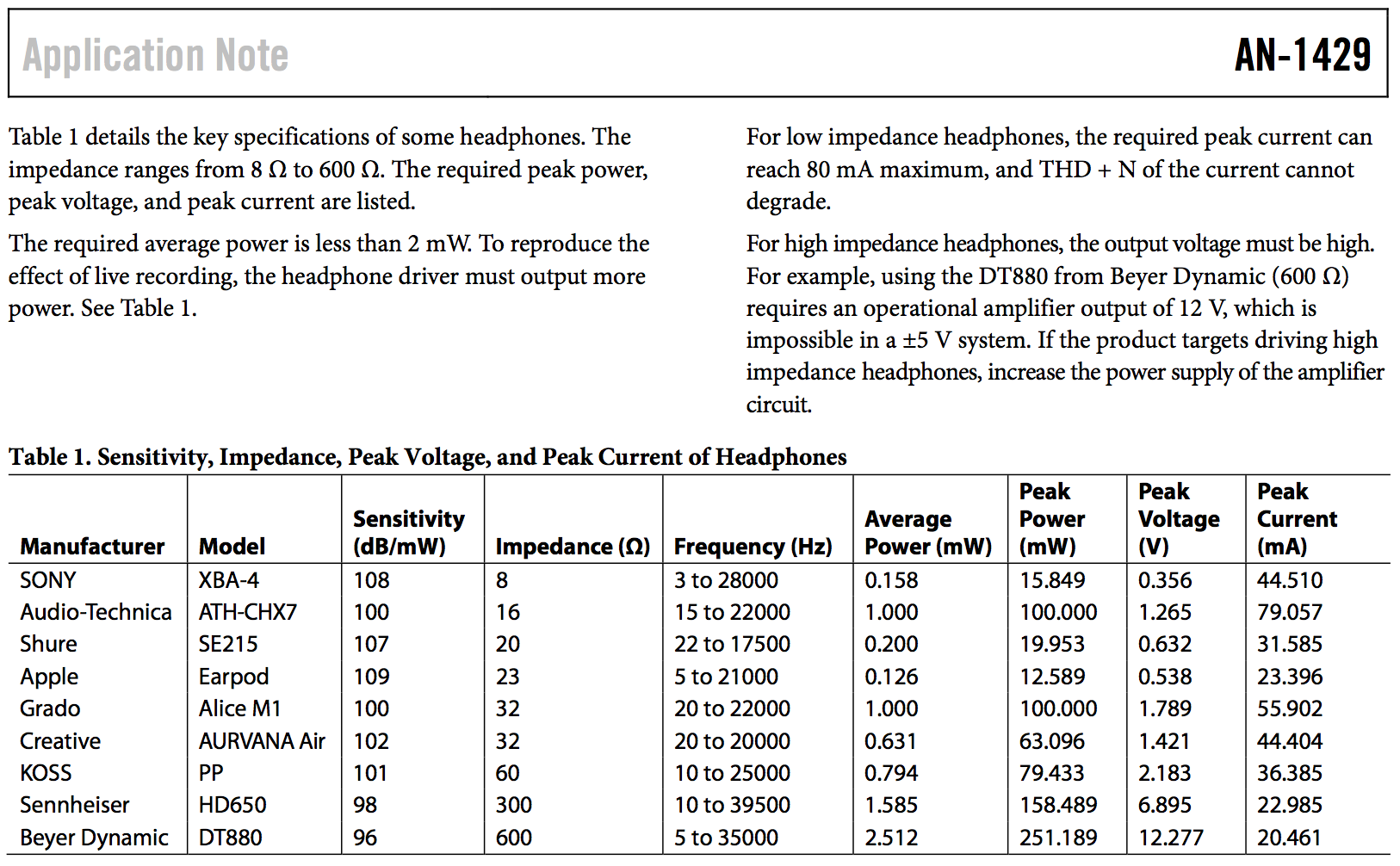

https://www.analog.com/media/en/technical-documentation/application-notes/AN-1429.pdf
Not that you directly asked for it, but on Page 17 of the PDF corresponding to the reference design is a nice high frequency impedance approximation for loop stability analysis with lower impedance headphones. At least for me it's nice for lack of proper alternatives. Maybe someone has a better approximation, I don't know.

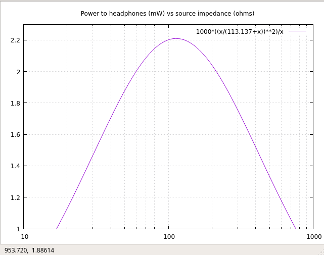

I see a switch in my future, labelled 'hi-imp' and 'low-imp', to at least separate them in two groups and keeping the volume settings manageable.
On another thread in another sub-forum, there was a similar discussion about trying to keep your hearing intact while wearing headphones, and the additional difficulties posed by varying headphone impedances. PRR told me about this thread, and I thought I might have something useful to contribute, so here I am.
Thinking about this problem on that other thread, I came to a possibly useful realization: when driven by a voltage source, more power is fed to lower-impedance headphones. When driven by a current source, more power is fed to higher-impedance headphones.
This suggests that there is an optimum source impedance that will deliver exactly the same power to two different specified headphone impedances, with no other change. I did the algebra, and found that this is indeed the case.
(In more technical terms, if you write down the equation for power delivered to two different headphone impedances, and set those two powers to be equal, you get a quadratic equation in headphone impedance. In general the equation has two different real roots, i.e., two different headphone impedances that will receive the same amount of power.)
I plugged 32 ohms and 400 ohms into my equation, the first commonly found in consumer headphones, the second apparently frequently found in recording studios. The optimum source impedance then turns out to be 113.137 ohms: a headphone amplifier with that output impedance delivers exactly the same power to 32 ohm or 400 ohm headphones, all else being unchanged.
No need to be that picky, of course; a source impedance of 110 ohms is more than close enough.
For the attached image: the x-axis is headphone impedance in ohms, the y-axis is power delivered in milliwatts, for a no-load source voltage of 1 volt RMS, and a source impedance of 113.137 ohms.
Note that x=32 and x=400 both receive the same 1.5 mW of power.
Any headphone between 32 ohms and 400 ohms will be safe to use; power only goes up from 1.5 mW to 2.2 mW at the loudest headphone impedance (which, of course, is also 113.13708 ohms, as per the maximum power transfer equation.) This is only a 0.7 dB increase, which is negligible as far as ear safety goes.
In fact, for any headphone impedance between 10 ohms and 1000 ohms, power delivered varies by no more than about 2 dB.
This leaves headphone sensitivity as the major remaining variable. If one pair of 'phones produces 95 dB@1mW, and the other 110 dB@1mW, you're still in trouble.
Downsides? The obvious one is that bass response of headphones depends on source impedance, and there is no guarantee that a 113 ohm source impedance will produce an optimal frequency response from your headphones. (But at least you're more likely to retain your hearing.)
-Gnobuddy
Referencing the 120 Ohm source impedance in IEC 61938, from Rod Elliot's amplifier to headphone adapter project:
Project 100
"This simple project is nothing more than a handful of resistors and a double pole, double throw switch, but will reduce the output of almost any amplifier to a nominal level of 5V RMS, and maintains the recommended 120Ω source impedance (IEC 61938). This is designed to suit most headphones currently made, as they are generally designed to operate from that impedance. "
If only headphones manufacturers took notice of it... Iirc, Beyerdynamic is about the only manufacturer to kind of follow that standard. Most others assume an output impedance nearer to zero when designing their headphones. And considering the sources in the real life are indeed not likely to be 120R, who can blame them ?
Sennheiser in particular has headphones with huge impedance bumps at about 100hz. Some of these have a nominal impedance of 64r or 150r. They turn to mud with a 120r output impedance.
A suspicious coincidence. 😉
My neighbour's cow weighs 1355 lbs; my wife weighs 135.5 lbs. Exactly one-tenth as much as the cow! A suspicious coincidence! Perhaps the cow is really ten women disguised in a cow-suit?
More seriously, if the IEC standard had been 113.137 ohms, I would agree without question. 🙂
As things are, I need to see some actual facts before I believe there is any deeper significance than mere coincidence at work. A whitepaper describing the behind-the-scenes decisions that led to the IEC headphone source impedance standard, for example, or any official IEC documentation that says they chose a non-zero source impedance for headphone amplifiers in order to flatten SPL variations with changing headphone impedance.
-Gnobuddy
