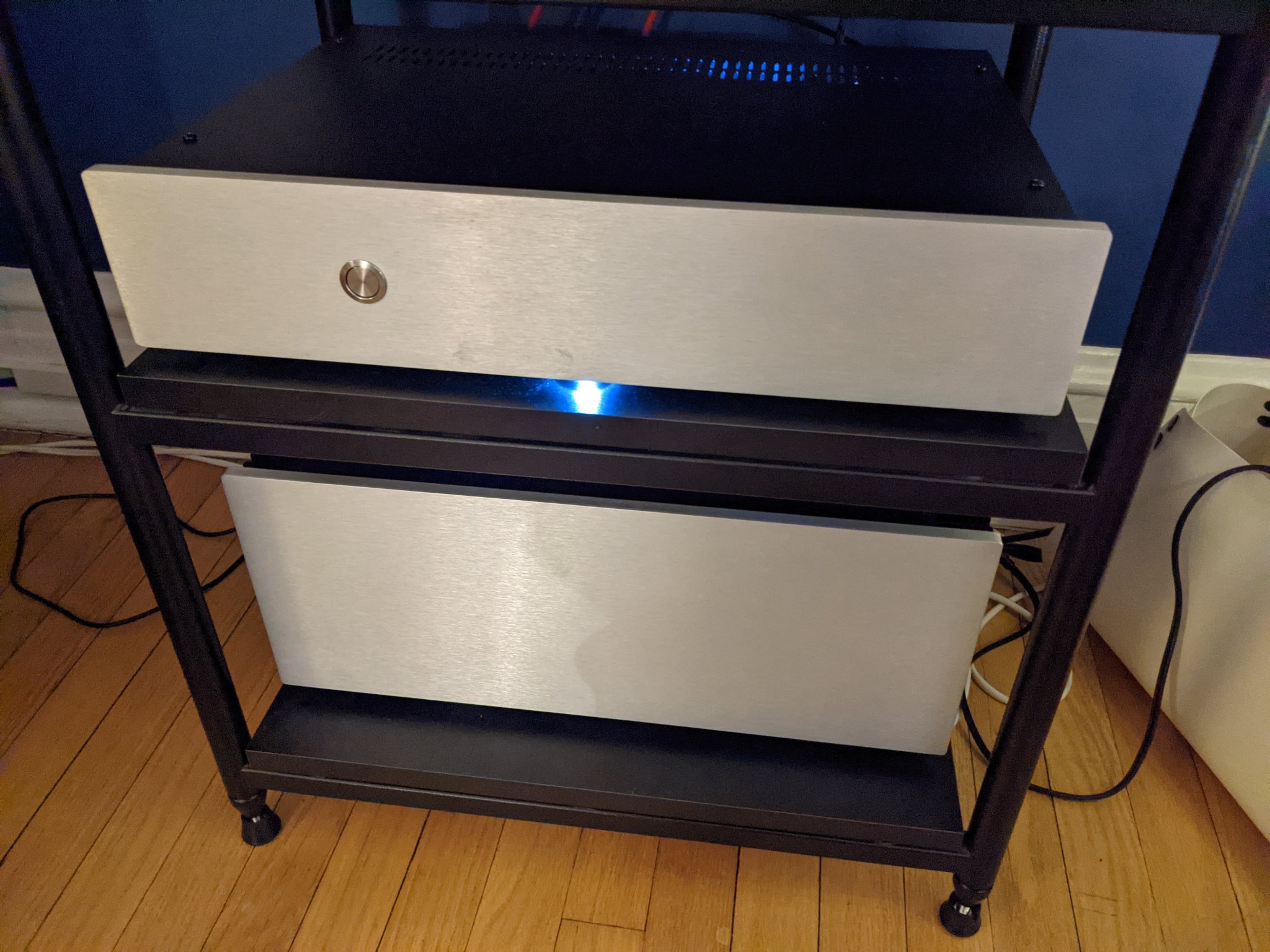

Once you have extracted the broken bit, I‘d recommend to eitherOk, this is all very helpful. Thanks everyone. My game plan will be:
-Knock out the caught bit with a hardened finish nail
- pick up a drill press and figure out a secure clamping scheme
- pick up a bit sharpener
If that all goes wrong then I can order a fresh front panel and I'll commit myself to back panel controls
Feeling frustrated tonight but I think I have a path forward. Fresh cup of coffee tomorrow morning should help

Heres a photo of the finished product
Now that I've figured out how to get through the front panels, I'll be adding a matching switch and LED to the power amp. Maybe an attenuator in the DAC too so I can run my whole rig with two boxes.
