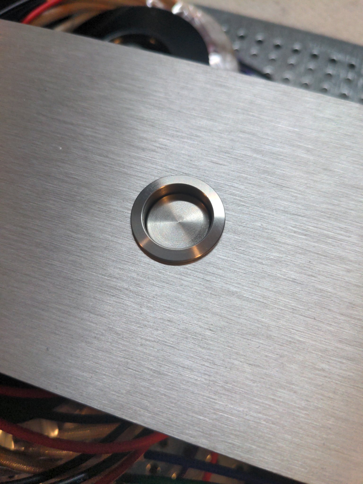

This power switch is one of many that accommodates a 10mm front panel

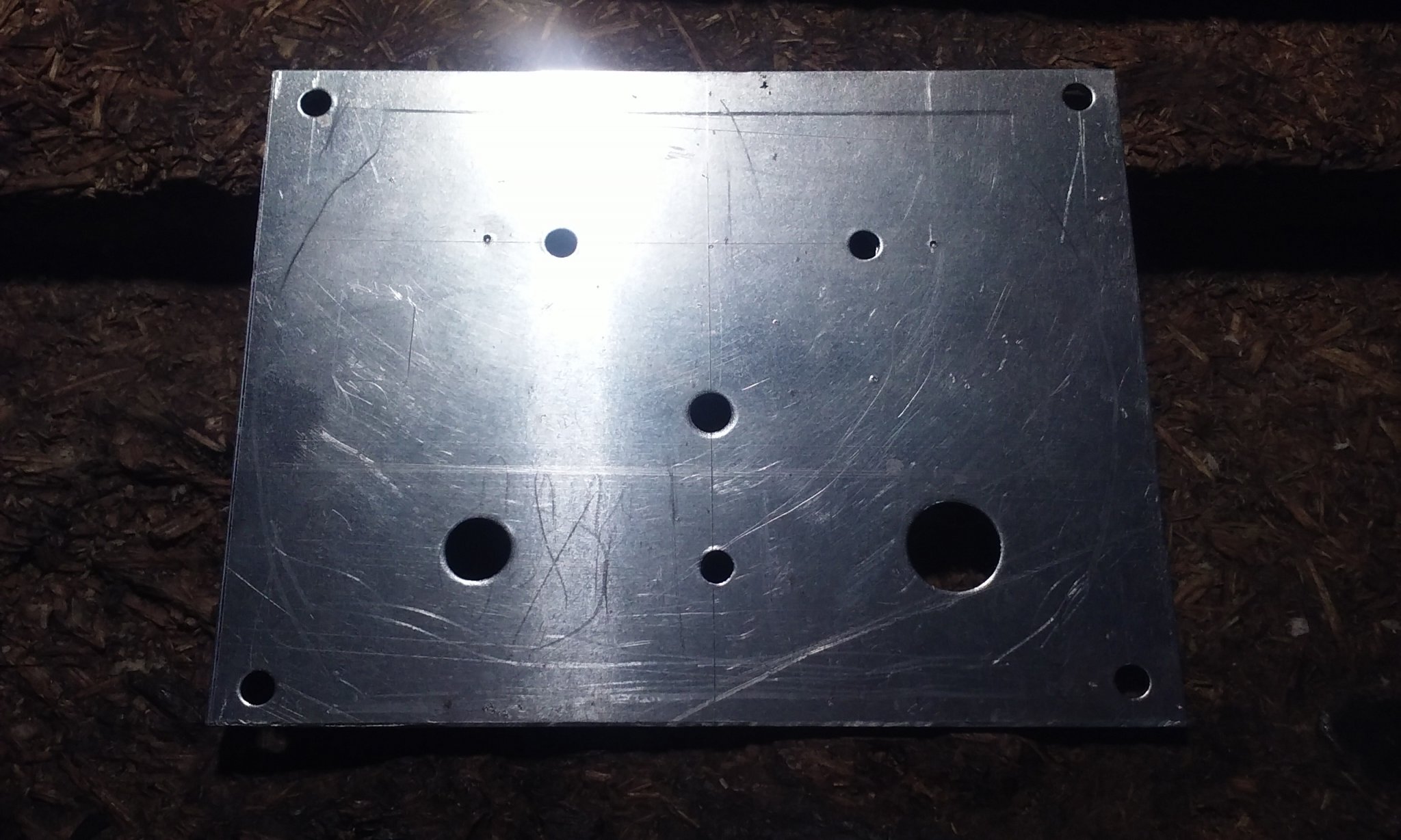

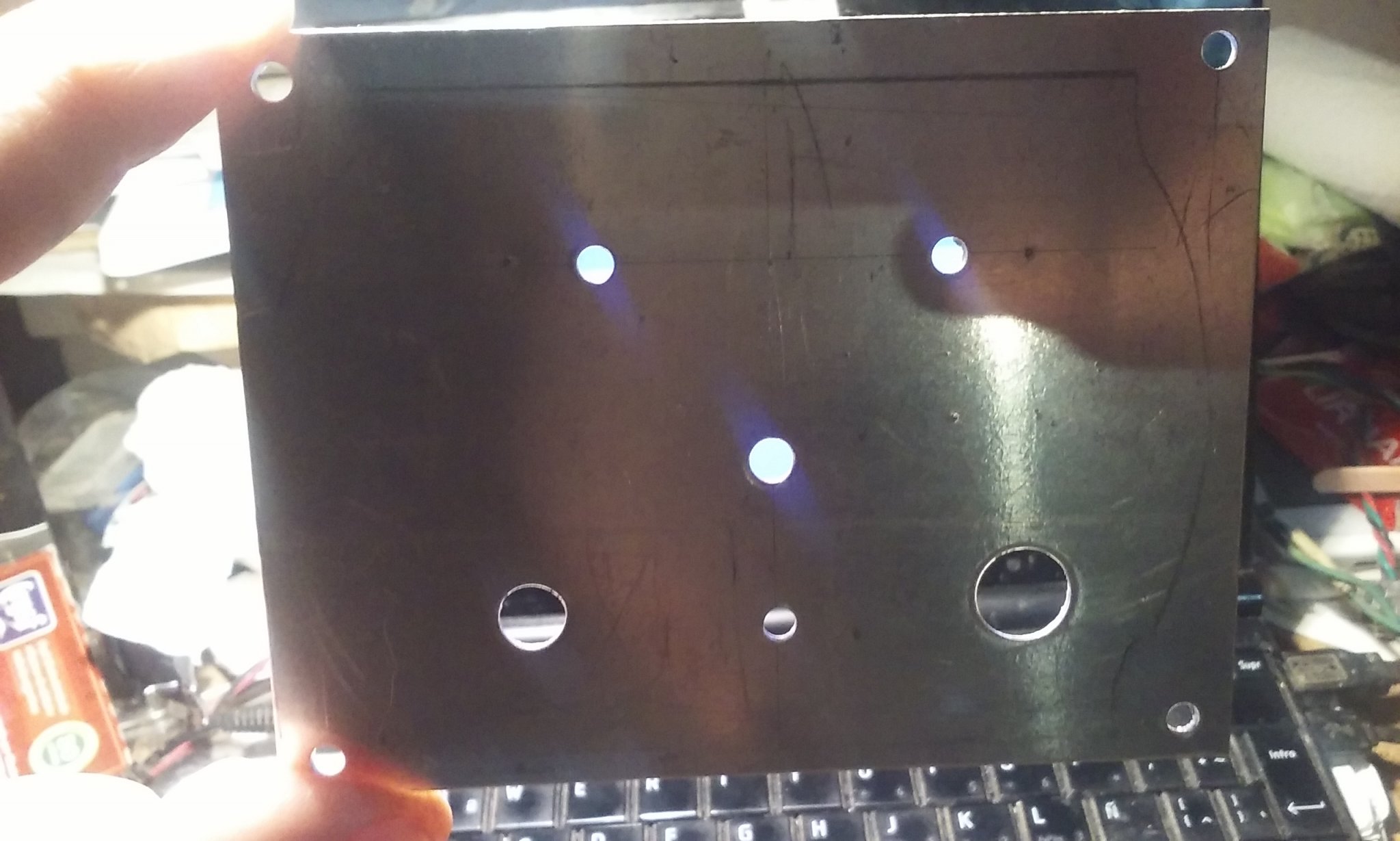

Just by chance, at this very moment I´m making a small 12V 16W powered cabinet (sporting a 6" ex roof mounted background Music speaker) for my Grand Daughter out of spare MDF and aluminum leftovers, junkbox speakers (boombox grade) and some TDA2003 which are getting VERY long on the tooth he he.
Power supply is a 12V 2A ex-Router wall wart, every element used here saved from the corner trash can destiny.
And this is the "chassis/heatsink/front panel"
Suffering from the typical Tech/DIYer OCD, "I never junk anything",hate landfills with a passion, but try to repurpose stuff, and in general turn everything left over into some kind of mini (sometimes not that "mini") sound reproducer, which I later gift to friends and Family or donate to some School or Church.

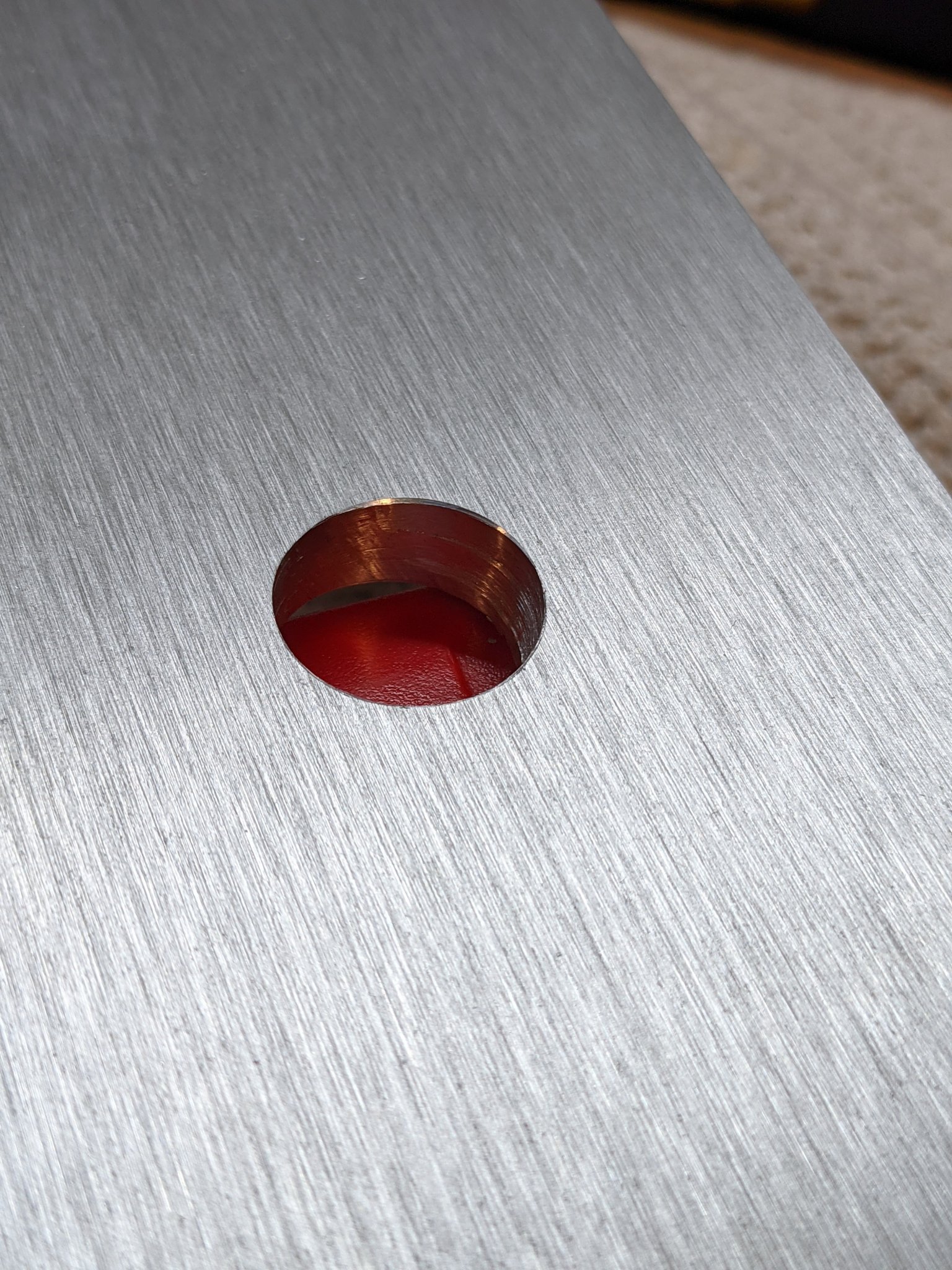

Drill press, lots of oil, with cobalt and stepped bits did the job. Stepped bits ended up being the star of the show.
