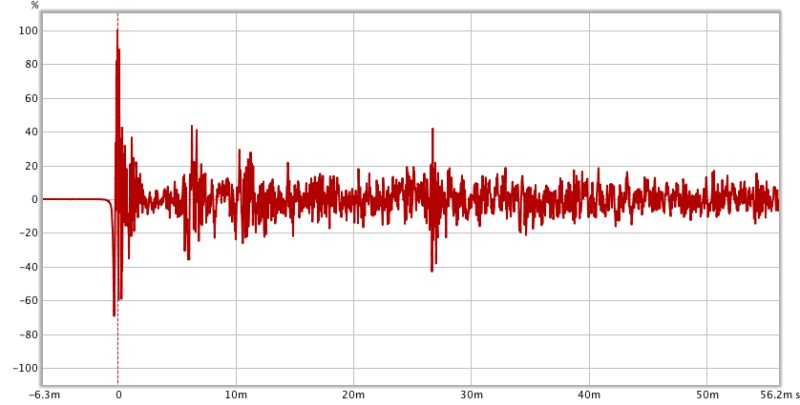

Fixed a bit of my sweeps with some light EQ, and took another swing at L/R sweeps for DRC.
Not interestingly, the impulses got messed up by the initial EQing.
Not so clean as before...
anyway, I plugged that into DRC and made some filters. Didn't have time to listen to that yet... more to come, then.

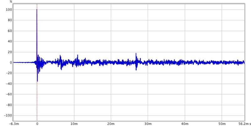

Got JRiver working nice for a change! (for how long...?)
Didn't have a chance to do any sweeps yet, but had time to sit down and have a listen.
Progressing!
Having an initial clean up with some light EQing before DRC was probably a very good thing, because when I applied (MINIMAL filter) DRC, it all opened up and soundstage expanded very nicely! What was, for example, an intimate recording that sounded like the performer was in a dull room, playing in front of me, moved to expand into me being in a intimate concert, with a lot more life to it.
Trying to describe it... without DRC, I was listening, sitting on the stage, to the recording from on stage monitors. With DRC, I was moved back to the parterre of a music venue, listening to the recording with more depth and life... more like hearing the big picture, but I could still pinpoint where instruments were.
It's not all perfect yet, the highs are nice, but it is lacking some meat... grunt... to make it a truly immersive experience.

I took a quick measurement, but there was so much noise around, I couldn't trust that. The line was jagged, but following the curve I had set initially.
I am close... I went through a bunch of song I know very well... it's almost there. I heard things I didn't hear (or didn't know were there) in a long time!
I already had a smile while listening, closing my eyes, the image is there, the soundstage is there, but it's missing just a little grunt to get to "Yes!!!" I did apply your knee at 1.5Khz to give it some air, now I'm thinking of another between 200 and 400 to add fullness. It's late now, so that will have to wait until tomorrow.
I'll see if it's a limitation from my speakers, but I am careful. I make sure the W8-1772s do not see low freq and make them working above 80Hz only. I have the pair of subs to get lower.

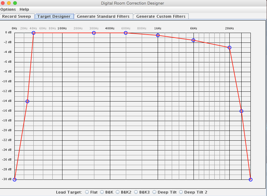

I need to experiment more, but in DRC, I need to keep the highs correction to a minimum, or it kills the imaging.
Is that a conclusion without turning down the mid control slider?
In that case turning up the high correction also affects the mid frequency window. So trying a longer window in the high frequencies only would mean to turn down "Mid Frequency Correction Strength" to have a longer window at high frequency only.
Basically you only set a window at 20 Hz and 20000 Hz. And the mid slider determines which curve you are using to determine the mid frequency window length.
Remember this graph:
By turning down that one to for example 0.9 you get a longer window at high frequency while the mids will be corrected with a shorter window.
Only turning up the high frequency window will result in a longer mid window as well. Don't go overboard, a small difference can get very different
results.
What I do is get a clean impulse. Choose a target and confirm with a REW measurements it is getting me what I want.
Then after that, play with different window settings to see what I like. The target correction will be about the same, only play with window lengths.
But I calculate back to how many cycles I get at the frequencies of interest to get a grip on things.
So if you like the minimal settings, play with the sliders till the mid correction length is still the same at ~1 KHz while using a longer window
at higher frequencies.
The table you showed earlier does show actual window lengths in samples for each channel:
This example shows the correction windows for the minimal template...
If I want a longer correction in highs only, I move the slider from 0 to say 8 and the middle slider from 33 to 32 and get this:
At ~1000 Hz I actually have a shorter window than the minimal template, 201 vs 217 by moving the middle slider only one click from 33 to 32!
You see the high frequency window getting longer at 4000 Hz and above.
That's how I play with it anyway...
