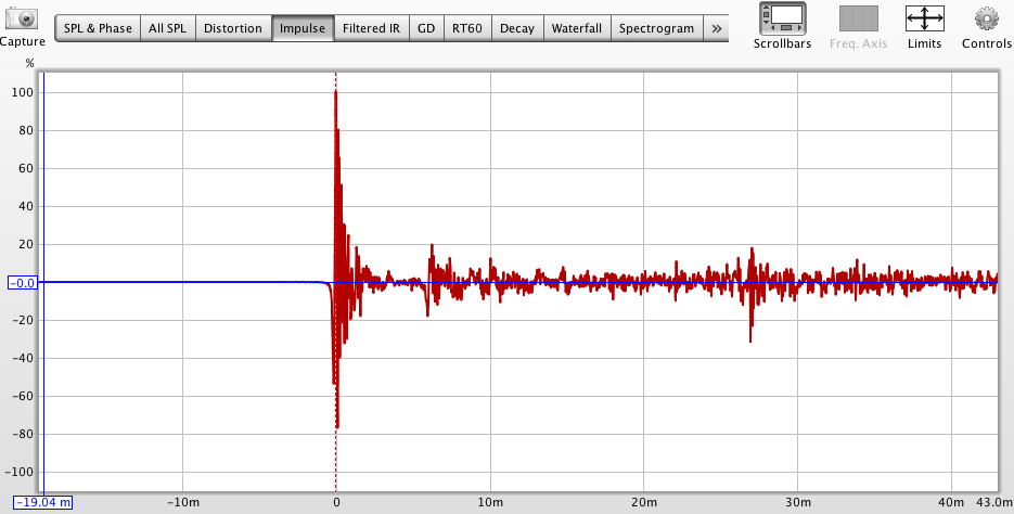

In my attempts to discover where the double peaks origin, I moved one W8-1772 speaker cabinet upstairs, to the better and smaller room. It's a classroom / recording room.
Made a couple sweeps in REW to confirm that the double peaks do not come from the speaker themselves. To my relief, it wasn't. I had a much nicer impulse there.

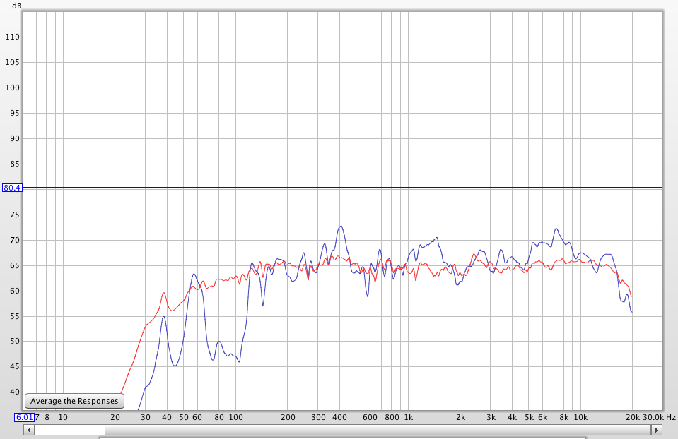

Here's the before (blue) and after (red) convolution of the W8 in that room. As you can see, it worked, and you can imagine that it sounded pretty good too.
So, I'm happy to say that I have progressed.

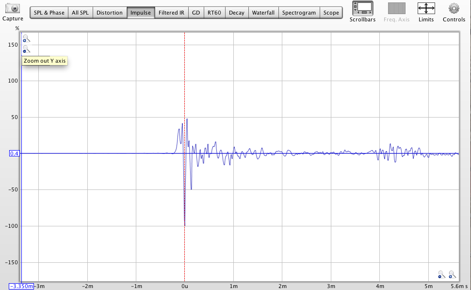

There is a matter in the impulse still, I have a wobble at the start of the impulse (hard to see zoomed out, but clearly there when zoomed in). I am not sure if it comes from the W8 construction (having a whizzer cone, or being an 8" compared to a 3") or something else.

That's a pretty big improvement. Congratulations.

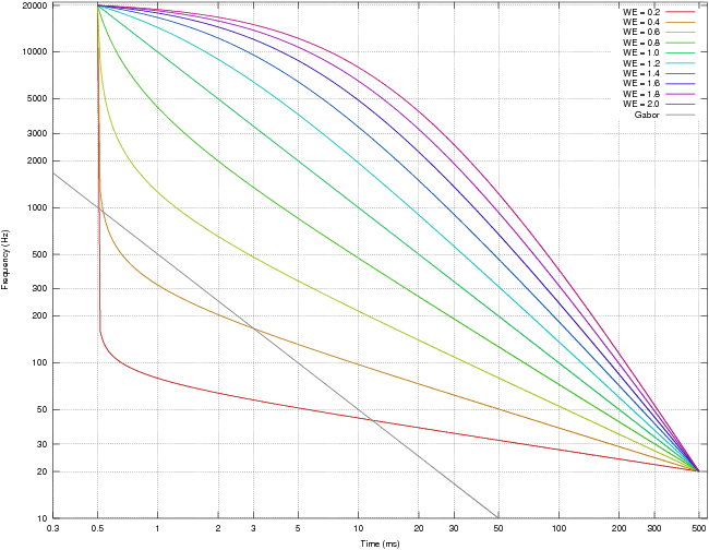

A legitimate question, one that was bothering me before I started with DRC. It's true the DRC procedure calls for a single listening position to correct the impulse. You have to keep in mind that the time frame in which it corrects the response is actually very short in higher frequencies. Similar to correcting with EQ for a gated measurement but a shorter gate than most would use.
The "Normal" template corrects only 0.50 ms at 20 KHz and is considered quite long by many using DRC. Gmad corrects 4 cycles from 20 Hz to 20 KHz and has great results. 4 cycles at 20 KHz is just 0.20 ms
What you need to get satisfying sound depends a lot on what speaker you are correcting.

If I correct using the normal template I get focussed sound on my listening position. But if I move a bit to the left (more than about 30 cm) or right the image snaps to the closest speaker.
But if I use a custom template, using the same 50 ms at 20 KHz but less than the 10 ms the normal template dictates at 1 KHz I can move more than 50 cm and keep the image right in front of me. As you can imagine I'm still playing with the windowing to get optimal results.
So we can't predict what it will do for other speakers without trying.
It can be a number of things but that Whizzer cone is high on my list of suspects. What does the inside of your speaker look like? Does it have lining like felt on the inside walls? It wouldn't explain the wiggle before the main peak but anything we can do to better the impulse, the less DRC has to correct.

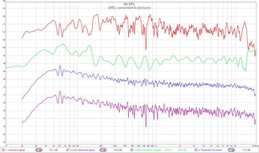

I figure a picture says more than thousand words, let's see a simplified presentation of what DRC actually does.
For this example I used the left channel of my Line Arrays. It does not show everything that's going on but makes it a bit clearer to see what it is doing.
A side note: the imported correction file isn't exactly the same as the file used in the measured signal, but close enough for this example.
From top to bottom:
Rough measurement taken at listening position. (base signal)
Impulse correction from DRC imported into REW (actual correction)
DRC correction applied to the rough measurement (Red signal + Green signal)/2. (predicted response)
Actual measurement of the corrected response at the listening position using convolution. (actual measurement of response)
It shows that it does a lot of corrections to the frequency response that would be very hard to replicate with (P)EQ. This simple graph leaves a lot of the factors out like phase correction etc. but it clearly demonstrates it's power. The "Maximum correction Boost" in this example was high at 9.25 dB. Not recommended for use on a single point source. But I use DRC to shape the response of my 25 driver/side Line Arrays.
It clearly shows there aren't any boosts at small dips taking place, even with this large Maximum correction Boost factor.

My experiences regarding single position measurements are consistent with those of wesayso. I tend to think of multiple position averaging as a low tech means to achieving frequency dependent time windowing. The size of the listening area in which the correction is valid with DRC depends on the windowing length. I'm happy with the results I get with a windowing length which is still short enough to avoid artifacts from any listening position.
Hi wesayso,
Thanks a lot for the informative and educational post. Your results look excellent to me.
I've been using Behringer DEQ2496 myself. It has an auto EQ function to correct the frequency response (for the location of mic). It uses 31-band graphic EQ for this. I believe there's no correction of phase shift by the room etc. When done, it leaves many adjustments here and there across the whole spectrum, some of them are quite severe.
And if I moved the mic, there'd be a different set of peaks and dips right away by very large amplitudes and by a mere foot, let alone 1 meter.
I don't like the sound by such 'correction'. It sounds clinical, sharp, very "hi-fi" in the initial impression, but soon I feel it unnatural and fatiguing. I've tried several times, it has never satisfied me. I guess it fails in the timing (phase).
The correction by impulse response makes more sense, considering the phase issue. I did a quick browsing on the web site of REW. I saw measurement and EQ, but I didn't find how it corrects the phase shift. I think it does, but how? Sorry if it's been mentioned and I missed.

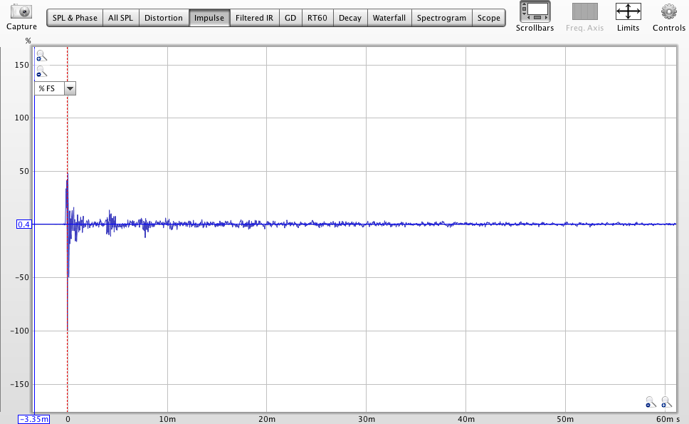

Found the double peak!
After trying a bunch of combination, change amp, isolated the feet of the speakers, etc...
The double peak is caused by a reflection.
Right behind the couch, at 1.3m, there is a staircase with concrete wall. On a hunch, I placed the mic ON the seat of the couch, using the back rest as a shield to the back wall reflection... that worked.
Then, I placed a mic back at ear level, but using a cardiod mic, so it wouldn't listen to the back wall reflection as an omni mic would.
This gave me a much nicer impulse. When comparing right and left, it's almost clean. In stereo, there is a little shift and I'm sure if I moved the mic slightly, they would align.
Pressed for time, I used that to generate a few gentle filters with DRC Designer, which helped the sweeps but still has a lot of work. My room, being a concrete block, has many of those reflections and probably won't be able to get a perfect curve. Also, I feel the sliders for a custom filter are a bit crude, not giving feedback as to what's really happening, so I am thinking to switch to the original DRC software... and learn it!

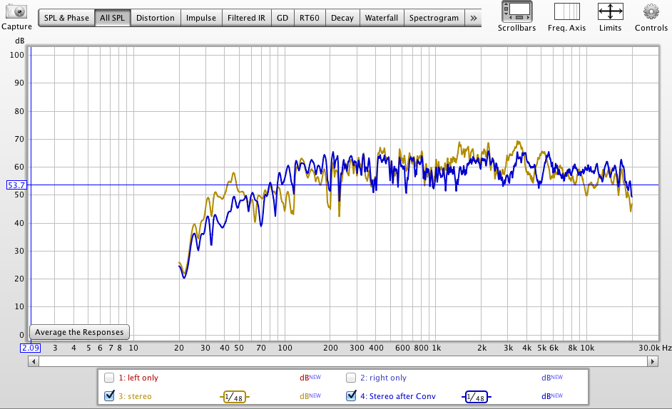

So, here are some new graphs, showing a single speaker impulse and the sweeps, before and after convolution.
Baby steps....
My oh my! Never have I seen that loud a reflection before. Still it puzzles me that it wasn't seen in your first uploaded file in the left and right channel. It was there in the stereo measurement though. Not sure what happened there...
To understand the custom DRC Designer settings you can look at the variables it ads to the generated batch files. That's how I play with it. Tiny setting changes can make quite a big difference. The difference between the Normal and the Soft template can be seen. Only windowing and boost factor differ between those two. Eventually it will be better to use DCR as is but it requires more tools or scripts to get everything done. I'm working around DRC Designer by using a custom template as base. It always uses the Soft template so I put my own version there. That way I can easily play with windowing settings using DRC Designer.
Go over the documentation of DRC to get an idea of what does what. It's actually quite scary as there are way to many settings to play with.
Afterwards I looked at the results and once I softened up all narrow EQ suggestions (by deletion of that filter while trying to stay true to the general target) it sounded much better.

That's the actual DRC process, not the variables.
When running custom settings in DRC Designer look at the file: drcWrapperRunDRCRightcustom_44100.bat
That one contains the actual varables that DRC Designer is giving DRC to generate the filter.
Here's one of mine:
In this file you can see I chose a long upper frequency window but bringing down the EPWindowExponent variable to 0.88 instead of the usual 1.0 makes the window at say 1000 Hz way shorter. It could work for you to, seeing how the impulse is a bit time smeared in high frequencies due to the whizzer cone.
With these settings I have an even longer window than the Normal template at 20.000 Hz but shorter than the Normal template at 1000 Hz.
I took that wisdom from the multiple WE graphs in DRC's documentation:
As an example, if you like the tight imaging from the Normal template but the overall sound of the Soft template all you'd need to do is move the left top slider to 22% (EPUpperWindow=44) and the middle one to about 25% (EPWindowExponent=0.88) And leave the bass slider low as in the Soft preset (MPLowerWindow=33116).
You could raise the Maximum Correction Boost to 6.02 dB... play with it a little based on what you think/feel of the standard settings of Normal and Soft.
Move a bit from side to side while listening. Does the image stay focussed? Just something that worked very well for me, your case may be different.
But before all that, make sure you have clean measurements to start with!
Here you can see that varying the WE variable (middle slider in DRC Designer) can change the effect on the mid frequencies quite a bit.
