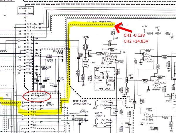

Sorry, the Power supply problem is just a heat problem and would have failed further down the line. There was a more fundamental problem with CH2, which I finally traced to a short (80ohms) between the 15V power rail and the CV test point for CH2. Turned out after removing connecting board and the resistor from the CV point that it was a short in the connector. Unsoldered, cleaned, check components all ok now, so who knows what caused the short. But obviously the valve heater cct has heat problems. It heats 4 off ECC822's in Parallel
So in summary you have all been very helpful. I'll look into using your ideas to alleviate the heat problem....
(None of this is helped by Drawmer not allowing circuit diagrams & service manuals to be shared/brought.....Not as if current design, and I'm sure anyone could reverses engineer it without a diagram.....)

Now we know more...so 4 x ECC82. That is 4 x 12.6V 150 mA. That is 12.6V 600 mA in total. This means you could replace the old 7812 for 2 new ones and have ach 7812 feed tubes and halve the dissipation per regulator.

Now as detailed as I try to help out so vague is your feedback regarding what you exactly did to fix it (I guess: cheapest solution 78S12, removal of D12 and R6, a new 2200 uF cap and the FLIR in the drawer 🙂).
its all back as it was, but with 78S12, and high wattage R6. I tried it just without R6, and it seemed to work fine, but of course will have twice the current flowing through the 78S12, hence heatsink gets warmer....
I think your solutions ref LDO,reducing volage,removing diode and R6 all have merit.
