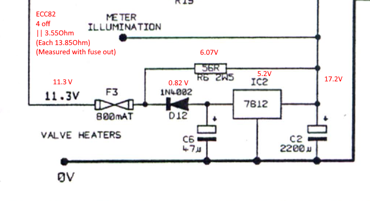

Drawmer 12V Valve heater circuit
Can anyone please enlighten me as to the purpose of the 2W 56ohm resistor in this cct? (The LED illumitators also have a 2W56ohm resistor in series)

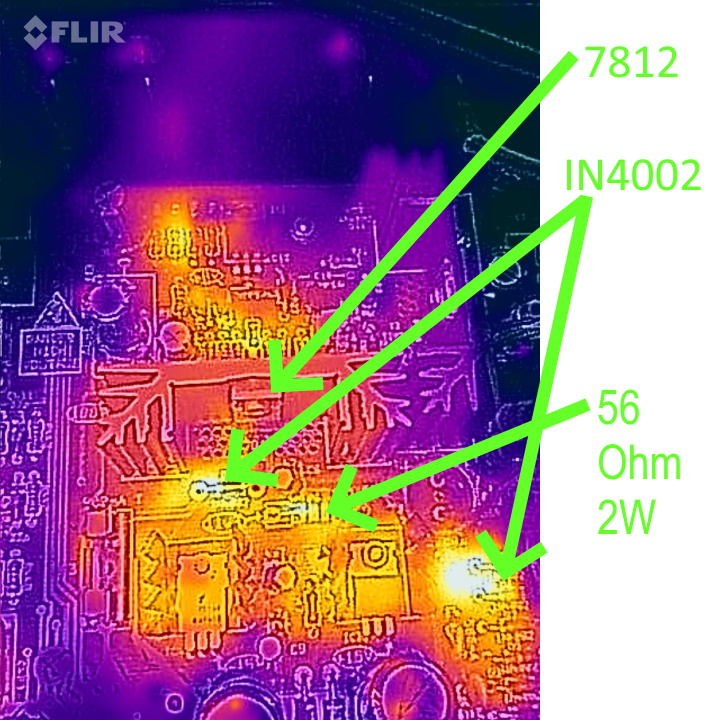

Also IN4002's getting pretty warm, would a higher wattage diode help?
Obviosly 7812 is maxxed out, especially when tubes are cold (heater resistance I believe are 15ohm cold, 80ohm hot)

as you noticed, the heater resistance on a cold valve is very low. This can trip the max current detector in the 12V regulator, which therefore never "starts". The 56R is a path for initial current to flow, at certain point the 12V regulator kicks in and regulates the output.

"The resistor is there to reduce the dissipation of the 7812 by acting as a bypass for some of the heater current (but not enough that it doesn't still regulate the voltage). It probably makes the difference between being able to get away with a 7812 or not at startup.
The 1N4002 is rated for 1A at 75'C ambient. The 7812 is capable of a bit more than this before going into current limit, but unless the 4002 is running really hot, it's probably fine. At 1A it will be dissipating about 1.1W but into 80R load it should be way less than that. You could go to a 3A 1N5402 if you wanted, but it has larger body size and more importantly, thicker leads."
"Cheaply" is the correct word. It is simply outdated/bad practice done for the wrong parameter when applied today. Today one could have chosen the right rated part straight way. Don't understand me wrong, it was done in the past as there was no other choice than 78xx which are 1A limited regulators not able to cope with low cold resistance filaments. Let's forget the habit.
To reduce the heat one could remove the 56 Ohm resistor, remove the diode and use a jumper wire instead, choose an LDO and drop voltage before the regulator if that is necessary. A MIC29150-12WT will be able to pass 1.5A, a MIC29300-12WT will be able to pass 3A. I would choose the latter. For now the most interesting is how many Volts are at the input of the 7812. It would also be beneficial for tube longevity as 11.3V is too low for 12.6V filament tubes. 12V would be OK.

17.2V, weird tho I've seen i/p voltage at around 19V...

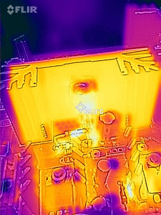

But steady state attached.
Also heat map without resistor.
Without diode would get hotter? (no voltage drop across diode)
Would be difficult to get resistor in, unless I put before the rectifing diodes (A pair of IN4002's) AC tho - 0.64Ax4,2V to get down to 13V is still best part of 3W. (6.56Ohms?)

3) They don't seem to get overtly hot (Hang on maybe they do.... picture before anything changed)

5. 17.2V, weird tho I've seen i/p voltage at around 19V... This could mean the cap being flaky
6. Without diode would get hotter? (no voltage drop across diode). If you mean D12 yes that one should go when R6 is removed. Then D12 won't generate heat anymore, its part then goes to the tubes 😉

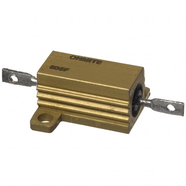

7. Would be difficult to get resistor in, unless I put before the rectifing diodes (A pair of IN4002's) AC tho - 0.64Ax4,2V to get down to 13V is still best part of 3W. (6.56Ohms?). That sounds right, yes before the rectifiers. Make that a 3.3 or 4.7 Ohm resistor of the right wattage. Those chassis mount resistors in heatsinks seem a good choice to get rid of the heat.
8. In this case I would use Schottky diodes to have less heat by the diodes as I would be dropping voltage with the 4.7 Ohm somewhere else anyway. The trick is to divide dissipation and get rid of it to spots where it can't hurt.

We calculate worst case and the OP needs lower Uforward for less heat. Please have a look at the FLIR pictures what causes heat.
Since both Si and Schottky diodes have lower Uforward when hot there is no debate nor a show stopping phenomenon don't you agree? Which one of the 2 will generate less heat?
