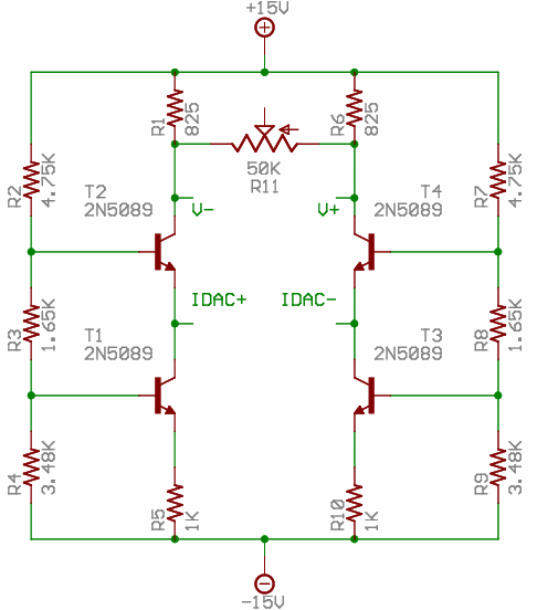

Drawing of I/V converter
I'm a total newbie at such things, but I thought this would make a fine I/V converter for my new DAC. The DAC output is fed into a virtual ground between T1 and T2, trimmed to 0.0V. The current source T1 draws 10mA and V+ and V- sit at 6.75V steady state. The DAC output swings +/- 1.2mA giving a voltage swing of 2Vpp at the voltage terminal. R11 is the volume control.
The voltage swing could be brought up to 4Vpp by doubling R1/R6 and using a 5mA steady state current.
A few weeks ago I thought I might like to try the I/V stage from the Pass D-1, but it has too many parts (and MOSFETs) for my liking. I believe this design retains the advantages of the D-1 design without the overkill IRF610 MOSFETs.
Please post your scathing criticisms here. I already ordered the parts for it so I'll get to see it it works soon enough.

I searched Google for "decent transistor" and didn't come up with anything. Maybe you can suggest something with the lofty specs of Ic > .0112mA and Vce > 10V? I just picked a decent one from a 2Nxxxx spec table.
How about something like Zetex 869? Geez $67 for 100! Okay okay, it's a lot less than the 4xPCM1704U-K 🙂
As for biasing I could bias with diodes or what-have-you but I calculate the current source should be within %0.1 with 1% resistors. What's the advantage?
LEDs make good references. Cheap and quiet.

Don't pick nits. I used the symbol b/c its in the library. The attenuator isn't a pot, it's a stepped attenuator with 24 positions, where V+ is connected to GND and V- is connected to OUT. Sound backwards? Think it over for a while.

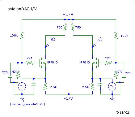

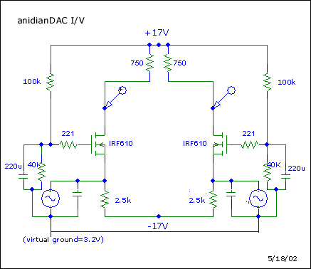

The design is for a DAC with virtual ground between 0v and AVdd. You could use it on a DAC like the 1704 by making the circuit's "virtual" ground the real ground and adjusting the trimming resistors appropriately.
The diagram is confusing...here is an update:
