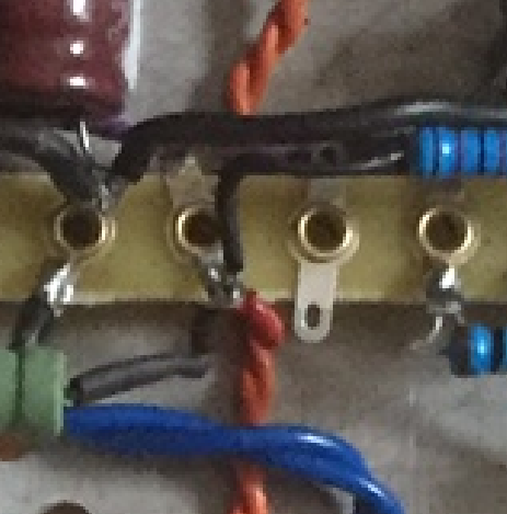

Whats happening with the heater wiring on the input tubes?
The photo seems to show the anode of the one input valve connected to the heater wiring..I guess its the photo the orange wires are the heaters correct?
The yellow capacitor connects to the anode of the tube and the anode resistor then to the orange wiring..
On the other side this doesn't happen because the heater is looped from the other input valve..
so what is happening at this point?
Check both the heater wiring and trace the supply from the 10K to each anode resistor.

Trace choke to 10K>>>>to 47uF>>>>to 82K on each valve>>>to anode.
There should be no other connections. The anodes of the input valves to the yellow coupling caps nothing else.
Make sure the 47uF is the correct way round negative to Gnd. (+ to the 10K).
_________________________________________________________________________________________
Where is the centre tap of the heater winding on the transformer going its should be Gnd?
You have two orange wires with a centre tap shown on the drawing which goes to ground this gives 3.15 from each orange wire to Gnd.
Looks like the black wire in the middle of the two orange wires..
__________________________________________________________________________________________
I assume the large green resistor in the middle is the 10K? its should not be resting on the wiring..just for interest.

If the above is true,
You have grounded your G2 supply for the EL34's through the heater winding for the input tubes creating a volt drop across the 10K and then modulated it with 50Hz.
So if the correction works its 2/10 see me after class and do 100 lines I must not connect my B+ supplies to ground via the heater winding..😀

sorry folks heater wire not connected to anything apart from heater🙁 choke to 10K to 82K to valve meters out the same each side on resistance. I checked the valve that was in right side for internal short but nothing meters except heater pins. what i did do was trim some ends on the right input as I noticed they were close and the socket moves. i also replaced input cable so now I have left channel working. Right channel still dead.
Its a sneaky red wire coming from the positive of the 47 uf cap ! I did find a short, the leg of the 220K was touching a ground. That set the left channel working but distorted so I swapped input valves and right channel started working and left went dead so swapped both input valves and right channel still working left channel ded then found pin on RCA of new signal leads had broken off so currently replacing RCA on Chassis as I can't get pin out of old one and I guess another shopping trip for another new input lead!
