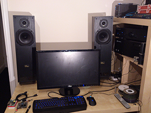

Although it’s not relevant to the thread as such it may be better if I out line my long term plan (in planning stage for a long - long time lol)
At the moment this is my desktop setup
Obviously a bit OTT but I love TDL’s ..what can I say !

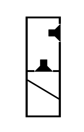

1st The aim is to replace the TDL’s with a pair of Dave’s frugal Fonken’s which I’m going to extend (heighten without adding volume) to bring them up to my eye/ear level.

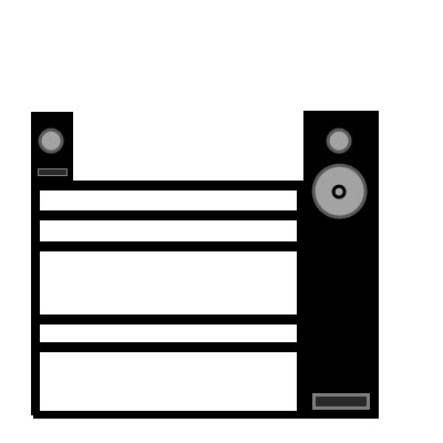

2nd Take the TDL RTL’s and make a pair of side wall cabinets to replace my bookshelf which has the rear left/right’s just sitting on a shelf ( a pair of Q 10’s) With a pair of thre BMR's as Mid-Side speakers
And use the BMR’s in a configuration that sounds as good as it can be.

And then there’s room for 2 more of the small satellites above the TV for the front highs.
5th and final if I don’t die of old age, is to use the old drivers from the TDL I modded and make a centre, possibly one mid with tweeter’s either side .. that’s way in the future.
