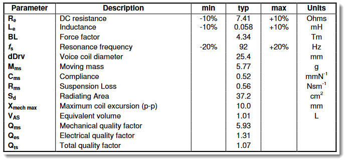

Hi Scottmoose, I have 4 pairs of these, which a friend gave me. He had a project to make a small sound bar for his caravan TV but was kibosh-ed by her indoors on the basis that it wasn't aesthetically pleasing to the ( her) eyes..

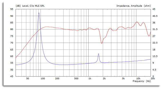

FWIW I actually spotted what drivers they are from
the response and specs given in the first post.

About 3 litres per driver sealed and stuffed is the way to do it.

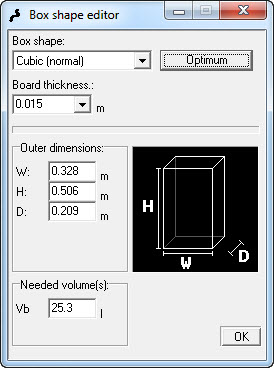

I have the drivers on my desk, I have designed it as you suggested around 3 ltrs, it actually works out at 2.84 ltrs. For the desktop I designed it so the driver is at chin.. ish level as most desktops are stumpy and the sound tends to aim at your lower chest.
Bought a ECM8000 of eBay for a tenner, already had True RTA lvl 3 from modding the RTL's.
Bought the Birch Plywood (Planet will be happy to hear that).
Have an old set of 15mm MDF shelves dismantled at the end of the workshop.
Lining them with the floor tiles.
So going to build in both materials and then test.. go from there see how they turn out.. the funs in the trying I think ? 🙂
