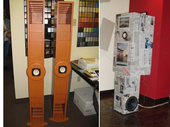

Double Fostex FE103E horn
Anyone recognise or know who built these (on left!)? I'd love to give this a go; I'd been thinking about possibly doubling the factory design for a while, then accidentally ran across this picture on another forum (I think, but I can't remember where!), so it's nice to know someone's done it before.
My slight concern though is the compression chamber, or rather, the two passages leading from it: the layout would seem to dictate they would be directly behind the driver, which shurely isn't the best plan? Or am I worrying over nothing here? I remember Terry Cain mentioning it's possible to double the factory 166 design with good results, providing you keep the original compresison chamber volume, or only fractionally increase it. I haven't simulated these in MathCad yet (I'm sure I don't want to know!), I just fancy giving it a try for fun.

I remeber these on the fullrange driver forum. They obviously get thier looks from the Cain&Cain line, but they were built for a contest in Toronto a couple of years back. I don't know who built them but it was not Terry Cain as far as I know. I believe internally they are just two fostex recomended cabs stacked on top of each other. I could be wrong about that. There is a lady on the fullrange driver forum who was at the contest (best enclosure for the fe103), she might know more.
Joe
That is my recall on it, except the gig was in Montreal... i have a link somewhere.
dave
I didn't think they were Terry's, they did look like a mirrored standeard 103 Fostex box; although they were obviously inspired by his large Double BEN designs -now he's got an equivelent product out, but using the 108ESigma, so there seems to be merit in the idea of the smaller driver with a double-horn. I've asked over at the full-range driver forum too, so it'll be interesting to see what turns up. As I mentioned in my previous post; I'm curious about the compression-chamber and throat positions leading away from it, and how to optimise these. I can't resist: two FE103Es are on the way!
Scott
Bingo! Many thanks for finding it Andrew!
So, now I know it's possible; I'll give it a go. Rightly or wrongly, I'm not going to worry too much about the twin throats being right behind the driver now, though I might add a couple of angled pieces flaring out from the central point. I'll just mirror the whole thing and see what happens, albeit reducing the internal volume of the compression chamber a bit. Wish me luck!

Hmm. I built the standard Fostex horn a while back: not the greatest, but I was quite impressed with the bass response, though I could never quite tune out the hump in the midrange it suffered from, which bugged me a bit. I'd quite like to try the Buschorn at some point however. I'm doing this as more an experiment in horn-doubling than anything else really; I won't be investing much cash: chances are I'll build them out of chipboard. That's why I thought about the FE103E horn: the mouth is low down, it's not too large, and I can just get my local hardware store to cut the panels to save me the bother as it only uses right angles. Alternatively, I could always try doubling the FE83E or, better, the FF85K horn designs. I suspect they won't give much of an idea of how such things perform in the bass-regions however...

Funny you should say that Dave... As it hasn't been done before insofar as I know, it's quite tempting. It would also solve the possible compression chamber problems too. My only slight concern is the rearward-firing horn-mouths might get a trifle-boomy if corner-positioned.
