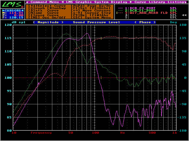

Here are vent measurements from a DCR I've built for a 4" Tang Band fullrange. There is no adjustment for vent area, so don't look at the relative levels.
Blue: near-cone
Red: vent1 (larger chamber - where the driver is located)
Green: vent2 (smaller chamber)
Blue: near-cone

Here's the response of my DCR.
RED PLOT = Near Field
GREEN PLOT = Large Chamber where woofer is
VIOLET PLOT = SUB chamber
Measurements normalized to Near Field.
The violet plot is what differentiates a DCR from a BR.

For posterity, here's the 3CR near with and without filter (black/red), and the nearfield responses of the ports. However- I cannot tell you which is which as it's been too long ago.

what would you change to get less on your violet plot/output thereby attenuating the upper compared to the green plot? I realize that is a simple question with, in this case, a complex answer. BTW this is for an LFE-only Home Theater application.Tony
