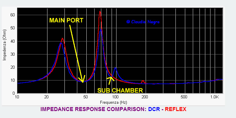

This is Claudio's impedance measurement comparison between BR and DCR; my question isn't directly related to DCR principle and can apply to BR: what do the reduced 28 and 69hz peaks physically mean?

I see both a reduction in peak height and also a slight spread between the two peak frequencies. In a BR box, the single impedance peak of the woofer gets split into two by the box/vent resonant combination. In general, the woofer electrical equivalent is a parallel resonant filter (impedance peak) and the box/vent electrical equivalent is a series resonant filter (impedance dip at 47Hz in this case).
It looks like the components representng the L and C of the cabinet got lower in impedance (smaller L and larger C ) The L represents enclosure compliance and the C vent mass. Don't know why they changed, whether it was how the two cases were set up or, more likely, a coupling of the elements from the second chamber.
Hope that explains a little.
David S.
Guys thanks for your inputs but my question still remain unanswered: physically, what do reduced peaks both sides of Fb mean?
For example, when using a high value series coil with a woofer, we can build a RLC // network to kill the second Z peak as to allow the coil to do his job accurately, OK?: but this tweak doesn't rely to a mechanical process from the driver, i.e. the driver don't change its physical working OK?
So when a same driver is used in two different loads like i.e. two BR, what do peaks of higher or lower value mean?

A motional impedance peak is an indication of "ease of drive" at resonance. The driver is both a motor and a generator. At resonance the generator part is creating current in opposition to the drive (motor) part. At that frequency the reactive part of mass and the other reactive part of stiffness cancel each other out. Efficiency climbs to its maximum as only minor losses remain. Since efficiency is high at that frequency, the current generated in opposition to drive is nearly 100% the same value (but opposite in direction). Very little net current flows and we see that as a very high impedance curve.
Any changes to woofer, cabinet size, damping or even cabinet "order" will move the impedance peaks around.
You are correct that adding network components to conjugate out the impedance peaks is a totally different thing and hasn't fundamentally changed the woofer system.
In the end you have to get back to the equivalent circuit and then the impedance curve is simply a view of it from the input terminals. The equivalent circuit comes from the physical parameters. Change the parameters and you will change the impedance curve. In our case the effective compliance of the box and mass of tuning are changed for the primary cavity by the presence of the secondary cavity. That spreads and slightly lowers the first two peaks.
