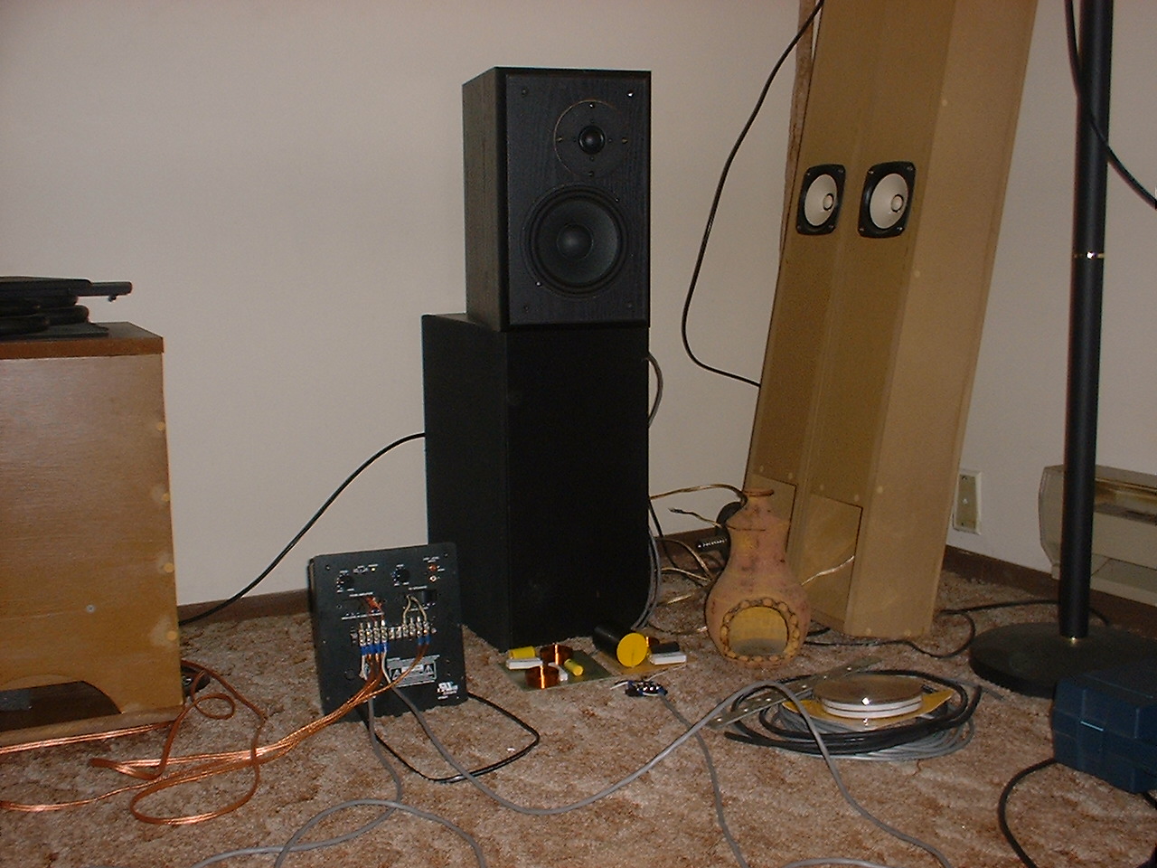

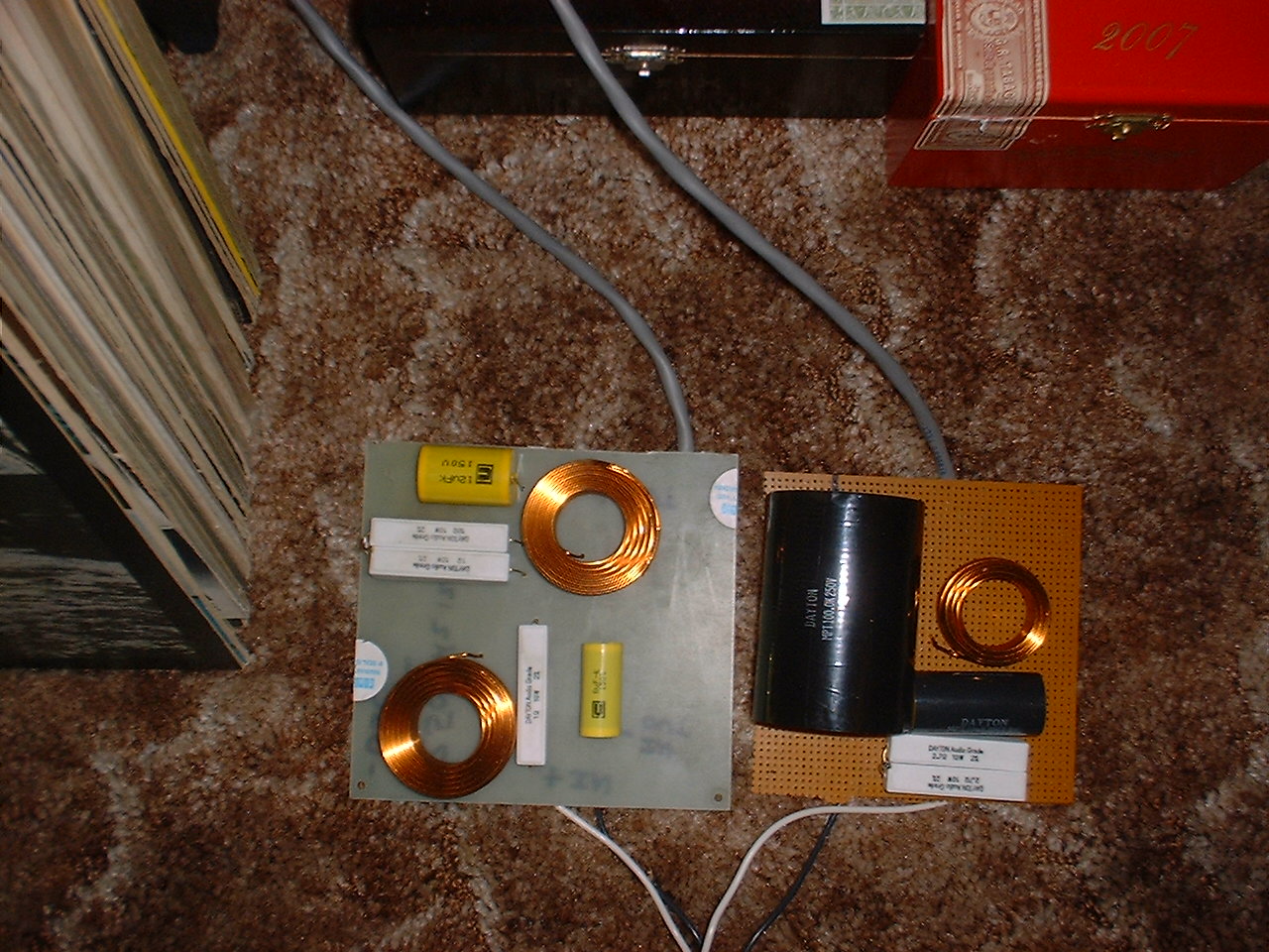

well i built the crossovers and installed the drivers in the old Parts Express BR-1 cabinets......
the xovers were kinda big so i built them externally.....
the sound is wonderful, i do use a subwoofer but i expected that with the smallish cabinets.
thanks much Michael Chua for this fine xover design.

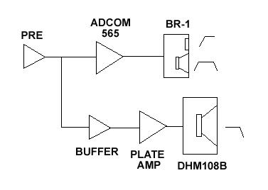

How are you running your new BR1 with your sub? Does your sub have a plate amp and adjustable crossover?

at the moment i run the sub with a modified plate amp. yes, it has variable frequency/gain
the sub is a Decware Deathbox II that i built
with the Decware DHM108B woofer
DECWARE / DHM108B 10 inch woofer
the br-1 is powered by an Adcom GFA-535 and i use the speaker level inputs on the plate amp.....
probably not the best way to do it, but it was the quickest....and i have yet to come up with a way to add an output to my preamp for the sub....without screwing up the sound.
yes it does
at the moment i am using the preamp section of an Anthem Integrated 1 tube amp
it uses 12au7's
it uses 12au7's
In the event if your tube pre has difficulty driving the Adcom and Plate amp, you can use a Buffer before the Plate amp. This can easily be constructed with an opamp on a perf board. If it poses no problems, omit the buffer and connect the pre out to the Adcom and Line in of the Plate. Simply use a "Y" connector.
To integrate the BR1 to your Decware Sub, install a High Pass for the Silver Flute. A 2nd order Butterworth at 125Hz should do. Components 100uF + 12.5mH (use iron core, much cheaper).
Set Plate amp crossover to 125Hz. To check for correct polarity, flip the polarity switch on your plate amp. If there is no "polarity switch", you will need to connect the + wire to the woofer "minus" terminal and - wire to "plus". This will reverse the phase by 180 degrees. The difference is audible. You should get distinct upper bass or missing upper bass.
With these changes, your sub should integrate properly. Whether your sub has definition is a separate matter. Some are loud but boomy while others have definition. I have never owned a Decware sub before, so can't really comment. In case if there's boominess, its not the room. It is the woofer itself. Woofers with very good control are the ones that has define bass.

well gee, it seems that i have been running the sub without its zobel network connected....oops....
wow what a difference.....

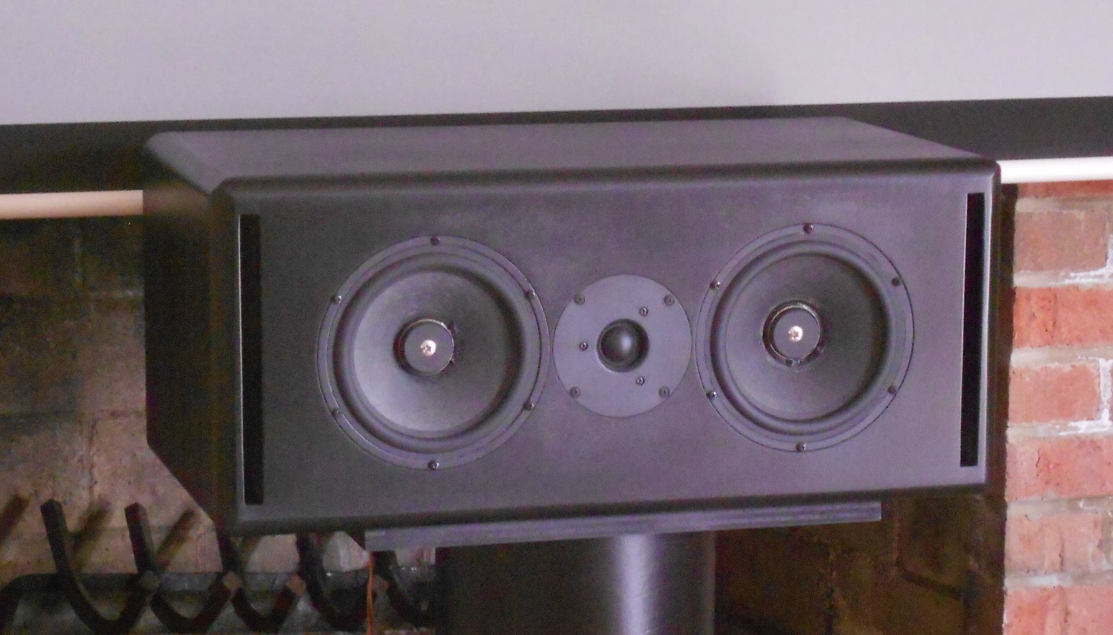

T/S measurements done with LMS (20g Delta Mass). As can be seen, they are quite different from the manufacturer's specs.
In the box modeling, the black plot is how the response looks like when tuned to 37Hz in a BR of 40L. In a DCR, there will be a bass boost at F1 (37Hz) and F3 (80Hz). F3 is the port of the smaller chamber. F1 is in the bigger chamber where the woofer and tweeter are located.
There is another port, F2 (42Hz), that connects the 2 chamber within.

The Silver Flute W17RC is a nice woofer. Very reasonably priced and generally good performance. Flat response until some cone breakup which is not too drastic. I don't think there are any other 6-1/2 that has similar response at this kind of price.
My SF W17 is the shielded version. It seems they don't sell them anymore. Only the unshielded version is available. If yours is unshielded, I'm not sure whether my T/S are similar.
However, if you're planning to use the shielded W17 for this DCR, the T/S don't matter. The measurements have already been made unless you want to redesign the enclosure.
