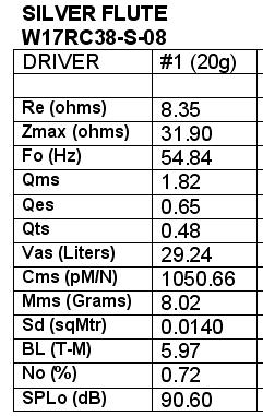

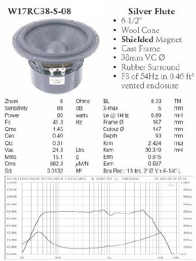

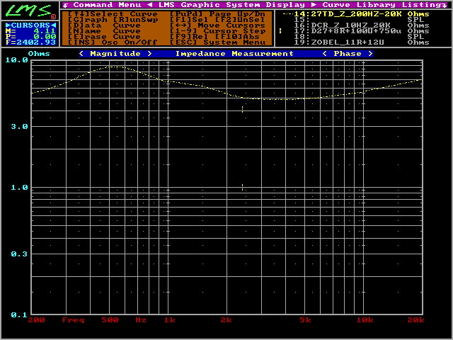

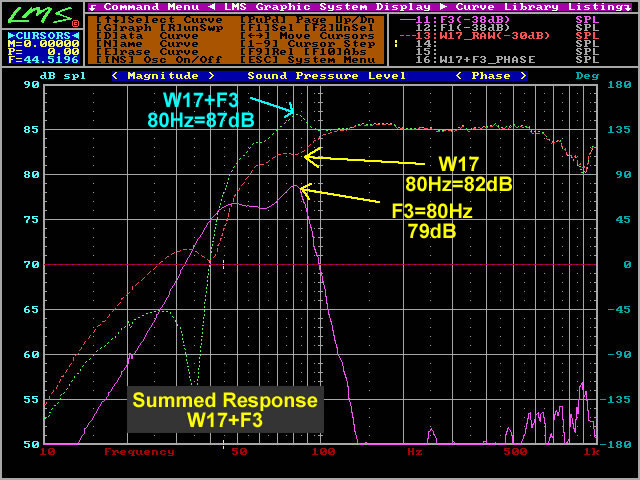

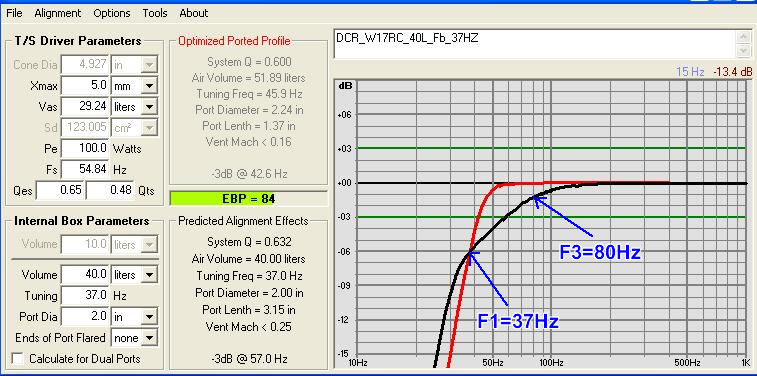

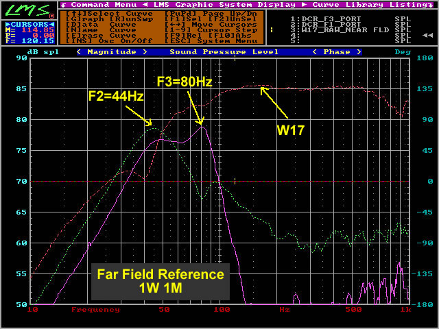

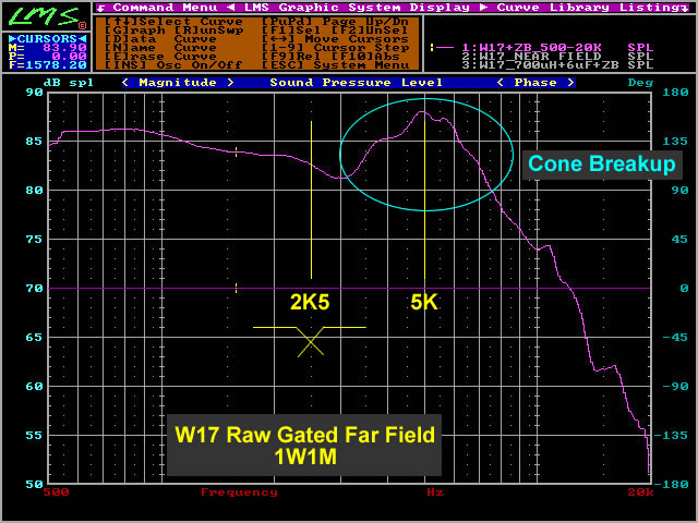

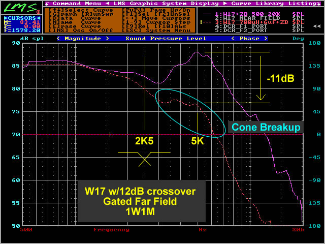

My SF W17 is the shielded version. It seems they don't sell them anymore. Only the unshielded version is available. If yours is unshielded, I'm not sure whether my T/S are similar.
However, if you're planning to use the shielded W17 for this DCR, the T/S don't matter. The measurements have already been made unless you want to redesign the enclosure.
I have the same model as you.
Would the woofers I have be more likely to be closer to your specs or manufactured specs?
I believe mine are more accurate.
