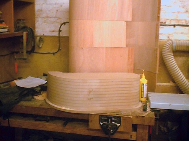

no, just 2 with vertical split horns instead of single flares. There's alot of bass dynamics gained by maintaining concentric radiation as well as tasty imageing. I really like the mtm arrangement as well as the angled drivers.

Wow, English fine craft eh? That'd make you a chippy? I studied David Pye, Makepeace, Latrobe Bateman and of course Ruhlman etc.. Lust in the dust, or lost as it were. I would have never entered the hifi market if I had your clientele for furniture.
