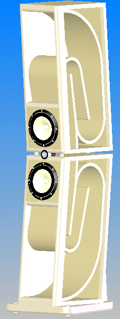

I've been throwing some ideas around again today after being inspired by some Cain & Cains last night. This is what I've come up with so far anyway, using Fostex FE208EZ drivers run fullrange and a T90A supertweeter. I've developed the horns in hornresp and they seem to be fine, assuming I haven't overlooked anything. Any comments/suggestions/problems you can see would be really appreciated.

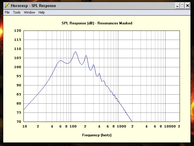

Well this is what hornresp tells me, for a single horn. So I guess add 3dB to everything for the double horns in parallel. I'm fairly sure that that graph represents what would happen if the speaker was right in the corner of a room, so I'll probably end up taking in room measurements when they're built to position them well. As far as direct radiation from the drivers goes, the FE208EZ's are rated at 97dB each, so I'm aiming at an overall sensitivity of around 100dB. Hopefully any baffle step problems (if it is a problem with horns?) can be solved by careful room placement. As to outright max nice sounding SPL, enough I hope!

Beautiful!
The only concern I would have is lobing caused by having all three drivers running to very high frequencies (10k +) and with relatively large center to cnter spacing. The general rule of thumb is that MTMs should be crossed over at a frequency whose wavelength ~= the mid to tweeter spacing.

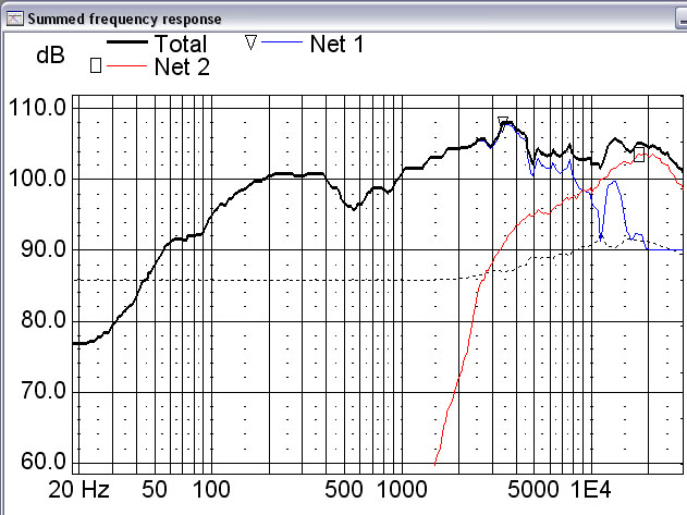

I've attatched a response curve for all drivers with a 1uF cap on the tweeter and 2 fostex's run full range. (this doesn't include the horn response so ignore the low frequencies) though I don't know if this will help sort out the lobing issue. Tweeter to mid distance is 163mm btw, which would mean approximately 2000kHz? (344 divided by 0.163). But then if lobing isn't a problem if your heads on the 'centerline' im not too worried.

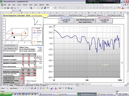

I was a bit worried about the fluctuations in response too. I modelled several 'comercialish' horn designs and found they all had a similar problem. What really stopped me worrying was this room simulation (see pic below) though I agree that's no excuse not to aim for a nice flat response, I'll probably tinker with the horn lots yet to try and optimise it a bit more, thanks.

The comment regarding the seventh veils having narrow vertical HF dispersion has more to do with the fact that it is a line array (albeit a pretty short one) rather than lobing from multiple drivers. The Seventh Veils uses closely spaced 3" drivers so the ~ 3" center to center spacing is not a lobing issue until higher up in the frequency range, about 4500 hz (if my math is correct).
Lobing does not directly cause limited vertical dispersion. The symptom of lobing is you will have one frequency response exactly on axis (your simulation shows only the on axis response) but moving your head up or down a few inches will cause a set of frequencies to have big nulls. Then moving your head a few more inches will cause different frequencies to have big nulls.
You are going to have center to center spacing between one "mid" and the tweeter of ~ 6 inches, so you will get lobing caused by interference patterns above ~ 2300 hz. Your tweeter will come in higher than that but you will get lobing effects for the range in which your tweeter response overlaps your mid response.
Even worse, is that for most of the refrequency range you are going to have the two Fostex drivers interfering with each other. These have a center to center spacing of ~10 inches. This will cause lobing starting at ~ 1200 hz.
The ironic part is that MTM actuall depend on controlled lobes to get a relatively narrow vertical dispersion (compared to TMs). The configuration is such that the two mids interfer but only enough to cause a single large lobe aimed at the listener . The nulls are above and below and help to reduce floor and ceiling reflections. At the higher frequencies the tweeter starts to beam which also limits dispersion. MTMs depend on close center to center spacing, a relatively narrow overlap between the mids and tweeter, and a moderate crossover frequency to minimize negative lobing effects.

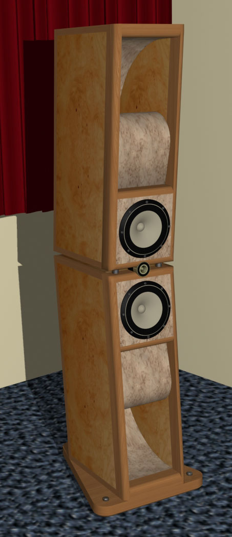

I got bored again this morning and did a few renders of the speakers, hehe....

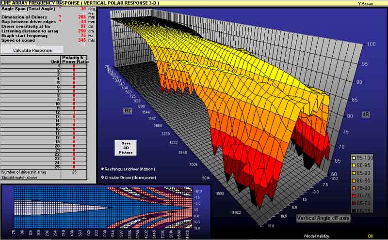

lobing solved, or partly understood...
Hello, I think I found what I was looking for as far as lobing simulations go, and this is what it threw up.... as far as I can tell response will stay within 3dB or so limits as long as keep my head within +-2ft of the centerline? To me that sounds acceptable, assuming the simulation is accurate and ive set it up correctly....:cannotbe:
Steve
Two speakers would cause lobing effect if you were listening to mono and try to reproduce the exact same sound from two different locations which cause two different path lengths to your ears.
I don't think adjusting the angle will fix it. The angle can be used two aim the sweet spot to a very small area but as soon as you start to get the same sound played from two different locations you will get cancellation/lobing when the path to your ear from each source is a different length. For example; if you assume you are sitting exactly on the tweeter axis (assume one speaker for now) the path length from the top driver to your ears is, say, 10 feet. The path lengths from your ears to the bottom speakers is also 10 ft meters. Now you move your head so it directly aligned with the center of the top speaker. The distance from your ears to the top speaker is a little closer, say 9.9 feet. Your ears are a little further from the bottom speaker say, 10.1 feet. The difference in path lengths is .2 feet. That is the half wavelength of ~2.5 k hz. Playing a 2.5k tone will cause the sound from the two drivers to reach your ears exactly 180degrees out of phase and they will cancel.
I'm not familiar with the spread sheet you are using. If it allows you to place the three drivers at different positions (i.e. height) along the speaker baffle and if it uses this information to calculate the response you should be able to see the lobing by running multiple response plots and vary the listener's height with each one
I posted my previous response be fore I saw your 3D graph. It's pretty tricky to read but if I go 3 degrees off center and look back at about 4-5k frequency it looks there is a crease running front to back on the graph that could easily be 10+ db down. (I believe the angle scale goes from +12 to -12 degrees with 3.0 and -1.5 degrees as the center lines). At a ten foot listening distance I think this works out to 6 inches
