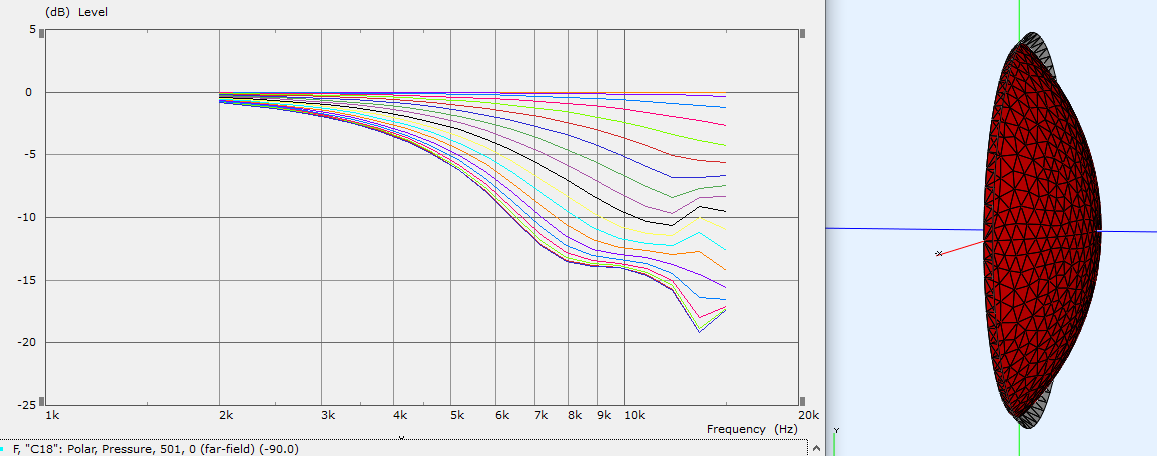

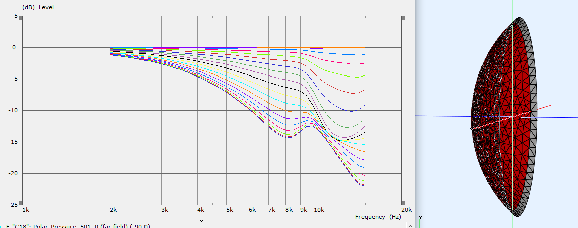

Just out of curiosity, what a numerical approach says (50 mm dome in an infiite baffle, 0-90 per 5):

Something that I've toyed with, is taking the idea of a Unity horn and turning it inside out.
If you look at your sim of a convex cap, you can see that it's really well behaved. In a nutshell, as the wavelength of the frequencies become smaller than the radiator, they narrow in a well behaved way.
If I understand the theory right, we can control the beamwidth a *little* (not a lot) by changing the height of the spherical cap. Basically the flatter that the cap is, the narrower than the beamwidth will be when the wavelengths are shorter than the cap.
I think that's one of the reasons that the Beolab 50 and the 90 use this strangely shaped array. By curving the baffle they're widening the beamwidth. (Of course, the use of three drivers instead of one also gives them the opportunity to vary the vertical beamwidth by shading the drivers, delaying the drivers, or both.)
Thank you! Very interesting.
- The direction of sound is to the right? So the top dome is convex, and the bottom concave (like Focal etc)?
- Does the simulation assume the dome pulses as a dome? Or moves like a pistion?
Hmmm, tell me, can you also easily simulate radiation of say 12" BEHIND and enclosure?

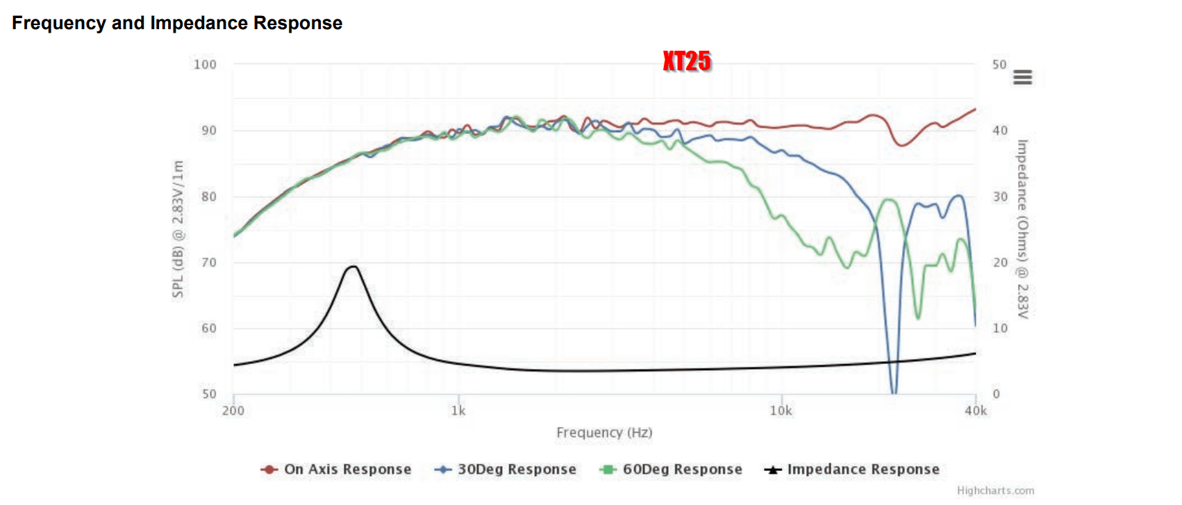

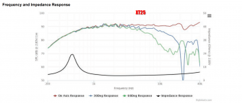

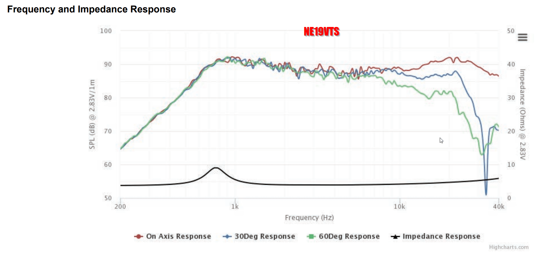

At the moment the alternatives I know of are NE19VTS and Vifa XT25. To be able to match a 3.5 inch midrange / woofer I would have to go around 1200 / 1300Hz to have enough space on a Synergy horn.
I'm trying to simulate a two way "mini" Synergy with a dome tweeter and two Peerless SLS-85 that go down to about 100Hz.
You would prefer a NE19VTS or a Vifa XT25?
The smaller the throat, the better. NE19VTS maintains polar control to 12khz, XT25 loses it at 8khz.
(13,500Hz is one inch long)
See attached
