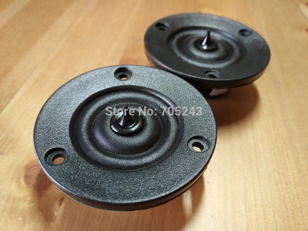

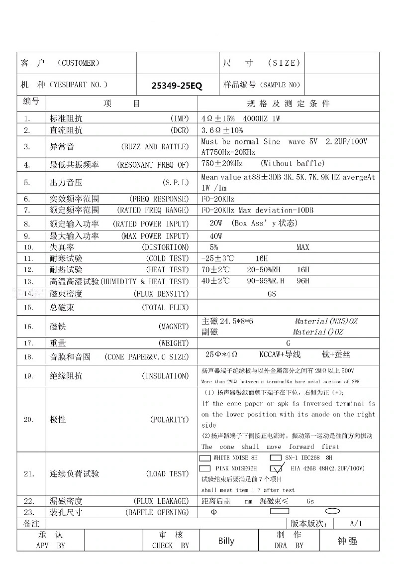

Are you only looking for cheap tweeters? If not Hiquphon OW1 looks physically very similar to the SB tweeter wich may be a sign it could work? It also has a oneway Xmax of 0.9mm wich could possibly mean a lower crossover point.
Hiquphon OWI (OW1) dome tweeter features

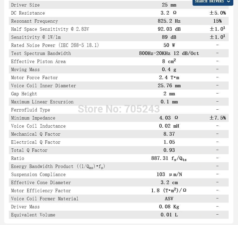

My main gripe with the SB Acoustics SB19 is that it's too big to be arrayed properly.
Picture this project from FollGott, but with 3/4" domes and that's the general idea.

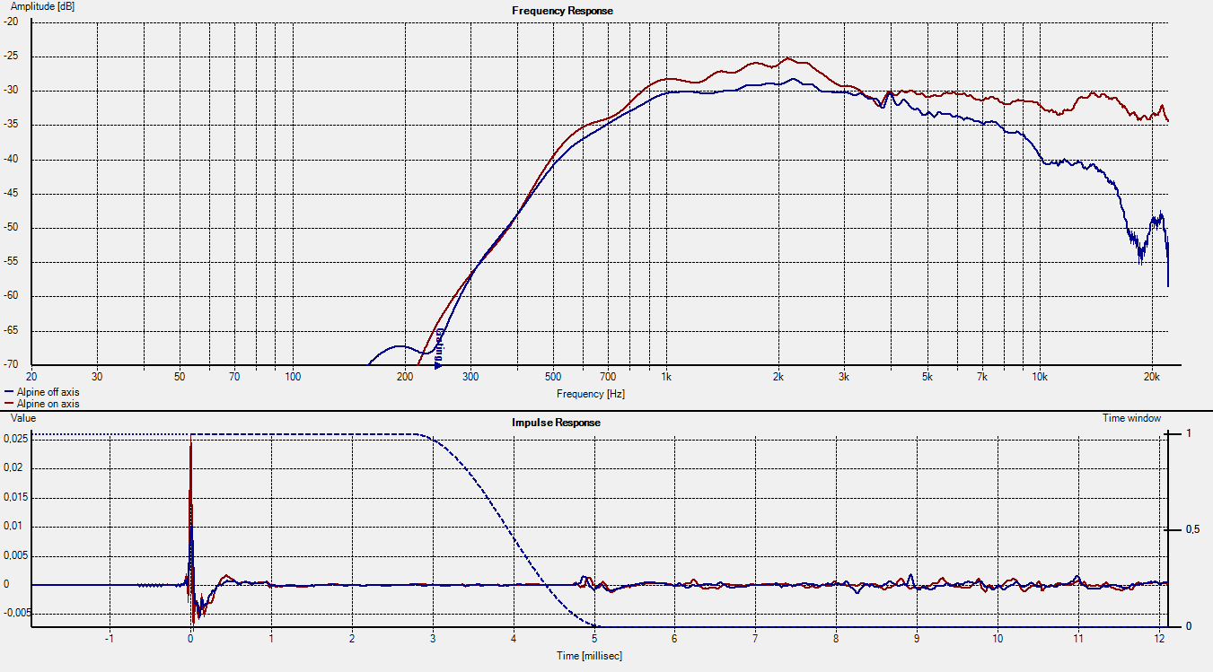

While we're at it - here's measurement of famous Alpine ring radiator from Aliexpress in Visaton WG148R. 1m distance, on axis and 30deg off axis. Slight bloom at 3.5-4kHz is characteristic for wg148r and starts to drop after 30deg. Same can be seen with my Morel CAT308 in wg148r measurements.
As one can see, a scalpel ended up in my index finger while i was cutting the groove where metal mesh was pressed. Well worth it though. It'll heal.

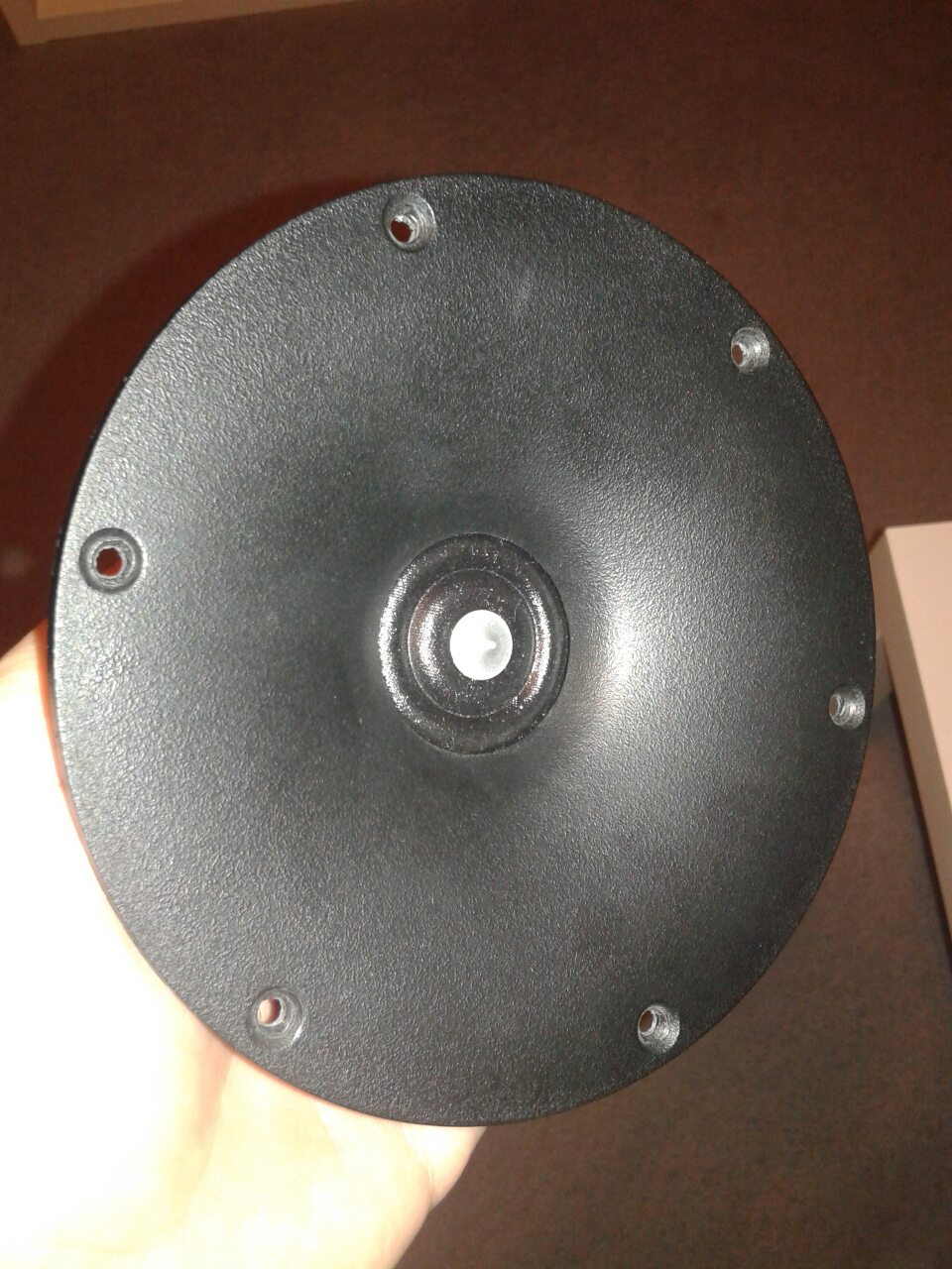

At this link I showed that the Tymphany NE19VTS works really nicely on horns and waveguides. The reason that it works well is because it has a nice amount of xmax, but the tweeter is small enough that it doesn't require a phase plug. If it was larger, you would need to create a dedicated phase plug, similar to what a real compression driver has. Another nice thing about the Tymphany is that it has a large back chamber, allowing for a low cutoff. IMHO, if you're looking for a tweeter to put on a waveguide, there's nothing under $25 that can beat this.
BUT...
You need an adapter to mount it to a horn.
The latest version of the NE19 adapter can be downloaded here.

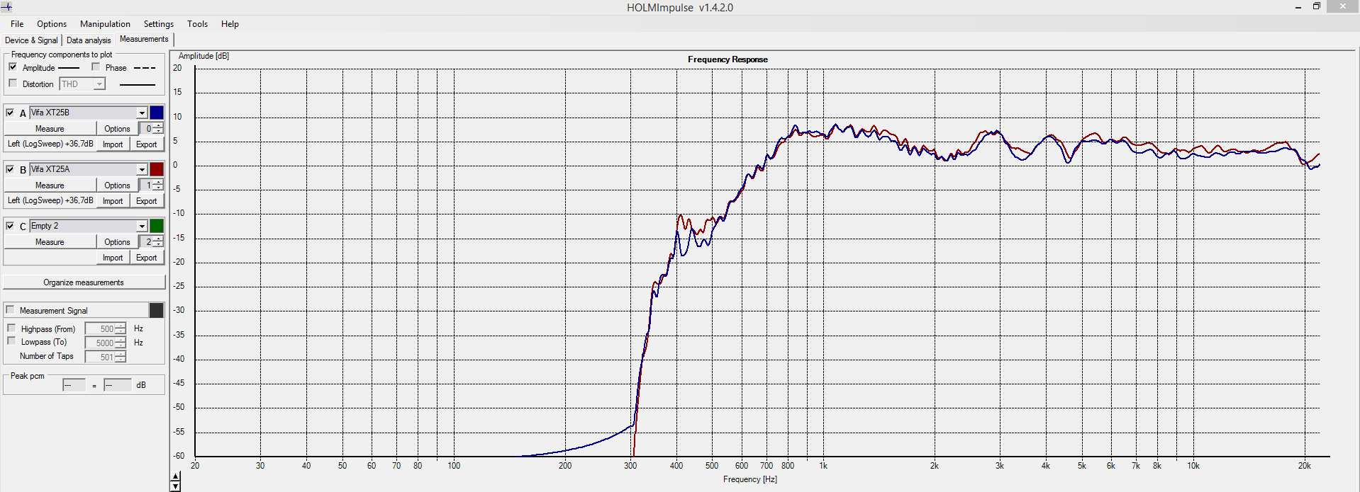

Guy i know ordered those Vifa knock offs. Here are measurements - not gated but better than nothing.
View attachment 766447 View attachment 766445 View attachment 766446
I am worried about that resonance at 2.5kHz which doesn't show up on that Alpine (probably Scan Speak) tweeter even on much higher resolution.

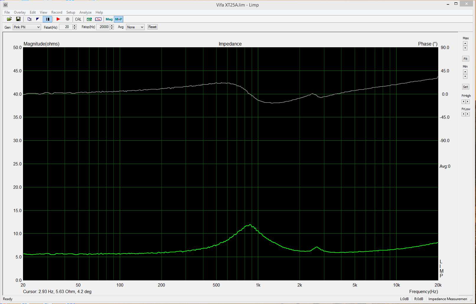

If you need TS parameters of that knock of tweeter, there is none. I think that no one can measure TS for tweeters with enough precision besides factory

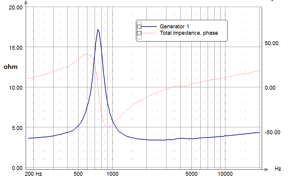

Thanks for your reply!
Well I found another knock off ring radiator, quite similar to this one.
Between the specs of on and the other... I hope I'm somewhere in the ballpark.
Will leave the specs here... maybe someday it will help someone! 🙂

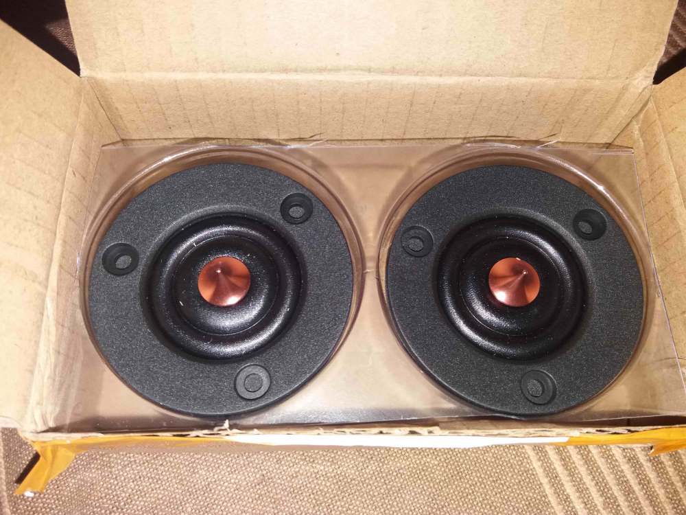

i dont understand why are these tweeters have been termed as knock off's . Here is the reality for these ,
The one which is having a black phase plug is an original product made by tymphany and it bears a serial number that starts from "MX" . Infact any driver which bears a serial number that starts with MX is made by tymphany as an OEM driver . This tweeter infact has been used by SONUS FABER in their "TOY" Book shelf Speaker
Now regarding the Second Tweeter with the copper coloured Phase Plug , this is made by a very respected Driver manufacturing company in China. Tymphany doesnt make each and every spare part used in all the drivers on their own , there are companies that specialize in producing parts such as " Ring Radiator Diaphrams" . Tymphany no longer holds the patent on the ring radiator and any company can use similar diaphram to make their own products . i can try getting the info on this tweeter and post it here . i have used it and it is a fantastic tweeter if you can implement it correctly .
The guy David louis owns none of the products that he sells by his name , all are sourced from OEM manufacturers and rebadged
