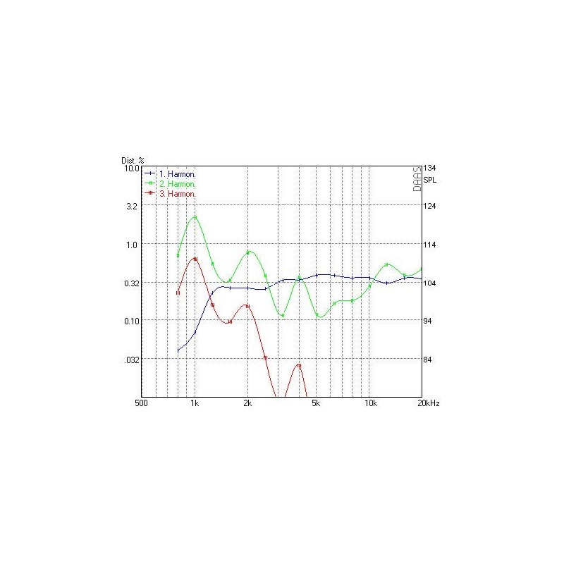

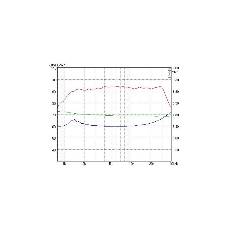

What are you talking about?! That is utter nonsense! That rule of thumb came up with dome tweeters because, well, as most traditional coil transducers, got a strong impedance peak and high Qts which is usually irrelevant for a tweeter but results in a bad decay and THD around the fs. But this is not a dome tweeter, you cannot apply every rule onto everything. With an AMT you do not get that peak, the impedance is rather flat. That means, you are only limited by the THD and the spl at the xo frequency. Mundorf says 2000Hz at 12dB or 2500 at 6dB. Can that be right? Let's look at the measurements:
Yes, you can see the bump of the resonance. But did you notice the scale of the graph?
So now for the decay, note especally the range around the fs (1,4kHz):
Not a reason to worry about, is it?

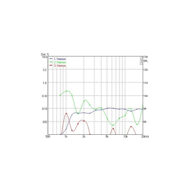

Ok, now distortion.
That is at 2,83V or on other words, 92dB at the lower end. Clearly bleow 0,3% K2 at 2kHz, the rest (K3, K5) much lower. Prette much usable, isn't it? Oh, 92dB is too low? Yes, I agree. Now let's look at 105dB:
K2 still at only 0,8% at 2kHz. You don't see many dome tweeters with a that low THD at 105dB.
If the only tool you've got is a hammer, everything looks like a nail. Now please tell me how that rule applies to AMTs.
