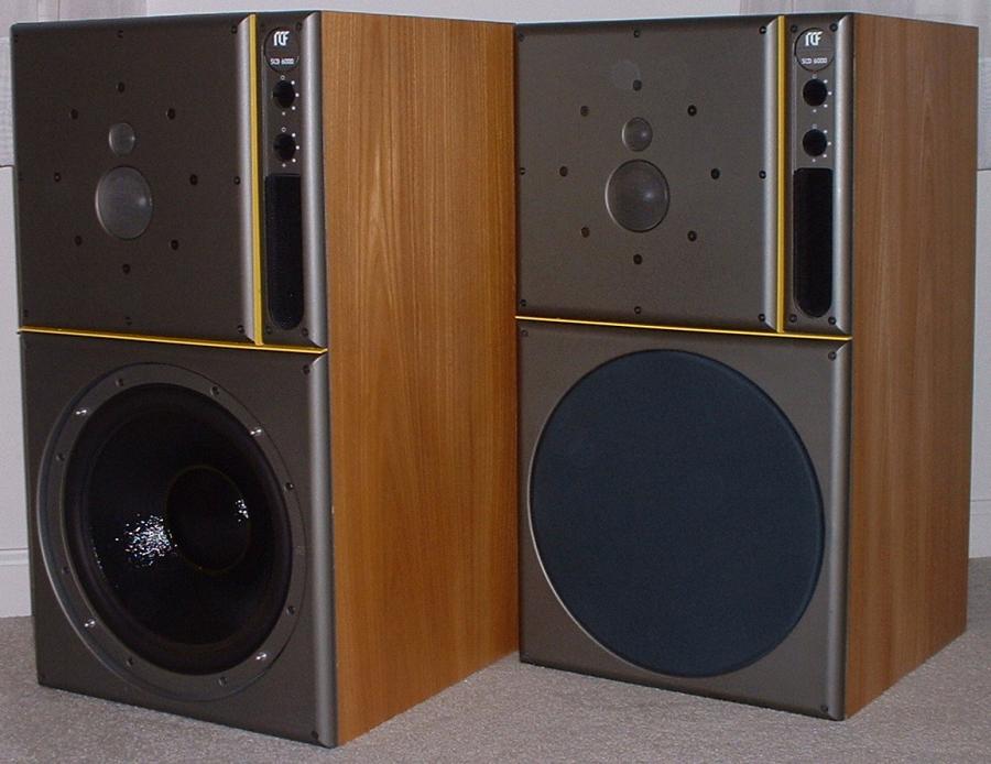

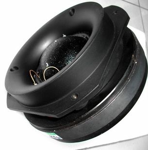

Dayton's TM1a looks like RCF's vintage dome mid/high frequency dome combination from the studio monitor "SCF-6000" (SCF6000)
Overview TM1A_HiVi, Inc.
this very special dricer from RCF is mentioned by page 113 (fig. 40f) in the third showed pdf book "Dichtung und Wahrheit" (download for free as I know) about the URL

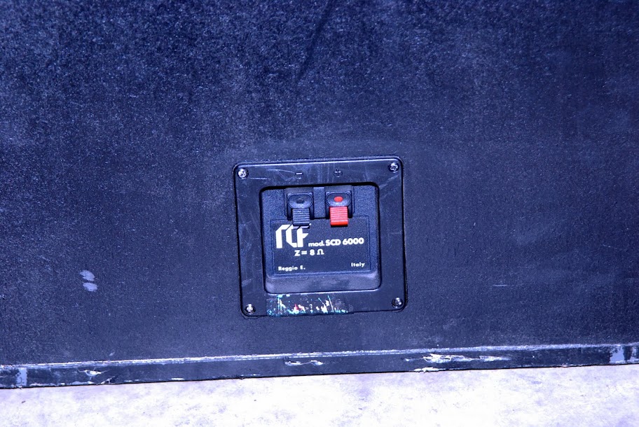

RCF's very special and very rare dome midrange/tweeter set-up from the model "SCF6000" (SCF 6000") is also to see about
ebay auction item number: 260741432582
