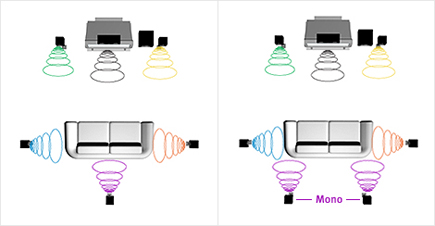

So (apart from the 0.1 LFE) it could be:
Front L R
Side L R
Rear: either one or two
ie 5.1 or 6.1
Or
Front L R
Back L R
ie, a different sort of 4.1
Which is better with ‘most formats’?

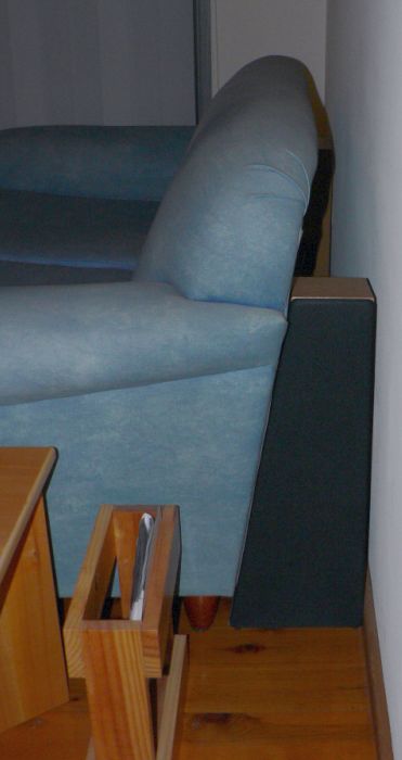

Unfortunately I have a wall directly behind the viewing area and an awkward side wall arrangement which limits the rear speakers that can be used.
I place a priority on atmoshere from rear speakers more than direct sound so needed an arrangement that would hide the location of the speakers.... a sort of pseudo null as they are hidden by the sofa.... to create a more diffused pattern.
The end result was side firing with a slight tilt backwards. The centre rear when it was there fired up to the ceiling. Most of the sound I hear is reflected sound but is still able to provide location and steering when required. See the pic even though the quality of the shot is not real good. You never know they are there so very SAF. A lot have had great success with rears that fire upwards.
I had a visitor from Tassy who has never heard a HT system (or has hardly ever been to the movies from the reaction). I played the scene from Top Gun after the flameout when the F-14 goes into a flat spin. The steering and effect was very real and she freaked out... mission accomplished.
It's hard to say what works best as each room, furnishings are different but you just have to experiment. I think if you use side LR then I think the rear LR are required.
I needed clear dialogue as my hearing is not as good as what it was especially when other action is happening, good soundstage LR and front to back, good steering and atmoshere and the final result is very good and satisfying with 4.1.

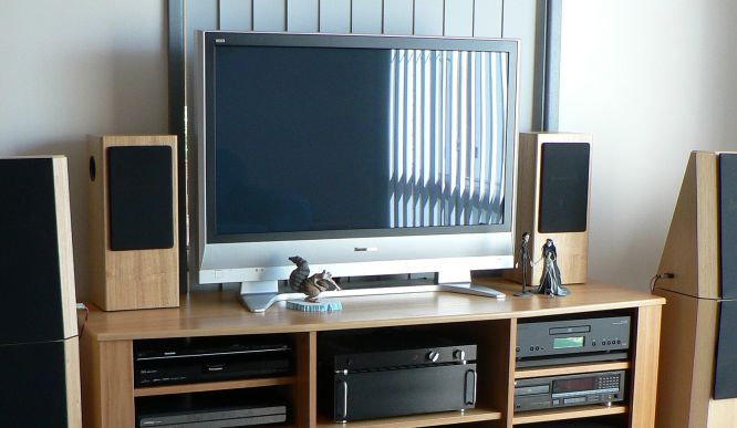

The 4.1 is
front LR
rear LR
with sub out of sight and fires sideways into a wall
I was joking about the topic as I got lost rambling on.
I think it's important to use the same mid-woofer or similar throughout. The fronts of course are the most important and I would use at least the same brand / type for the rears (for say 300Hz - 3kHz) but can be much smaller as these are normally set to small. All my 4 are set to small and I let the sub handle the LFE channel.
The speakers in the pic next the the screen are the front LR and are only 5" 2-ways.... SEAS 27TTFC / Peerless 850488.... plenty of go, clear, good dialogue and only handle from 90Hz up.
You can see the angle of the rears in previous post and as I can't see them from the seated position, I can't locate them acoustically as well.
One other thing.... I only have to cater for an audience of 2 (plus 1 dog) so it makes it very easy as there is no off-axis. As soon as off-axis comes into it, it's a whole new game.
