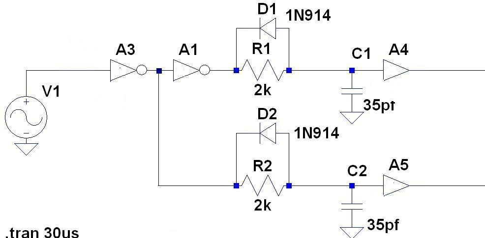

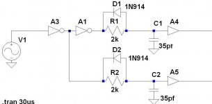

Your project is getting more expensive by adding LM361N. This will negate the concept of being cheap class D. I think you will consume four LM361N?.
My old schematic shows I use Schmitt inverter but it is more suitable to use CMOS inverter like 74C04 as the phase splitter as well.
I’ve done simulations with this and it worked fine in providing adjustable deadtime.
The 2 caps c1 and c2 are not discrete part of the circuit but it is the capacitive input of IR fet driver. A4 and A5 is the input buffer of fet driver. V1 gen is the output of tl494. this is better than RD at the gate of power fets and cheaper than LM316 approach.
I use three LM361N. The A3 and A1 blocks in your diagram, a single LM361N gives me that with propagation delay of maximum 20ns. I have exactly the same RCD network as in that diagram and A4 and A5 are my other two LM361N.

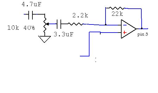

If you want to put a volume control, then it is not good to alter the gain of the opamp with that 22k resistor. This will jeopardize the output of pin 3 when the volume is in minimum resistance.
Just simply put at least 4.7uf cap in series with 10k pot parallel to your audio source relative to ground then the center of that pot goes to coupling cap @ the input of opamp and that’s it. Your done.
Ok putting the capacitor in series with the Pot I understand. But I lose you when you say "parallel to your audio source relative to ground".
Do you mean like so ?

No, I said "parallel to your audio source relative to ground" exactly as Eva has said.
voltage divider like this
OK thanks for clarifying that. But if your grounding the 10K pot, what's going into the positive input of the error amplifier. Unless I'm being an idiot and this is another 10K pot totally different to the 10K pot used to adjust duty cycle to 50%.
If that's the case, I have audio input going into the 4.7uF cap and adjust gain via that 10k pot, while the other 10k pot is left at 50% duty cycle?

Yes, The added 10k pot is called volume control. while ather 10k pot is for duty cycle adjust. If that duty cycle adjust was done, then "forget that pot"(or put epoxy on it:rolleyes:).
