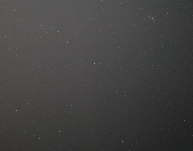

This is an old shot of Perseus on the D60 at 4s, ISO 1600 and f1.8 taken higher up, and I checked that it is no eclipse. It's not too bad:

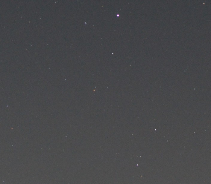

That area top right is apparently the double cluster. I think we can see that Algol is brighter than Rho in the neat little pentagon bottom left.
I have finally figured out the self-timer button on the D3200 too. So sharper pictures I hope.

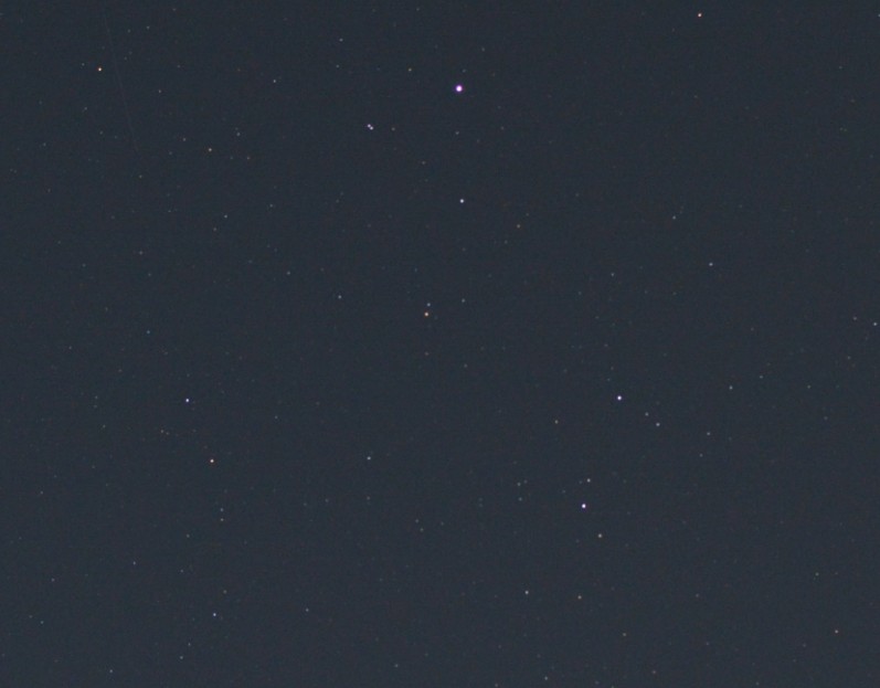

I took a few shots of Algol tonight at magnitude 2.1, and it's still hard to spot that it's normally 3x brighter than Rho mag 3.3 just below it, and Beta Persei, so I don't know how the ancient Egyptians spotted this 2.86 day eclipse pattern. Centre, about 1/3 way up.
But they did apparently, according to recently investigated manuscripts. Otherwise it was about 1750 when this was properly documented.

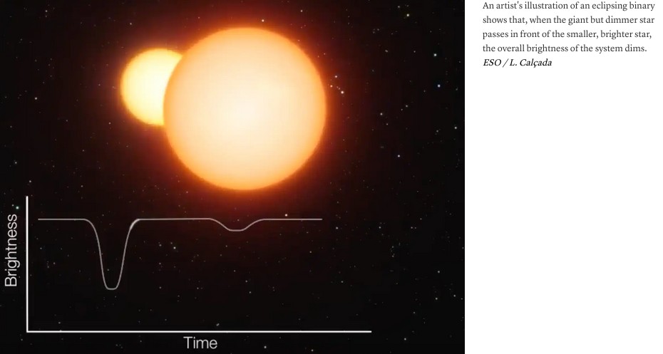

It's a very interesting triple star system. 94 LY away. A new hot white star of 3 solar masses and 180 sols brightness, a 1 solar mass red giant at 6 sols brightness at 0.06 AU, which is 6 million miles, orbiting it, and another hot star of 2 solar masses orbiting them both at 3 AU, which is about the distance of Jupiter. The hot star is accreting mass from the red giant appreciably, and you might think it will go Nova or something.
You can guess that the red giant star blots out about 2/3 of the brightest one.

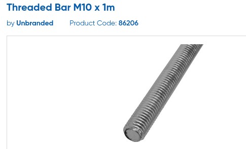

The only bit I didn't really get, was how handed molecules twist the light a particular way regardless of orientation, but on further thought, I suppose a right handed thread is always right handed whichever way you point it.
Left handed threads are used in bicycle pedals and wheel nuts IIRC. To stop them loosening.

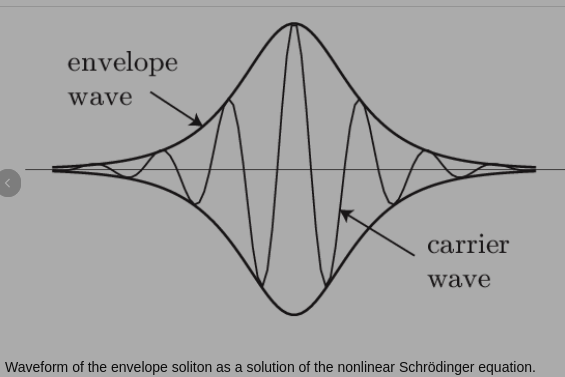

It's surprising to me that the lowly rainbow and now this sugar water thing leads to interesting mathematics.
Regarding the "waveform of the envelope soliton" illustrated above.
A soliton is a wave with just a single crest which can travel a long distance without spreading out, thus maintaining its shape.
Apparently, the tendency for the wave to disperse is balanced by "a self-focusing nonlinearity".
Solitons can happen in water, as first discovered by John Scott Russell in 1834 in the Union Canal near Edinburgh.
Infrared solitons can travel for thousands of kilometres through optical fibres, and are used to carry information across oceans.
Wikipedia mentions the soliton solution to the nonlinear Schrödinger equation: https://en.wikipedia.org/wiki/Soliton#:~:text=In mathematics and physics, a soliton is a,after collisions with other such localized wave packets.
Soliton solutions apply to many areas of physics, including hydrodynamics, quantum mechanics and particle physics.

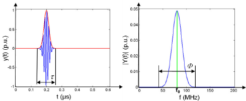

A 'Gaussian burst' is a sine wave modulated by a Gaussian exponential function in the time domain (shown in red in the LH figure). The Fourier transformation of the burst is also a Gaussian exponential function in the frequency domain (shown in blue in the RH figure). By defining the Gaussian burst in the time domain it is possible to control the corresponding frequency range of interest in the frequency domain.
That's got to be useful for testing loudspeakers has it not? :scratch2:
If we ignore the MHz that is!
So nobody is interested in circular polarisation? Which is a phase change. All part of the repertoire to me.

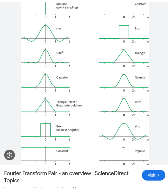

I have watched another 3Blue1Brown video about the Gaussian or Natural Distribution. A thing of great beauty in 1 or 2 dimensions.
This thing is fundamental in signal processing, where it is linear. In Quantum Mechanics it is different, because you cannot know the phase angle of the wave, though you can know the group and phase velocities, and their product, which is c squared in a vacuum.
What is beautiful about the Gaussian Impulse is that it is its own transform in the time and frequency domains, whether electrically on wires, or spatially with apertures:
What does this mean? IMO, that nearly EVERYBODY gets the wrong solution in Audio... rectangular or pistonic responses are VERY BAD.
They lead to ringing or lobing.

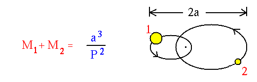

Which is a bit like discovering that Kepler's Third Law is WRONG. The Algol star system got me thinking about this. How do they calculate the masses of the main two stars?

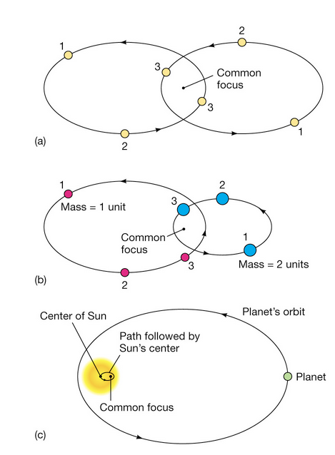

See it's not how it really works:

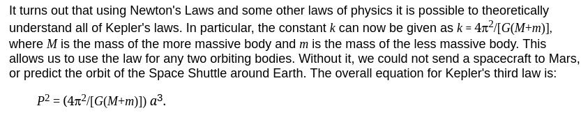

The correct Newtonian solution, which I found in an Astrophysics reference book at the library today, is another thing of beauty:
a^3 is a transformed value though. Which takes some thinking about too.
https://phys.libretexts.org/Bookshelves/Astronomy__Cosmology/Supplemental_Modules_(Astronomy_and_Cosmology)/Cosmology/Astrophysics_(Richmond)/11:_Kepler's_Third_Law

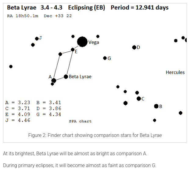

Beta Lyrae looks an easy binary star eclipse candidate:
It's high up at 3AM right now. I am after Beta Lyrae dimming every 13 days.

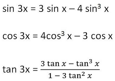

This is a very good video if you want a serious take on it. The actual frequency of the Photon emitted in a Hydrogen Atom is the difference in "orbital" frequency between the n=1 and n=2 states, as a superposition problem.
This works out at 1/4 x 13.6 eV with a Cos 3x factor in this case. It's not rigorous though because Schrodinger is not Lorentz Covariant nor does it include spin, for which you need the Dirac Equation. But maybe good enough.

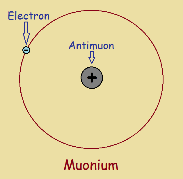

I read that muonium could change our understanding of physics and the universe! 😎
Because muonium is such a lightweight and simple atom, exploring its fine structure provides a way of testing one of the fundamental symmetries of physics - Lorentz symmetry.
Lorentz symmetry is the suggestion that the laws of physics remain the same for all observers, no matter how they are moving. If this symmetry were to be violated it could indicate that the universe is much more complicated than we realise.
Learn more about muonium research here: https://scisimple.com/en/articles/2025-01-23-muonium-a-simple-atom-with-big-insights--a9p02n6
The Muon is particularly sensitive to virtual particles, which is why it's good to measure. Isn't it the anomalous magnetic moment that is not exactly 2?

I don't think we have an eclipse tonight, for the third successive night:
I have not been able to find a current timetable for this anywhere. Looks like I have to do EVERYTHING! Weather is horrible tomorrow, but may be better in Sweden. Hint.
