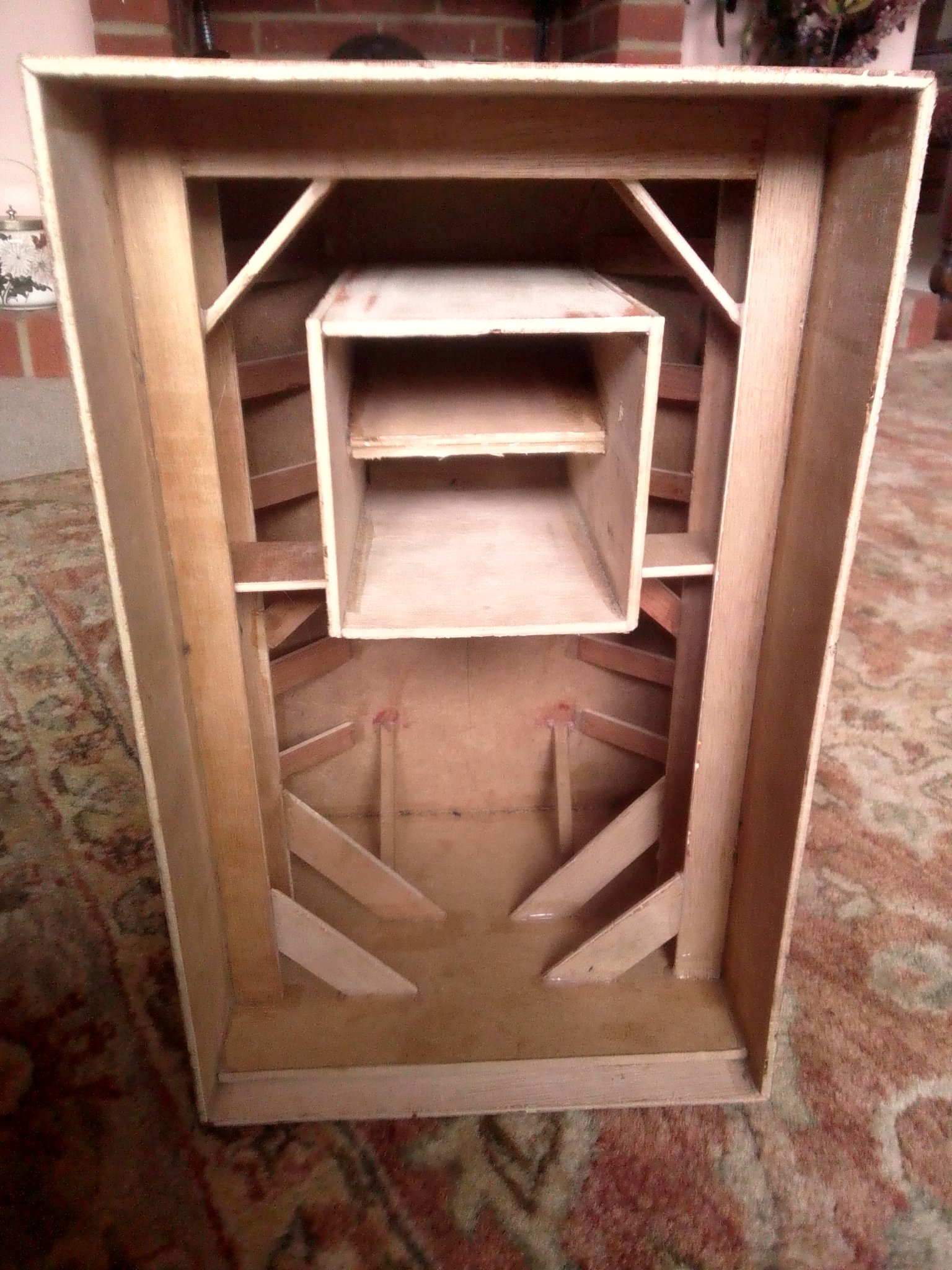

Randy,
The first time that I saw this sort of thinking was with a KEF, although the rod connected two drivers rather than the cabinet. I like the idea of a rod connected to the rear of a driver, that is for sure, but what I am trying to explain is the tension of the rod could be adjustable for DIY people like me.
In a sort of related example of attachment of the rear of the driver. There was a sub that I built in which the magnet of the driver was close enough to a brace in the cabinet that I was able to secure it with silicone adhesive. The thinking in that case was to minimize/dissipate the vibration of the driver itself.

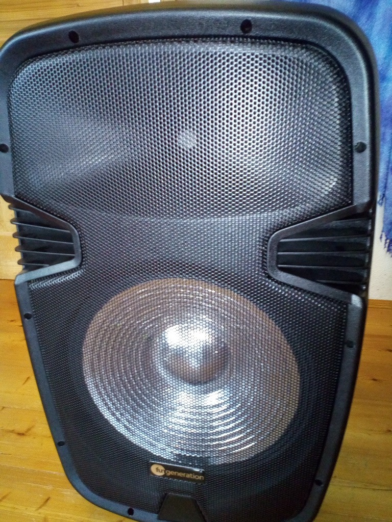

Yeah, this is an interesting area which for me has appeal when considered for bass amp for an electric double that I am working on for my daughter. I have tried both booker and truss rods. There is a very fine line between horrible vibration sounds and good warm output, especially with the booker rod. I tried various washers and nothing really worked. Then I thought to glass on a truss rod on the panel and ordered a short one, but haven't tried it yet as all projects came to a halt. My proposition is that the truss will twist the panel into stiffness and can be dialled in. I am leaning more towards a sound box under the bridge and piezo pickup and keeping the amp/cab hi-fi. DSP should let me tune that sound box output better than mech tuning the cab
Some result I can confirm. Works well when the baffle is the vibe panel and the cab is solid. HDPE (blue transport drums) sounds better than wood when excited by driver vibration. Buzz is hard to control over a range in wood but less in HDPE. The base cutout from a drum makes for a good, strong but movable baffle material. Need to use Nylocks otherwise driver will come loose and fall off! Ask me how I know 😀
