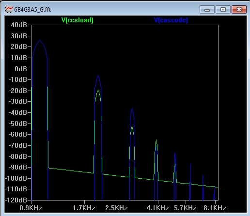

I had a play with this. I took off the output stage so that I would examine the output of the 3A5 and I compared it with and without Cascode.
In Spice at least, the simple CCS load looks better than the Cascode ?
[to use the triode symbol, remove the ".txt" extension from the filename and place it in the same directory as the simulation file]
Same results here, I guess I don't consider the shunt 3A5 a good direction, thats a lot of added distortion.

As distortion cancellation works you will get better results with the cascoded 3A5. Don´t forget the 6B4G/2A3 is not linear either. You have to find a driver that complements it to get low distortion at the output and the cascode does. Not that big difference in odd harmonics but not worse.
