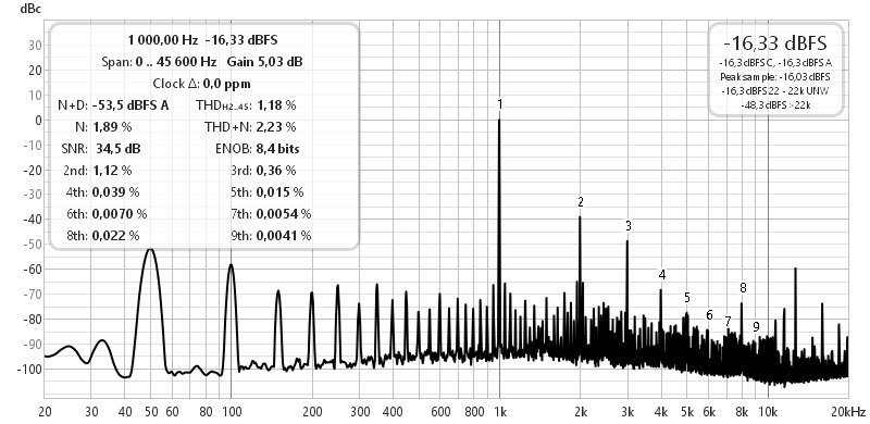

Nothing to see here. I'm sure the owner of the 2A3 thinks it sounds wonderful. Rich and warm with character.
Reactions: ItsAllInMyHead
