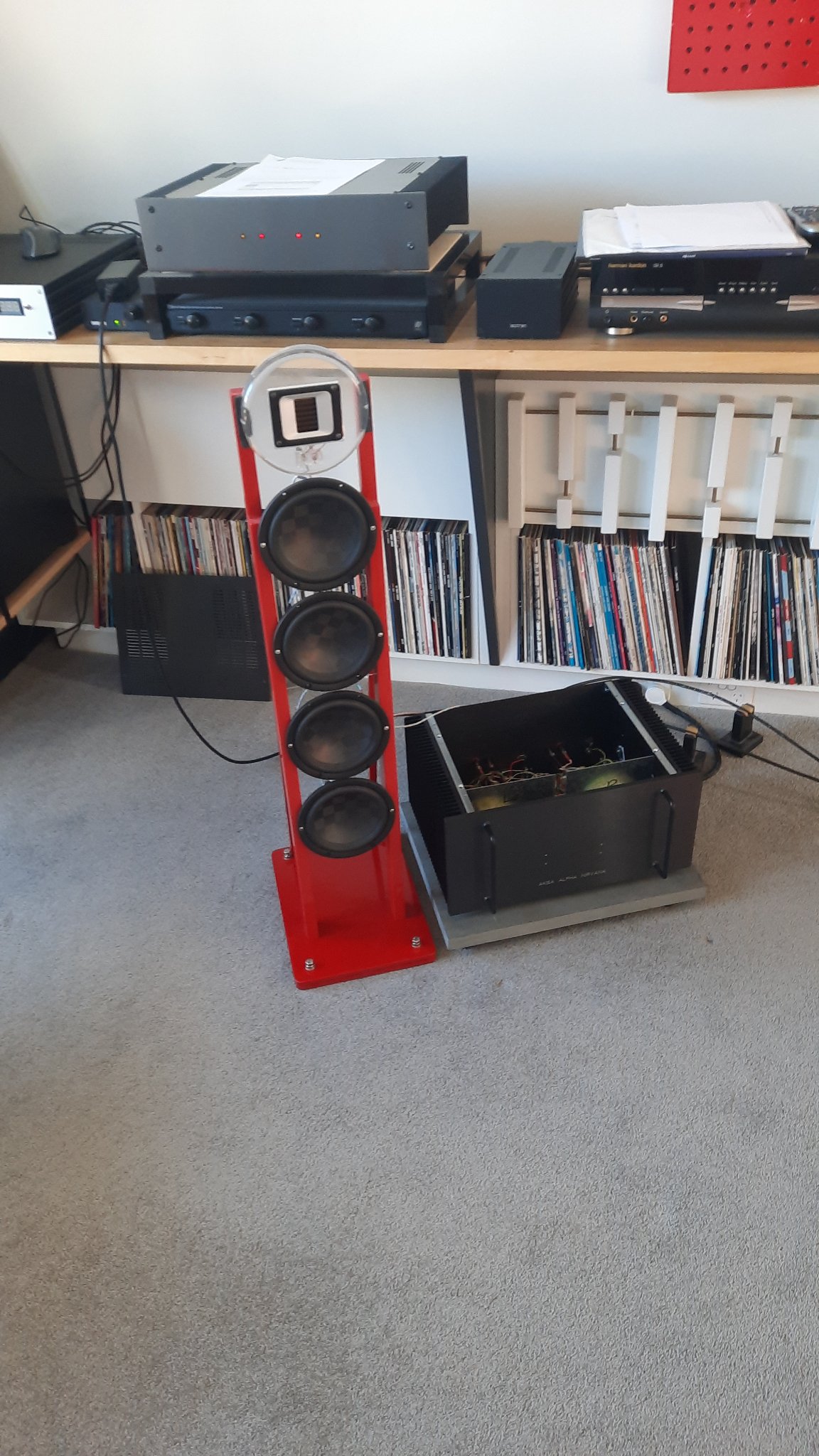

andyr why you drive them with power amp if they are active speaker?
You seem not to have a wide experience of hifi components? (Hah - "the Donald" will sort you out, once you guys become the 51st State! 😀 )
As loosely defined here:
Active speakers require amplifiers. Those amplifiers simply are (generally) part of the speaker enclosure.
I'll give you a lengthier definition:
* 'passive' spkrs need an amp channel to drive them.
* inside the box - if there is more than just one driver - there is a passive XO which splits the incoming music signal across the drivers.
* the key issue, to my way of thinking ... is that the amp channel is not directly connected to the drivers - the XO is in the way.
* whereas an 'active' spkr has one amp channel directly connected to its corresponding driver.
* hence, the frequency splitting happens before the power amp channels.
* these amp channels can be incorporated in the spkr enclosure ... or they can be external.
* in my case - they are external.
Here are my spkrs - which don't have an enclosure (with the Class A amp next to it):
Reactions: ItsAllInMyHead

andy then your speakers are passive, you are the first person to tell me that amps outside speakers are active speakers.
So strange that we live on the same earth and I don't know what an active loudspeaker is.... I never seen OB with the entire room considered the 'box' then it makes sense your amplifier is inside the 'box', just a little inconvenient to move your active speakers with the XO, the amps, and the speakers.
