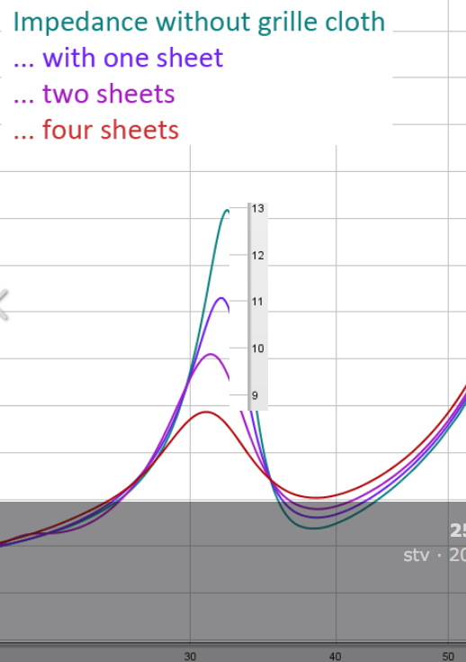

The lower peak is reduced as you add more grille cloth.
That could actually be a good thing
yes - but unfortunately the cloth also raises the bottom of the "valley" between the two peaks which shows the reduction of Q of the resonator.
So the efficiency of the resonator is reduced by the cloth.

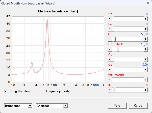

I quickly replicated the impedance change in hornresp ...

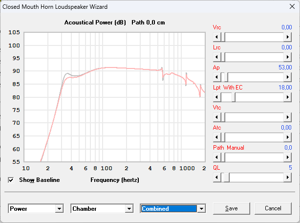

resulting response change:
reduction of port output by ~ 2 dB in simulation.
I would need to confirm this by response measurements - but not today!

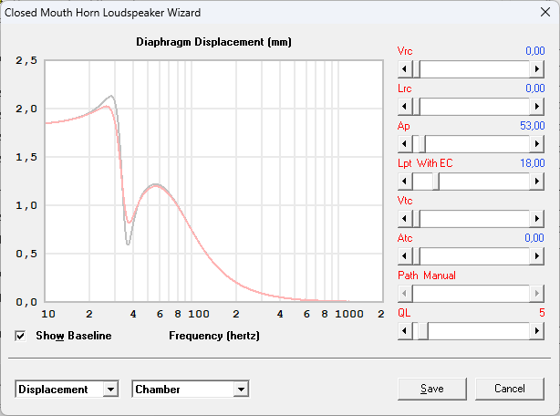

.... and cone displacement simulation:
This is the impedance measurement taken at 0.5 V rms and with 8 Ohm series resistance.
without cloth, with one sheet and (for confirmation of its effect) two and four sheets of speaker grille cloth:
The cloth appears to reduce the lower impedance peak by 2 ohms at 0.5V.
When driving the speaker at Fb and slightly higher levels (4 V in my case) the cloth is moving quite a lot and starts to slap against the baffle.
What is the impedance change at 4V?
This happened because I simply wrapped the cloth around the speaker. Anyhow, the cloth moves A LOT with the air of the port. The cloth did not create any audible hiss/noise, as I would have expected. Not at lower levels before the slapping noise was predominant, at least. At higher levels the air flow is affected and I would generally not advise to use grille cloth near the opening of a port - let alone inside the port!
Looks more like 3 ohm difference than 2 ohms.
Or perhaps 1.33dB if the impedance change were equal.
I wonder if a flat alignment (equal impedance peaks either side of Fb) would exhibit the same "Q" damping.
Correct, I was sloppy with my simulated replication!
The woofer used is only marginally suited for a bass reflex tuning, with its high Qts (but works well as 5th order system, see green response graph).
Usually the reflex port output of vented speakers with a lower Qts driver is lower than the total output, so a reduced port output would not influence total output that much.
