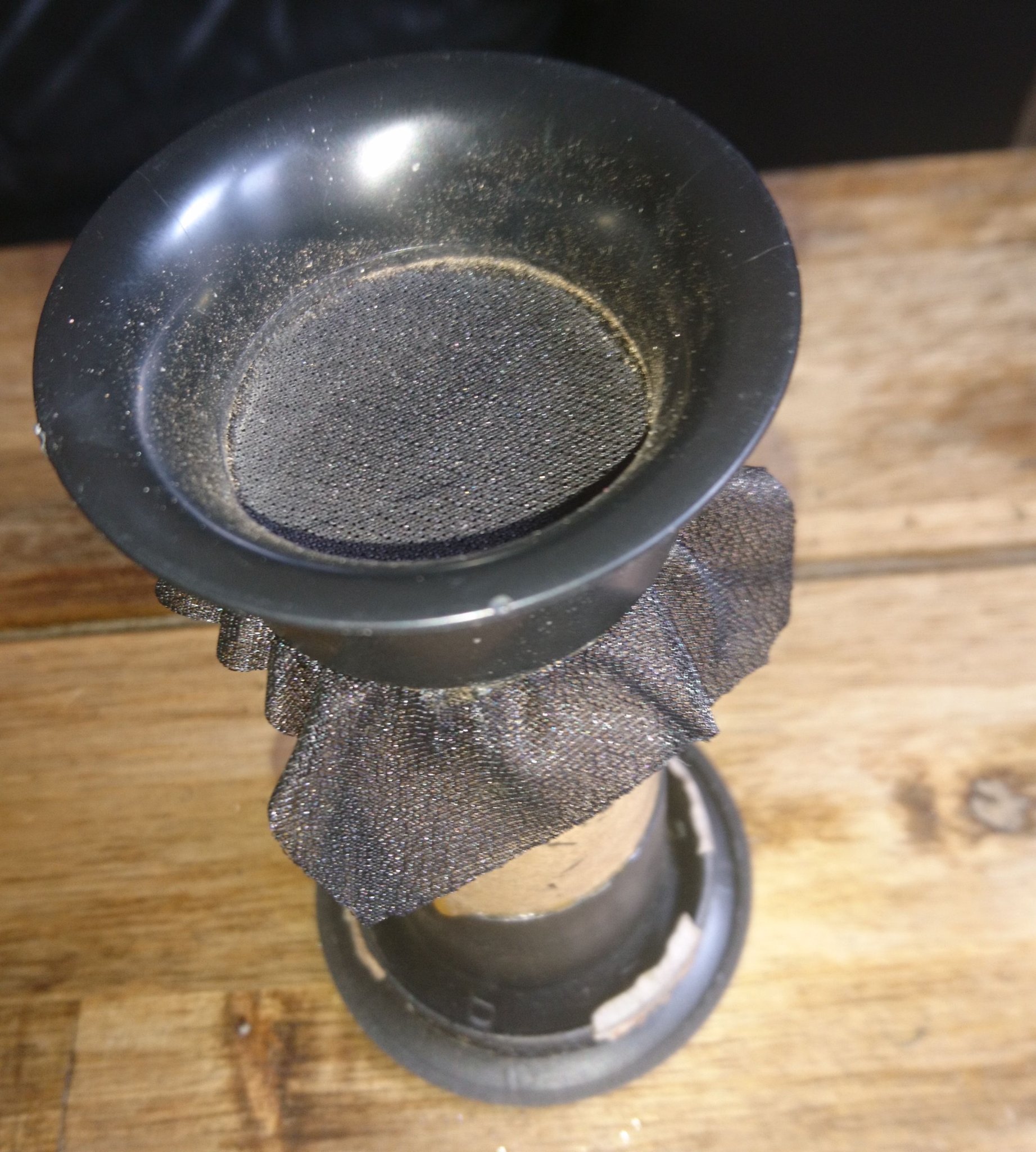

I have a ported sub which lives outside. The rear-facing port would seem to be an open invitation for mice, wasps, or small birds to set up home inside the cabinet. I plan to cover the inside aperture of the vent with speaker grill cloth but it stands to reason this will have some affect on airflow.
Ports are not supposed to flow air, the slug of air in the port should wiggle back and forth.
Most speaker ports are covered with grill cloth.
Grill cloth won't have any more affect on port tuning or output on the inside of the port than outside.
This will definitely lower the tuning frequency.
That material looks quite breathable, based on what I've measured, it won't lower the tuning frequency at all.

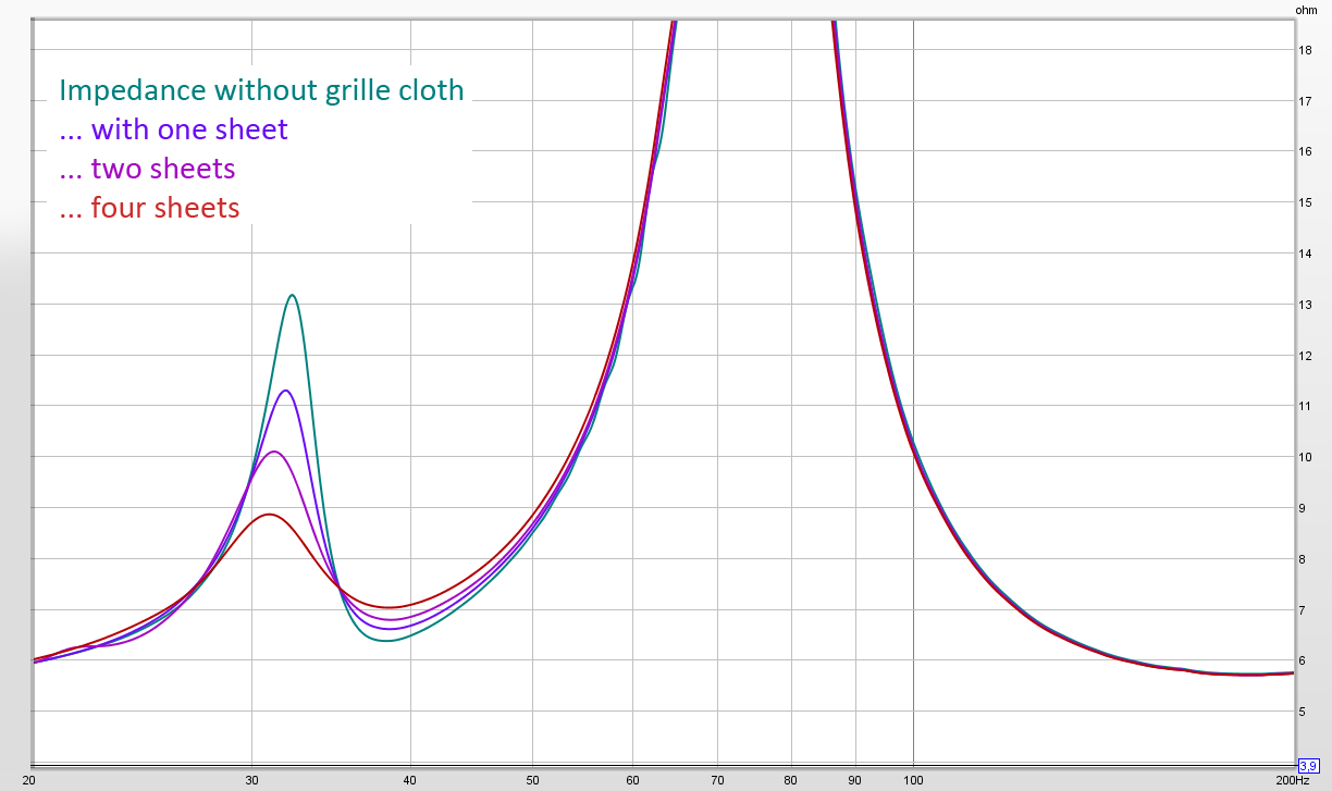

This is the impedance measurement taken at 0.5 V rms and with 8 Ohm series resistance.
without cloth, with one sheet and (for confirmation of its effect) two and four sheets of speaker grille cloth:
cloth mainly influences the resonator Q, as I mentioned:
I'll add that the Q of the resonator will be lower with the cloth.
The resonance frequency does indeed only change very slightly:
I'll bet [...] Fb [...] changes if acoustically transparent grill cloth is used will be difficult to see in a measurement

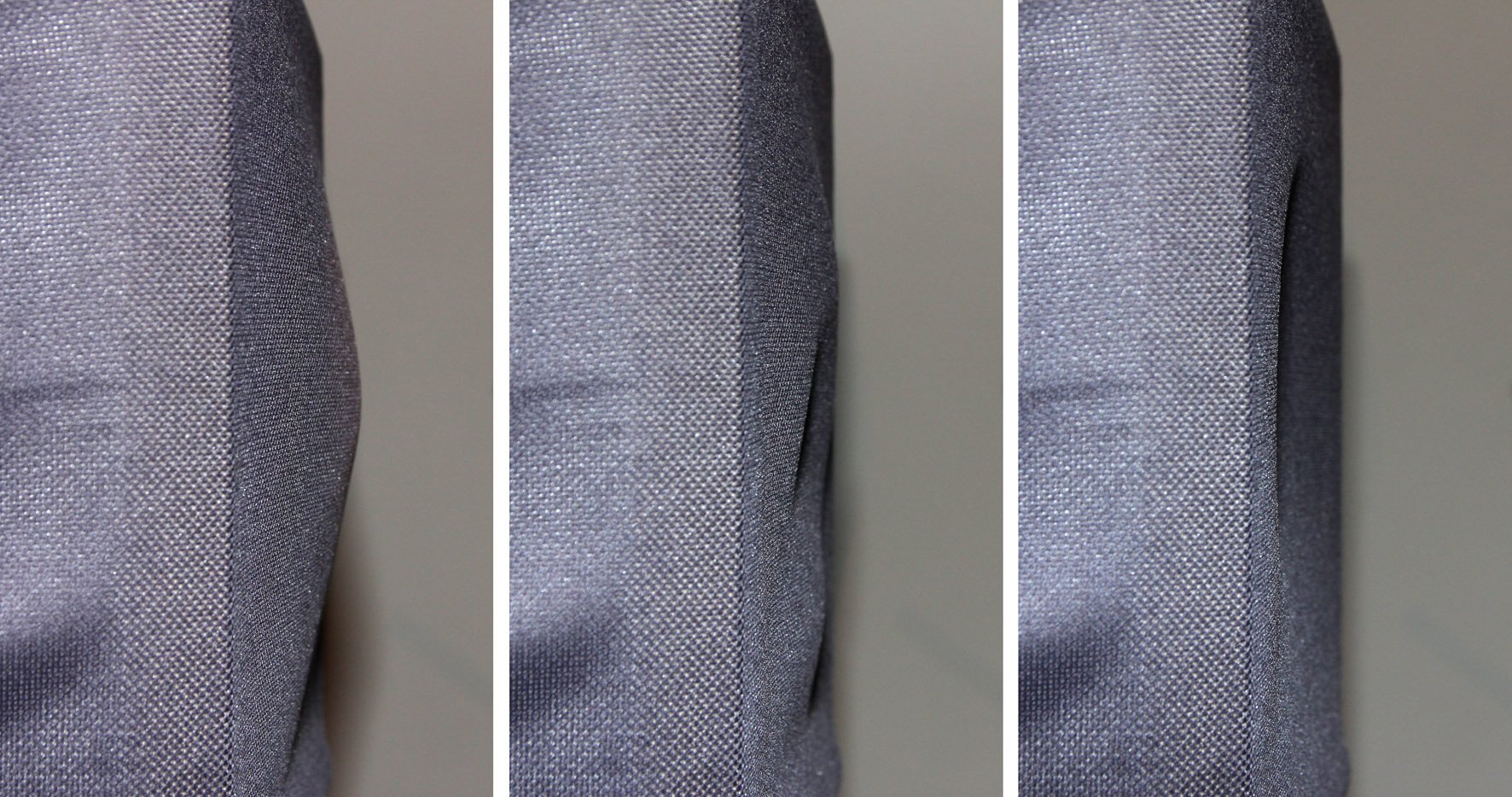

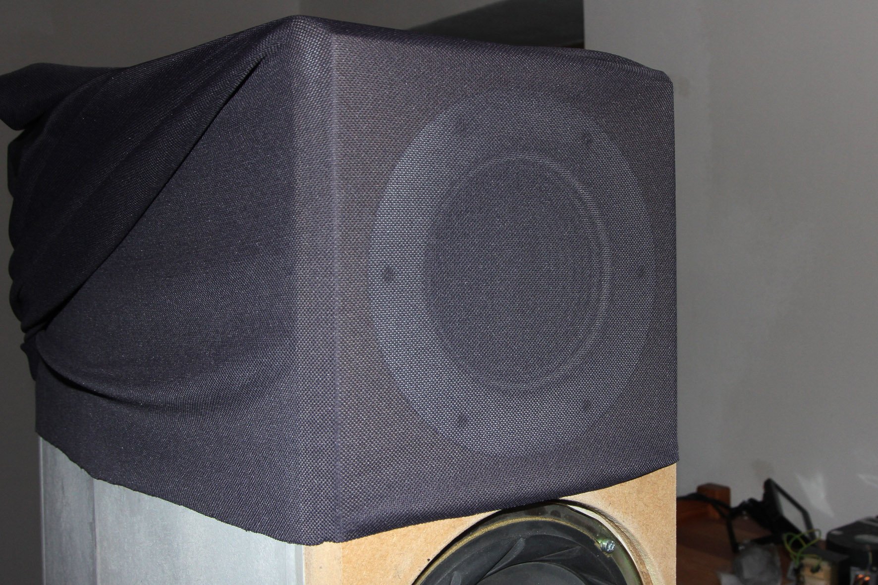

When driving the speaker at Fb and slightly higher levels (4 V in my case) the cloth is moving quite a lot and starts to slap against the baffle.
This happened because I simply wrapped the cloth around the speaker.
Anyhow, the cloth moves A LOT with the air of the port.
Photos of moving cloth at 4 V rms, again taken with flash:
The movement could be reduced by stretching the cloth, but that would probably affect air particle movement even stronger.
The cloth did not create any audible hiss/noise, as I would have expected. Not at lower levels before the slapping noise was predominant, at least.
Hornresp simulation (with a constant port diameter equal port opening of my speaker and corresponding increase of length for correct tuning) resulted in a strouhal number of ~4,3.
that translates into a particle displacement distance of about 4.6 cm (p-p) at 37 Hz and 4 V rms input. Cloth seemed to move just as much.
