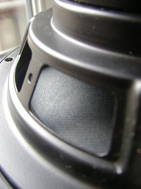

Does someone know this speaker?
AP170Z2 = made up audax number but the Z2 stands for aerogel cone, second unit in that series. In other words they have a Z0 but was replaced with the Z2. The two doesnt stand for duel voicecoil.
Remembering what I have read about aerogel is that it can be finished on th front surface to resemble anything it likes. So audax standard gel units all look the same on the front, a kind of grey/red/brown, but anyone elses may look completely different.
I agree with docjoe that it is an aero cone, I have several little aero drivers lying around the reverse cone looks exactly like the pictures posted here.

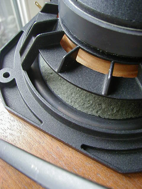

Hi
While working with "Audio-Referece" speakers company I had a lot of speakers to test and we had special versions made to specifications for us by Audax.
the aerogel outer face could be grey, glossy our mate, black, usually glossy, but the back face was always grey, exactly like on the 3rd picture on the first post.
thats why i was so affirmative.
I haven't any experience with aerogel, so i can take more pictures when needed.
