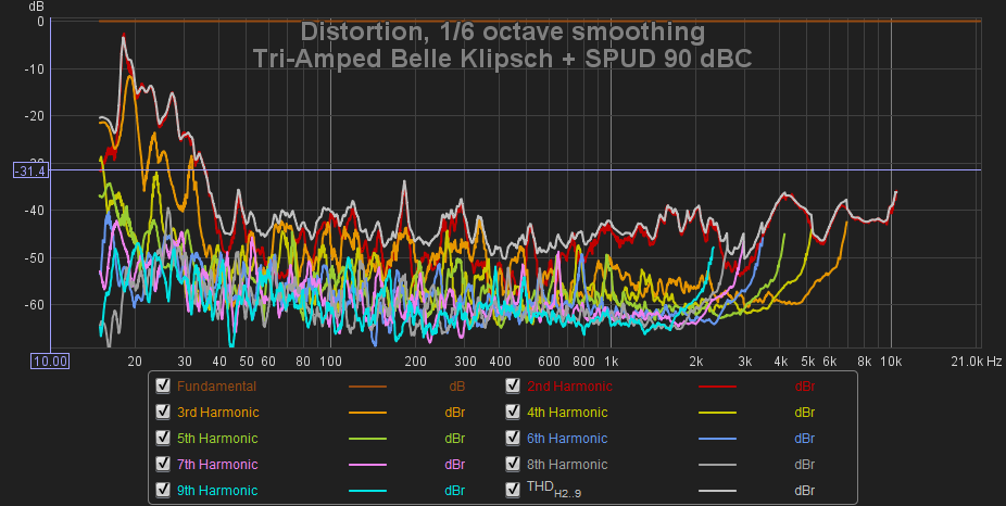

A tri-amped Belle Klipsch with TH-SPUD subs at 90 dBA/1m, showing harmonics 2-9...normalized to fundamental...is shown below.
attachment.php
Loudspeaker harmonic distortion is a pretty strong function of output SPL...and if you don't listen to them at anywhere near concert level, then you'd probably have the opinion that they don't produce higher than 3rd harmonic distortion. They do, however.
A Belle in this configuration (tri-amped) is a pretty clean reproducer at 90 dBA/1m. In fact it's still clean at 105 dBA/1m, although that's typically louder than I listen, except perhaps during big uncompressed music or sound effect transients while in the 5.1 (movie) mode, etc. The input power required to drive one at the 105 dB level: about one watt RMS.

Thanks Cask, just what I was looking for! I'll study it a bit.
