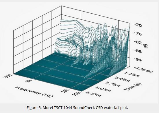

Another source of distortion is reckoned to be high mechanical loss in cones.
Those modern heavy cones with high mass can be very flat on frequency response, but store a lot of energy, ruining clean transients and sounding dull.
This is revealed in the waterfall. Which is not something you often see but shows stored energy. One source of a big delay is steep rolloff from the filter, or just a natural steep rolloff in the driver.
It sounds like a sort of ringing on certain notes. Soft domes aren't my cup of tea. I think we can see problems in the waterfall despite the flat response.
