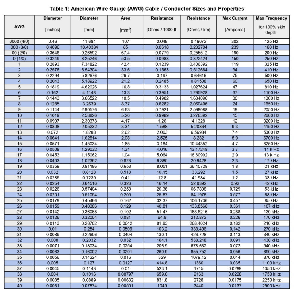

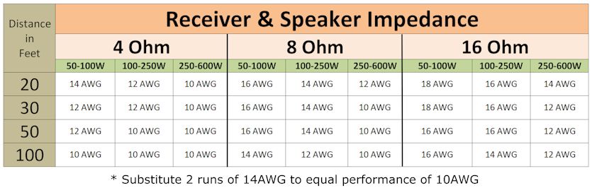

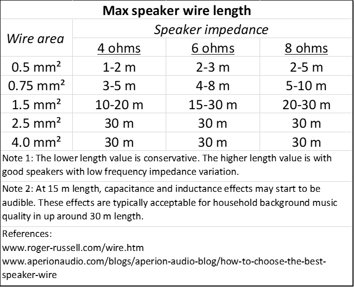

Johnmath
Each one spends their money as they please.
I use clear PVC coated stranded copper wire for just one reason. The thickness Vs. the length.
All the other factors that were analyzed and the conclusion are in the video.
I'm tired of having semolina soup, mom, I promise to be good!
