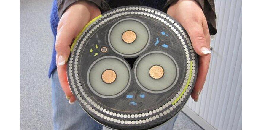

If you spend enough, you can get a perfect cable.
https://twitter.com/pickover/status/1403504838055432195
$400/ft its a bargain in comparison to some high end companies
